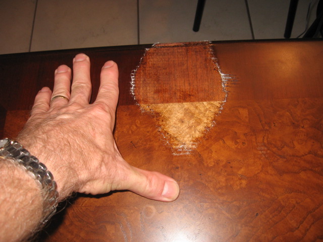

April 11, 20179 yr Popular Post comment_105996 One of today's jobs. About 4 sq.in. in center of table that someone spilled some sort of solvent on. To make matters worse, right in front of a wall of glass. Finish gone, about 90% of color gone with it. Added some color and layer after layer of repeat: {lacquer, dry, lacquer, dry, sand} Edited April 11, 20179 yr by kmealy Report
April 11, 20179 yr comment_106002 Not only the color is correct but getting the sheen correct in that lighting situation. Well done Roly Report
April 12, 20179 yr comment_106022 Well done Houdini!! Customer best not grumble in any fashion over this repair. Report
April 12, 20179 yr comment_106024 nice... were the checks intended or a product of time and the sun??? Report

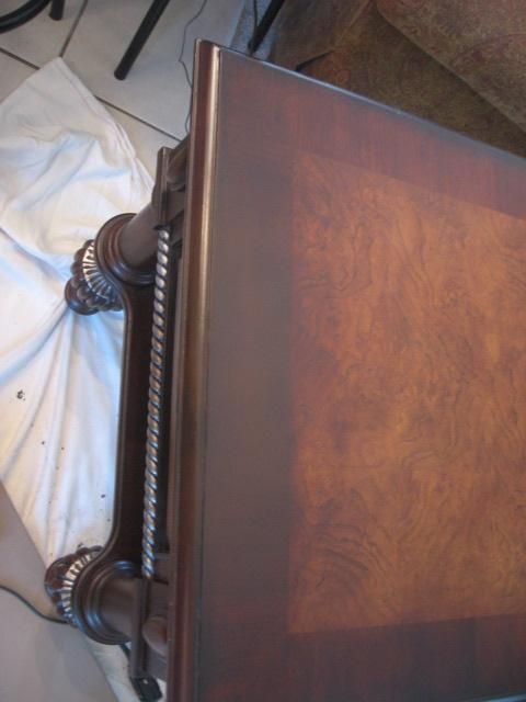

April 12, 20179 yr Author comment_106068 Here's some similar work on a lighter-colored piece. Darker seems to always be easier. Sorry, sometimes I have use flash and sometimes not to get the detail in. This is also an example of selective shading around the edge's veneer. Report

April 12, 20179 yr comment_106077 1 hour ago, kmealy said: Here's some similar work on a lighter-colored piece. WHEW!!! Report
