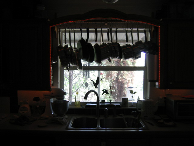

April 28, 20179 yr comment_107695 I wanted to post this picture after you decided on what you will use so I won't change your mind in the middle of the stream. I found some really flexible rope lights so the area under all the cabinets are lit the same, kinda. And to connect one side of the sink cabinets to the other side I built this over head thingy so I could continue the string of the rope lights. I did find out the led rope light are cool all the time but give out a blueish light and don't light the area as much as the regular ropes. The lights over the sink are in a slot 5/8" wide and 1" deep recessed. I 'm the one who always wants to be different. Show us some pictures of your progress.. Report
April 28, 20179 yr comment_107701 That's nifty, Patch. Recessing them is a cool idea. Bet it was a PITA to do. Or did you cut the groove before the cabinet install? Report
April 28, 20179 yr comment_107717 The cabinets were already there. I built a horseshoe looking recessed track that went all the way down the side of the cabinets. The cross piece is glued to the up right pieces. The cabinets are oak and what I built is ash which is , to me, the best wood if a person needs to match any finish on other types of colored wood. Looking from most angles the bulbs are hidden. Never knew if they would provide enough light for I had never seen some to go by but yes she is happy and says it is the right amount!! Edited April 28, 20179 yr by Smallpatch Report
