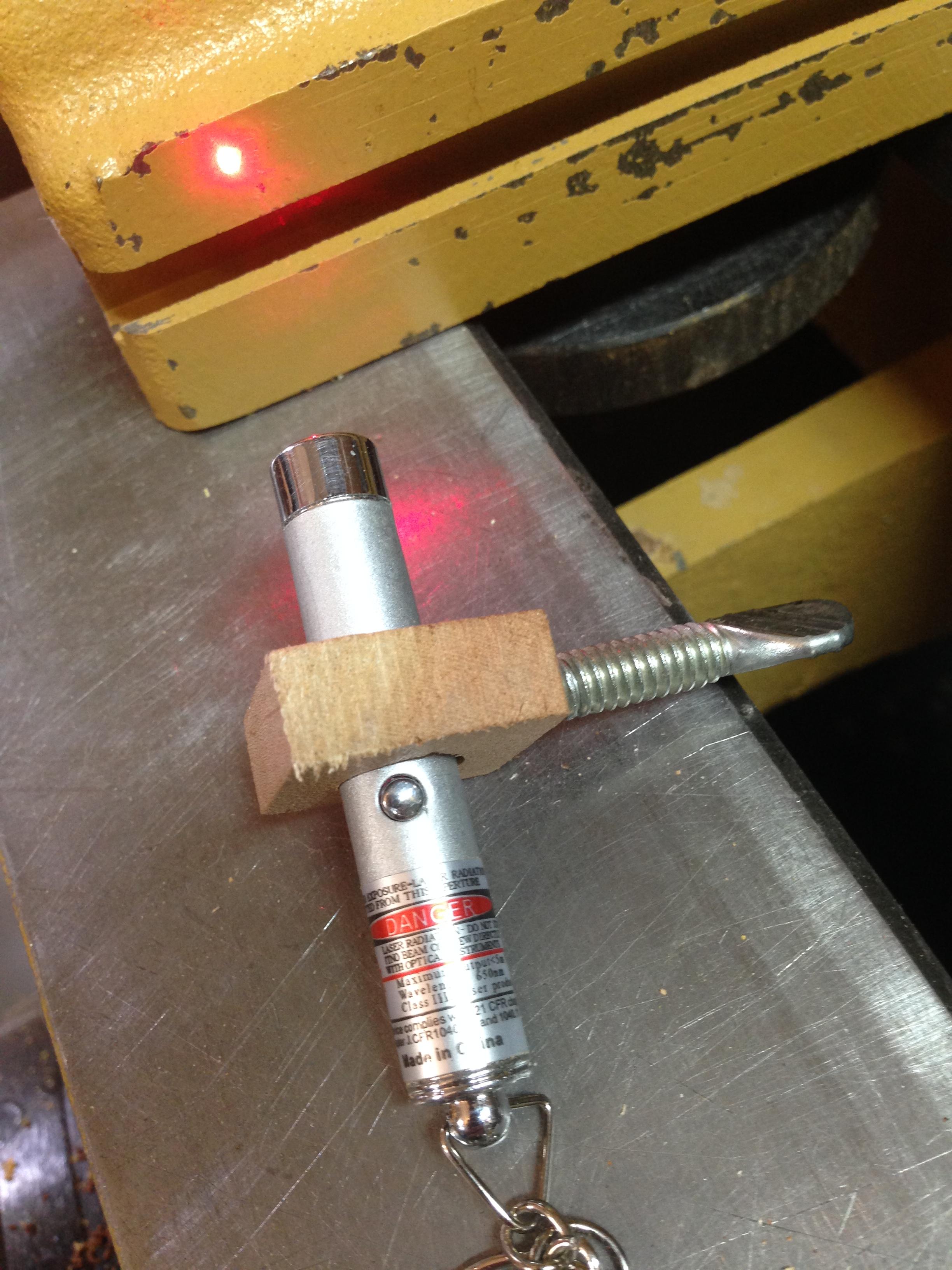

March 30, 20179 yr comment_104375 The laser on my Ron Brown rig has stopped working bright enough to see. Looking for a replacement pen (about 0.4 inch) or a good laser diode. I looked on Amazon and found lots of diodes which I now have narrowed to 3 possible. 1.Question is what do you have? 2.Where can I get it? 3.Would you recommend it? Report
March 30, 20179 yr Author comment_104378 Lew did it have an on/off switch or just a on push button (have to hold on).? Report
March 30, 20179 yr comment_104380 51 minutes ago, Gerald said: Lew did it have an on/off switch or just a on push button (have to hold on).? It was a push button/hold on. I tore it all apart to see if it could be used for turning applications but haven't had a chance to modify it with a switch and external power source. I suppose a clip could be fashioned to hold the power button in the on position during use. Report
March 30, 20179 yr comment_104381 The laser pointer that comes with the McNaughton is one that needs the button held on. They ship an elastic band to hold the button in. Seemed kind of a cheap way to do it but it seems to work ok. One of guys in my club ordered a bunch of these and the guys that have them seem to think they work just fine. red dot laser They also sell this little mount which looks like it could be pretty handy. laser module holder Steve Report
March 30, 20179 yr comment_104382 The one I bought from Walmart was around $5. I think it was advertized as a "Pet Chaser". It use3 3 small batteries. I figured I could use a 5v dc power source from an old electronics piece and hard wire it into the circuit. If I did that, I could eliminate the power switch and just unplug it when not needed. Report
March 30, 20179 yr Author comment_104384 I have a push button laser from Dollar Tree and will try the rubberband idea. Steve thanks for the site I ordered one and will try Lew's idea for a power source.....got lots of those power supplies around. Report
March 30, 20179 yr Author comment_104418 Tried the rubber band and too time consuming to twist on. Then had a lightning bolt hit me. Make a collar with thimb screw to lock in position. Report
March 30, 20179 yr comment_104427 1 hour ago, Gerald said: Then had a lightning bolt hit me. Make a collar with thimb screw to lock in position. Simple, yet very innovative fix. Great idea Gerald. Thanks for sharing. Report
