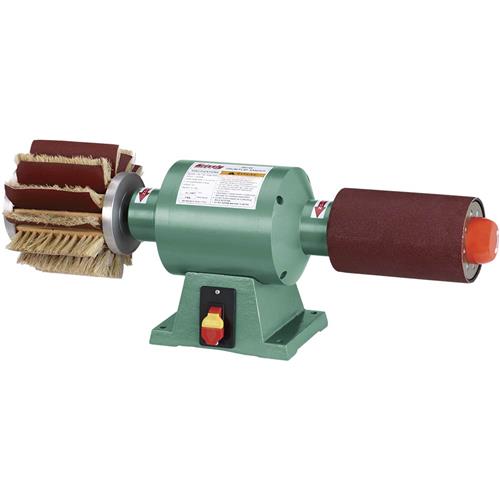

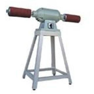

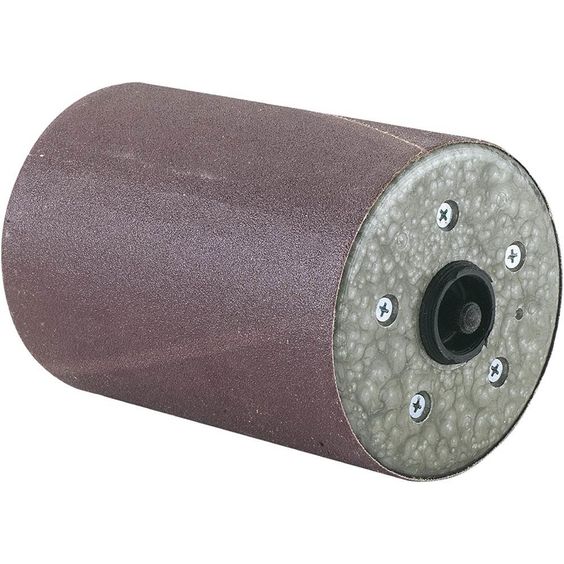

OK folks, here's the deal.  I went to an auction today and stole bought a Ryobi oscillating spindle sander (the Powermatic went way too high).  Anyway, the sander came with a box of sanding tubes, one of the arbors for the Powermatic (boy, is the guy who outbid me gonna be ticked), and this inflatable/expandable arbor.  I can't figure out for sure what piece of equipment you use it on.  It is 6" long (or tall), the plate at the top is 4 1/4" across and it has an air valve at the end to expand it with. The other end has internal threads and they measure .922" or 23.49 MM.  The best I can tell it is about 12 threads to an inch but don't hold me to that.  It has that Grizzly paint look and there a bunch of Grizzly tools at this auction.  So, what is it?
Inflatable drum sander drum.  Screwed right on a motor shaft.
Image result for drum sander
Hmmm, interesting.  This must have been an orphan because there wasn't anything in the auction that it fit.
You can have adapters made and use it on your drill press or lathe.
Interesting.  I wonder who made it?
You're good!  I couldn't run it down.  Thanks.  I was right that it looked like a Grizzly.
It looks like you have an answer
