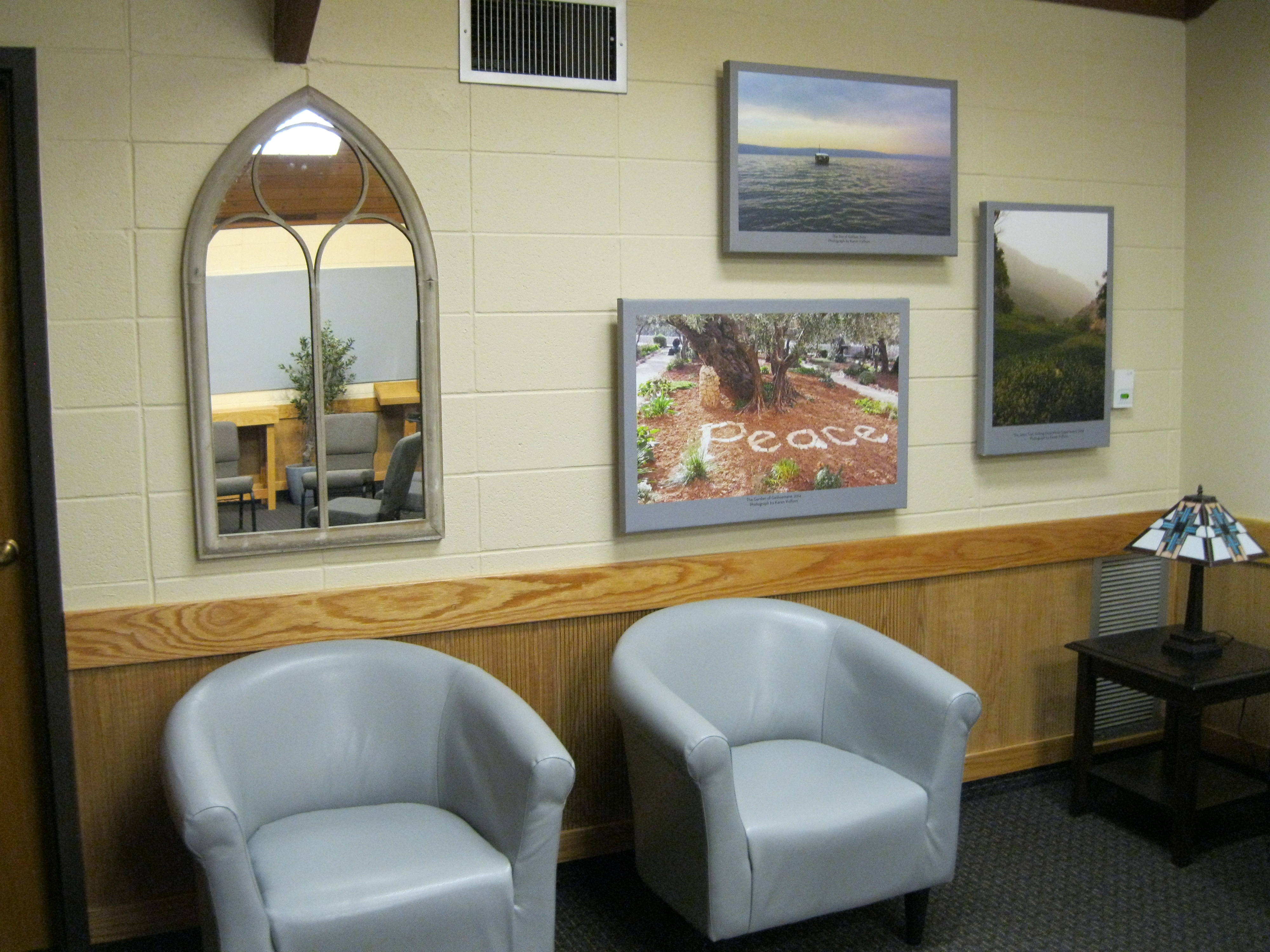

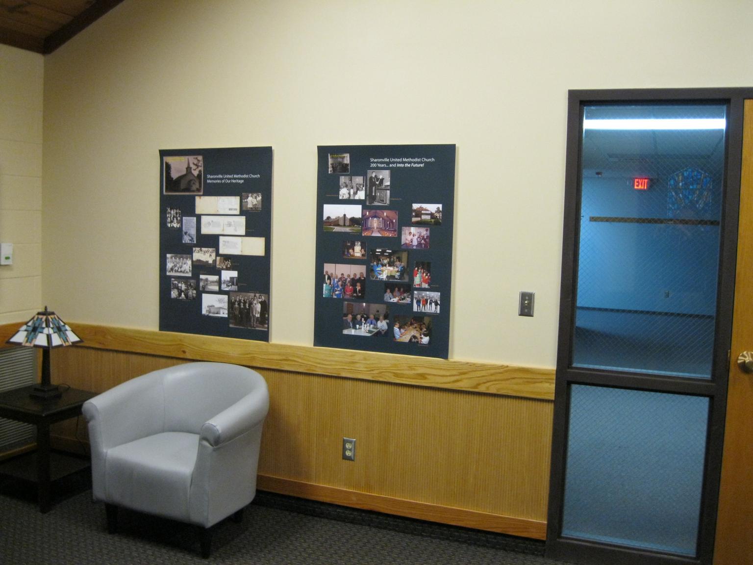

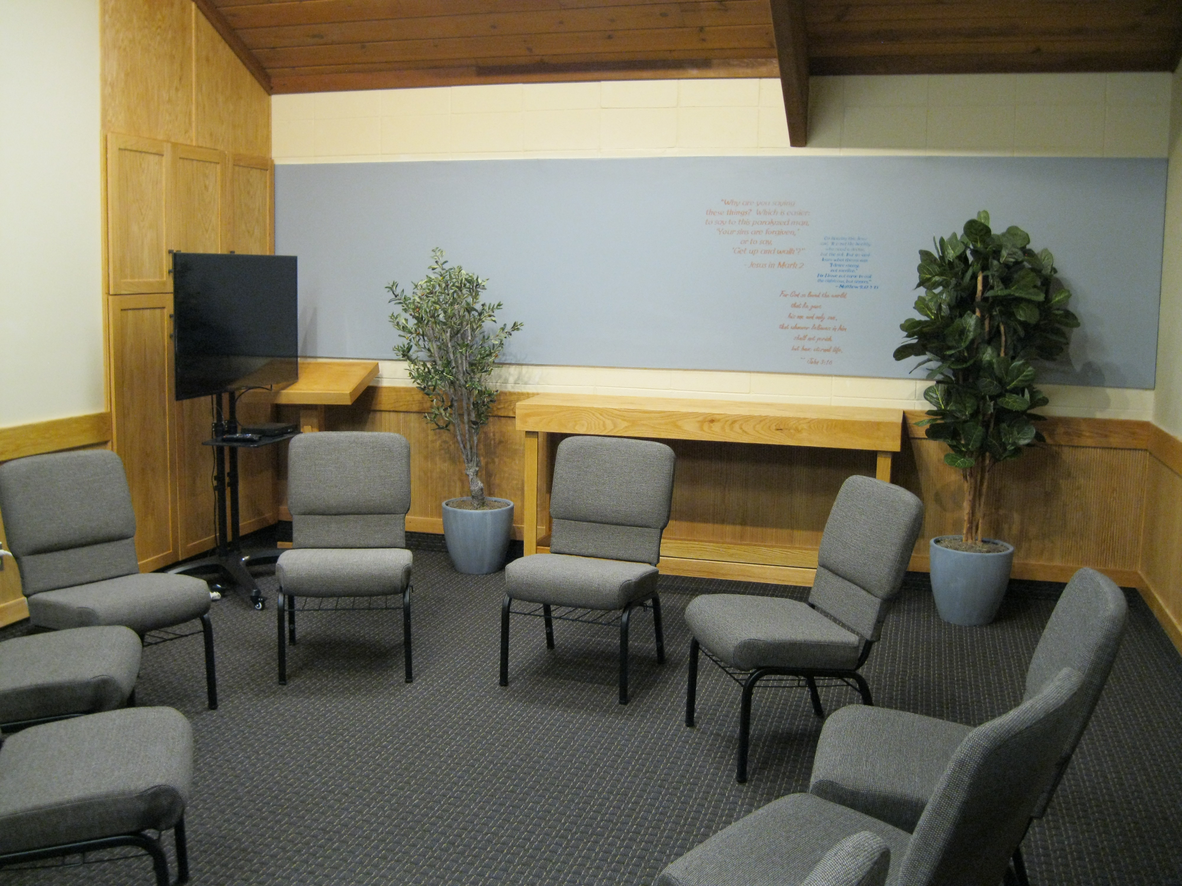

I moved about 20 miles last summer but as a last hurrah, I worked on this project, several years in the planning, at my prior church to convert a rarely used library room to a chapel / quiet room / upper room.
The old room was gutted.  There were three of us woodworkers doing most of the work with a church employee and another couple volunteers filling in on painting, wall papering and electrical work.   All was spec'd out by a church member who is a retired architect who did a lot of churches.
The three of us built the built-in cabinets in the alcove for storage of keyboard, and (probably) other junk.   One other guy and I hung all the chair rail, base rail and wainscot.  He made the altar table and I made the lectern.  I repaired, reupholstered, and touched up the kneeling rail (not shown).   The then the carpet was laid, wallpaper hung, and the ordered furniture and decor came in.   The youth director (a former art teacher) did a lot of the artwork.    Some delays as the architect spends the winter in FL and the youth director got overloaded with work when another employee was let go at the end of the year.
Anyway, I think it's done now and perhaps awaiting official christening.   58c5cc3286ffe_SUMC1.thumb.jpg.a5d7f20656b4acc9b121d0075394dbad.jpg

Yeah, the mirror was new to me.   Originally, that whole wall was supposed to be a mosaic of mirrored squares at different heights and depths.  I like the change really well.   This whole project was a series of scope creep over the two years of planning.
Looks quite nice, like the wainscot, is that veneered panels ? I thought the mirror was a window, until Lew mentioned a mirror and I looked closer..

The wainscot was a special material to match some in the downstairs part of the same building.  It comes in 4x8 sheets and is 1/8" gap then 3/8" MDF veneered strip over and over.   It's on Kraft paper so that the whole thing rolls or folds up into a 1' wide stack.   $200 a sheet <eyes pop> so we were careful when we cut it.  Got some special Franklin adhesive to put it onto the walls.
That is cool, never heard of that, it could be wrapped around radius walls and columns too.

My wife and I were in HD the other day and she found a display with similar product already sized to wrap around a basement pipe column.  I've used a similar product for wainscoting in the past when remodeling a Chinese restaurant - the backing was some type of rubbery plastic, and we put it up with contact cement rolled on both surfaces. We had stained and spray-lacquered the panels before installation, and capped it with a rail with a rabbet on the bottom back edge to hide the ends of the panels.
