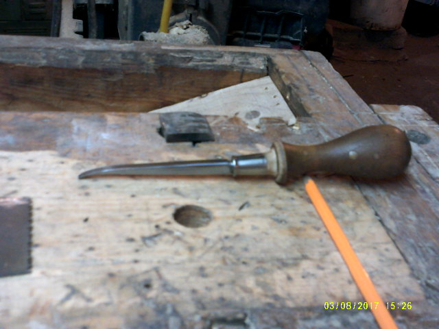

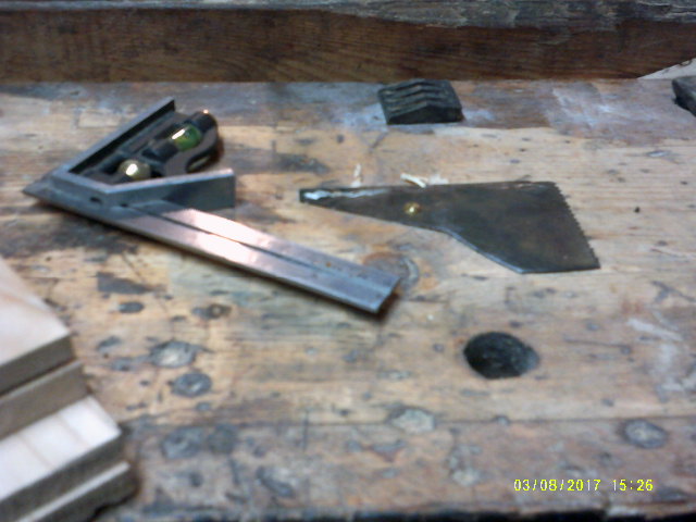

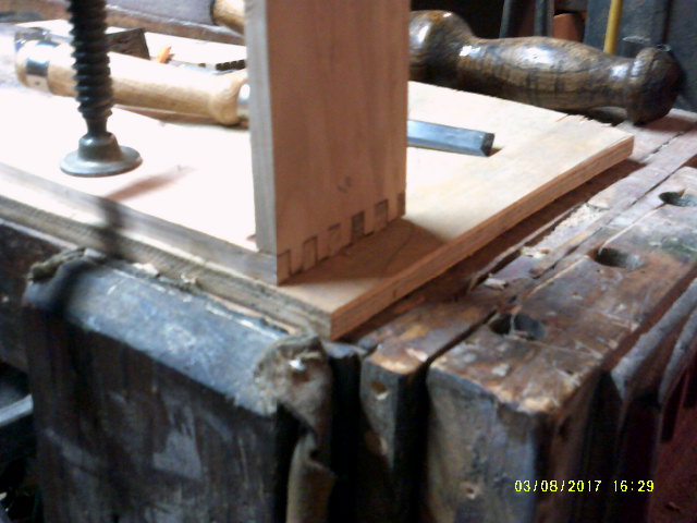

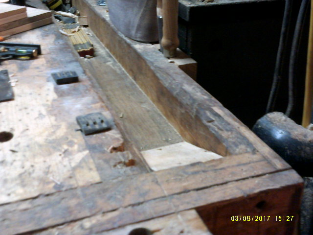

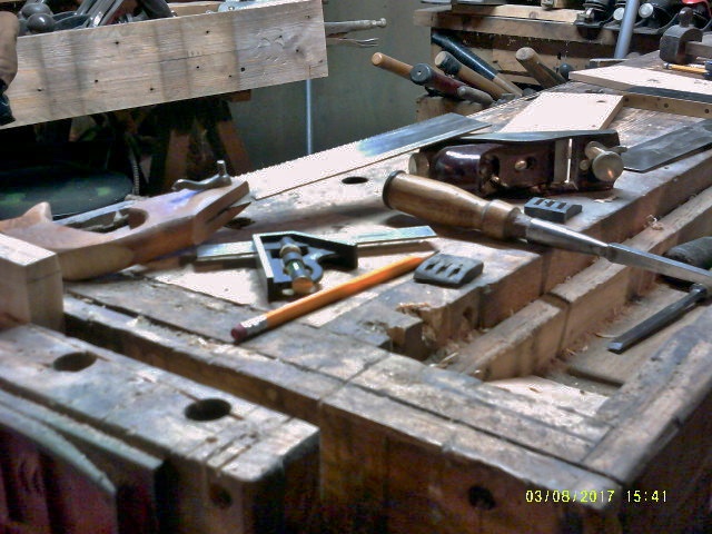

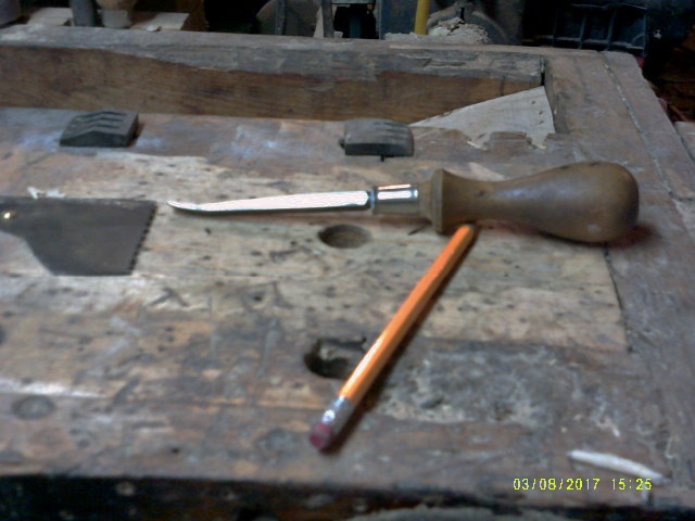

March 8, 20179 yr Popular Post comment_101431 Using a few older tools today. Made a plane stop a while back. Piece of old saw blade and a wood dowel. Dowel then becomes a bench dog That I smack down into a dog hole near the end vise... The saw teeth grip any wood item pressed against it by the end vise. I also cleaned out the tool well......decide to at least make that chore easier to do the next time around.. So, I made a wood ramp. Nailed in place, it will help out as I can sweep out the well right up the ramp. Once the trash hits the floor, Igor's problem, then. been having a bit of trouble, when chopping out mortises.....how to remove the chips down in the bottom? Found an old Drum Brake adjuster, and an old screwdriver handle.. One curved end becomes a "Goose neck chisel" the other curved end becomes a tang. took a while, using a grinder, and a beltsander. Now I can lever those nasty chips out of the mortises. Width was narrowed down to 1/4", as I can get more use out of it. Then, spent the rest of the afternoon..chopping box joints. MIGHT have a project in the works.... It does involve all the "usual suspects".. Along with my favourite toy.. Something I can park my....er..foundation on. Part of the shop remodel was to clean out a trash bag filled corner... I think Shop Cat has been stealing socks......I even swept the floor today, and the steps. Sent the bill to Igor. Been a busy day... Report

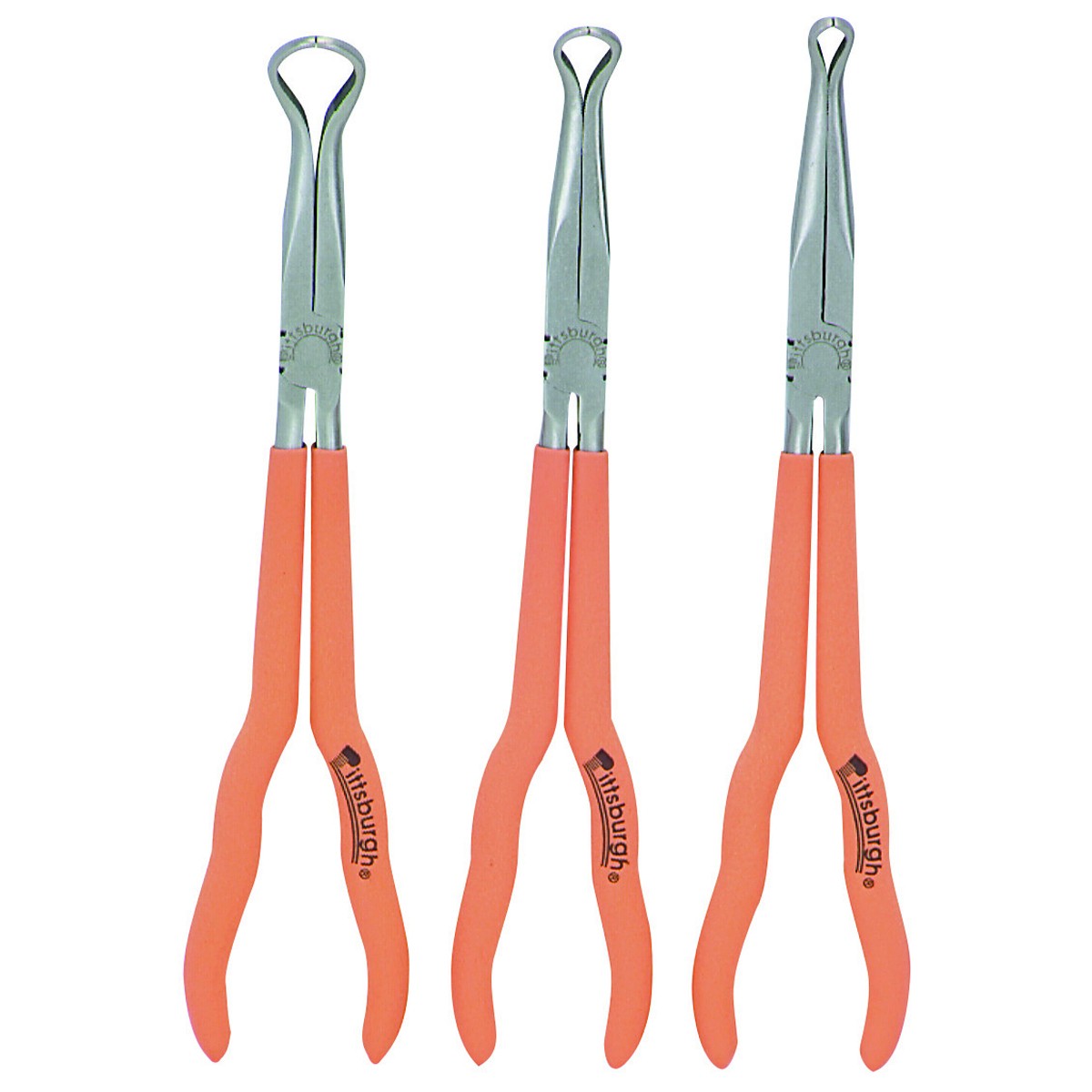

March 9, 20179 yr Author comment_101502 Let alone that funny looking pair of pliers to remove/install the springs and clips.....still have my Dad's old pair. hated when you would remove the drum, and all the parts would fly out..... Report

March 10, 20179 yr Author comment_101564 Last drum brakes I worked on was the rear drum brakes on a Dodge Caravan.......all day job...found the original brake shoes still inside the drum...R. Lee Ermy needed ear plugs, to safegaurd his ears from all the cussing going on... Not sure which brakes the adjuster I used for the chisel was used on.....One end was a flat, the other was a curved point thingy. Almost 3/8" wide on the flat end...yard sale find, maybe a quarter.... Report

May 15, 20179 yr comment_109559 On 3/9/2017 at 10:45 AM, steven newman said: Let alone that funny looking pair of pliers to remove/install the springs and clips.....still have my Dad's old pair. I finally gave mine away a few years ago. Now I could have used them to attach sinuous springs on sofas. Never occurred to me at the time. Report

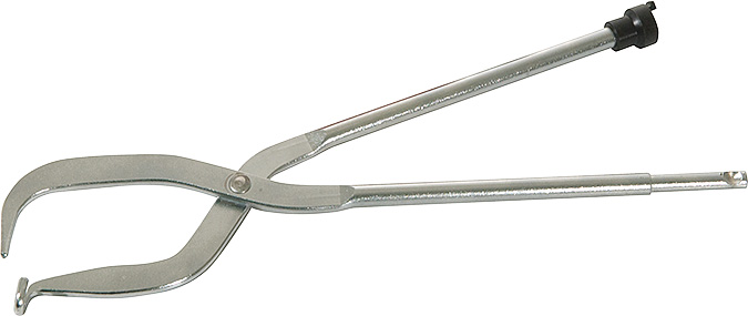

May 15, 20179 yr comment_109569 24 minutes ago, kmealy said: I finally gave mine away a few years ago. Now I could have used them to attach sinuous springs on sofas. Never occurred to me at the time. Are you talking about those pliers that work backwards, with the little bent tips? I have a pair in a drawer. They're not used often but, they are invaluable when they're needed. Report
May 15, 20179 yr comment_109595 6 hours ago, Gene Howe said: Are you talking about those pliers that work backwards, with the little bent tips? I have a pair in a drawer. They're not used often but, they are invaluable when they're needed. As i remember, mine looked sort of like this. I got them when I took an auto mechanic's class, but I never trusted myself to work of brakes. You don't want them to fail because you did them up wrong. Report
