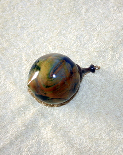

I like Target coatings EM6000 production lacquer. It is an easy finish to apply, flows out beautifully and it's nearly impossible to get a run or sag. I do use it on smaller items and don't know how it would be on a larger piece. They have just introduced a high build formulation, EM7000. It's time to reorder and I may give that a try.
EM6000
Steve
Edited by Steve Krumanaker
add picture
