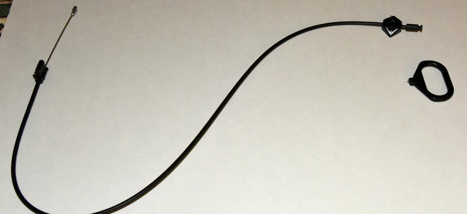

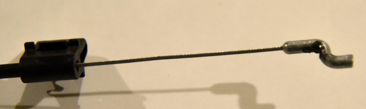

January 28, 20179 yr comment_94896 So I have this reclining loveseat in the man cave basement and one of the cable releases broke; in a way I can't repair it. So I need a replacement and have had zero luck in finding any. Anyone know where I can get one? Little background, this is a double recliner and the release that broke was the right side (where I usually sit). My temporary solution was to move the left side over and that worked (not very well) but I'm wanting to get a new cable so both sides can work again. It's 32" long across the housing, and you can see the damaged end, the business end, and the overall cable in the photos. It does have some not-real-clear markings that look like 0 5(or 6) 9 8 gK23 T. Any ideas? Edited November 20, 20179 yr by Ron Dudelston tags added Report

January 28, 20179 yr comment_94999 I think you can find a replacement at a lwnmower repair shop or a go-cart shop. Take the old one with you for the lengths are different. I would try , drill a hole through the handle thread the cable through, go to ace hardware store and get a cable stop, it slips over the cable and has a set screw to lock it on to the cable. Or with the cable through the hole, tie a knot in the frayed cable and maybe find a washer with a hole just larger than the cable. You can do away with the plastic handle and use a dowel with a hole in the middle. Lots of ways to skin that cat. Edited January 28, 20179 yr by Smallpatch sp Report

January 29, 20179 yr comment_95014 This looks more like it- https://www.amazon.com/Choice-Parts-Recliner-Replacement-Sectional/dp/B006RAWM9E?tag=thesummedress-20 Report
January 29, 20179 yr Author comment_95057 Dang, Lew...looks exactly like it. Funny thing, we buy a ton (literally) of stuff from the 'zon, I didn't even think about looking there! Thanks. Report
January 31, 20179 yr comment_95386 I inventory these and can send you one, if you still need it. The critical part is the distance on the bottom end between the clip and the hook. Known as "long" and "short" -- I'll check my distance and see if it matches yours. Known as a "parachute pull cable release." They break all the time, which is why I inventory them. La-z-boy has a much different system, at least the ones I've worked on. Report
