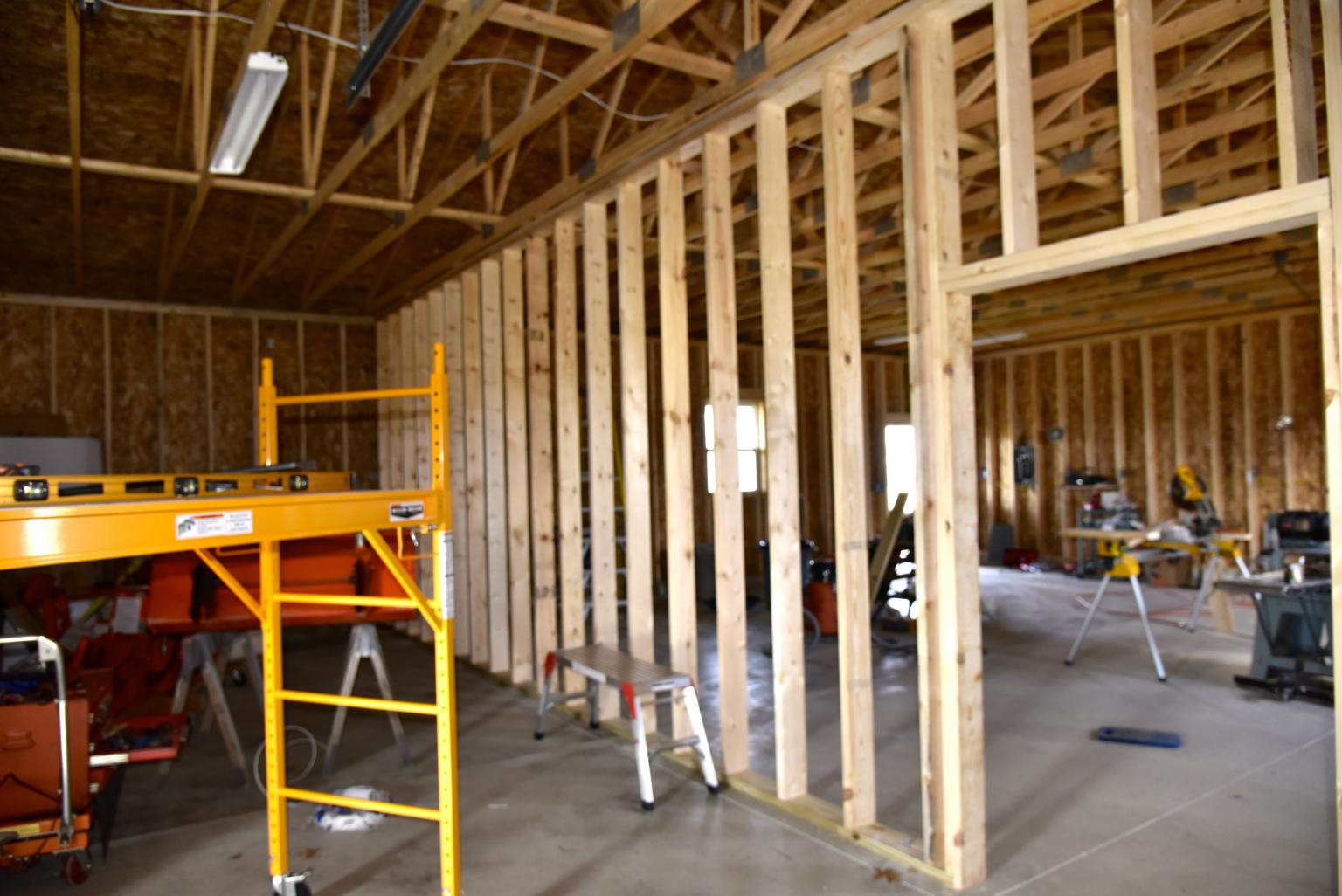

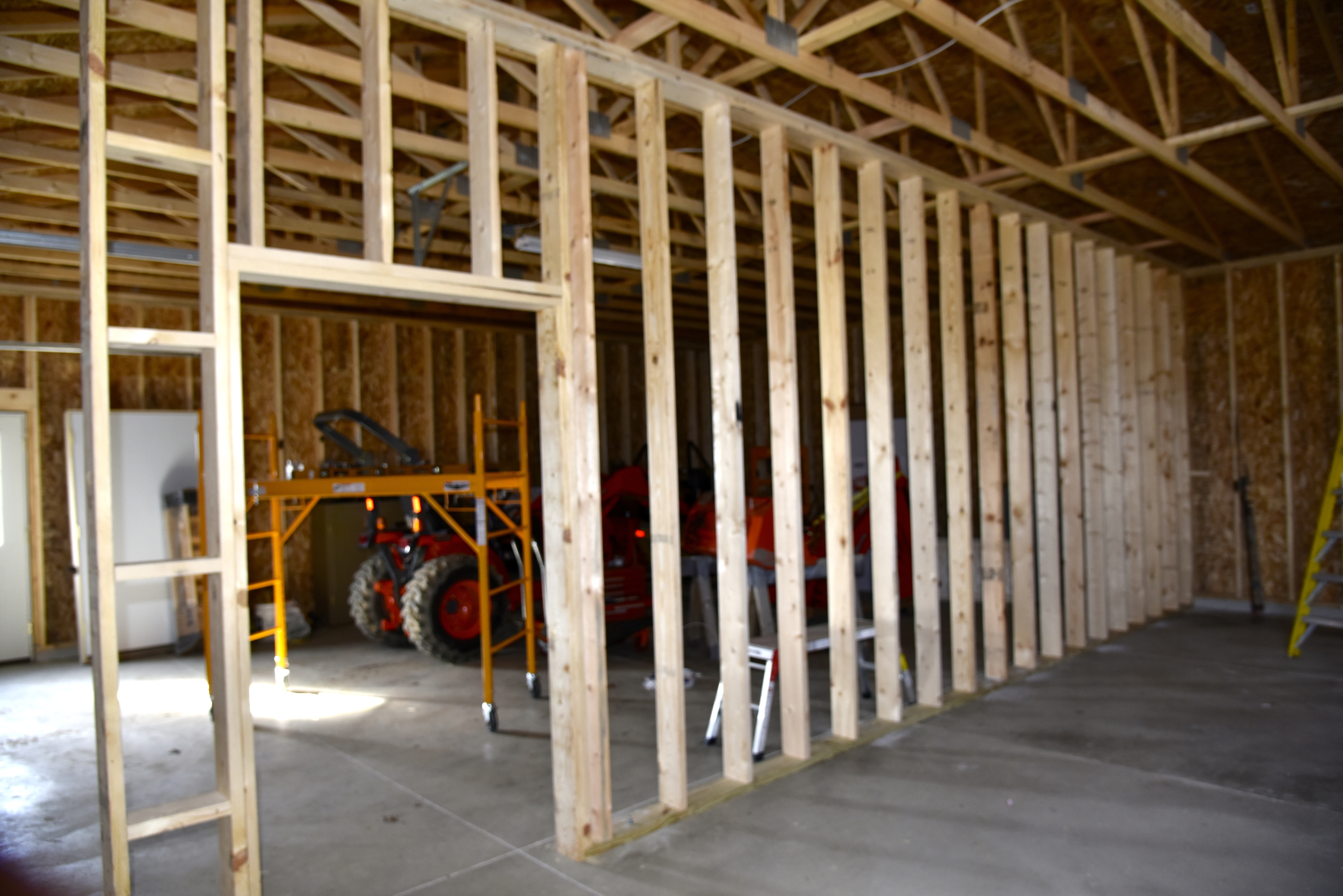

January 23, 20179 yr Popular Post comment_94135 but I thought I'd show it anyway. I had asked about getting my partition wall up back in early November. Then life intervened (and Mother Nature with winter) and i didn't get much done after that question. But the days have been unusually warm so I was able to get some things done. the big one being I finished the partition wall. In one of the quirks of fate that seldom (never) happen to me, I had bought some number of 10' 2x6s and 3-10' treated 2x6 (sole plates) to build it. After I was done I had a 2' section of 2x6 lumber left, and a 4' piece of the treated wood. Typically I go back to the store (twice) for more wood. Anyway, here's some pics but remember: I am not a carpenter...nor have I ever claimed to be. There was just me, so I lifted the first third of it up using a deer hoist. But the next piece had to be done as one piece because of the door and the the way the top and sole plates were staggered. I wound up using my tractor with some pallet forks which was only slightly tricky, but still worked. That wall had to be up for me to continue on with the wiring. Edited January 23, 20179 yr by Fred W. Hargis, Jr Report

January 24, 20179 yr comment_94220 Looks pretty good from where I sit Fred. I'd say "carpenter" is a fair title. Any specific reason(s) you chose 2x6 vs 2x4 interior wall since non load bearing? Just curious.. Report
January 24, 20179 yr comment_94229 14 minutes ago, Gene Howe said: I'm betting the other side of that 2X6 wall is un heated. Good point, although the outer three to the exterior are 2x4...maybe structural for what he plans to fasten, hang, support on either side??? Report
January 24, 20179 yr Author Popular Post comment_94231 It's all 2x6, and as Gene guessed the storage area will not be heated so I wanted the full insulation value in that wall. Another reason for the 2x6 (as Dave speculated) is that I have 2 possibilities of some really heavy stuff being bolted to that wall....since I haven't laid out the floor plan yet it only possibilities. But I have a set of steel tube lumber rack that were welded up that might wind up on that wall in the storage area, and with lumber I'm sure they exceed 2000#, thought most of that load is on the floor. The other thing (on the shop side) would be the dust collector. It's less (about 350#) but I still like to use really long lag bolts to hold it up. Edited January 24, 20179 yr by Fred W. Hargis, Jr Report
