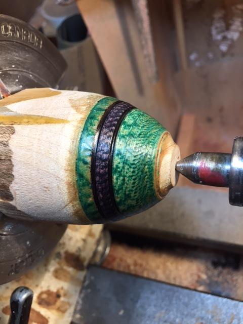

I made one out of a hack saw blade. It didn't work for me. I tried low 450 rpm and high speed 1100 rpm.
i need  harder wood and I think I can make it happen. I will also try one made out of a butter knife. What readily available wood would you say it should work on?
You have to do more testing than just speed.  How deep the blade is in the tool or for long blades, how far the blade hangs over the tool rest matters also.  In other words, size does matter.

It'll probably work on maple.
Stuff I've done on walnut- using the Sorby texturing tool works OK but tends to get "chewed up" a bit. The Sorby spiral tool works better on Maple.
 Thanks guys, going to glue up some maple and try the suggestions.
The length of the blade out of the handle also influences the pattern for a home made tool.
Maybe my choice of a hack saw blade was not a good one. I have a larger blade and will try it also.
If you have one, would you measure the width and how far it sticks out?

Thanks guys, it was mostly technique, but harder wood did help. I can see some fun with this.:)
 Ok, with the videos & the Q&A this makes things a lot clearer. I never knew what a chatter tool was or that it could leave such a consistent pattern.
