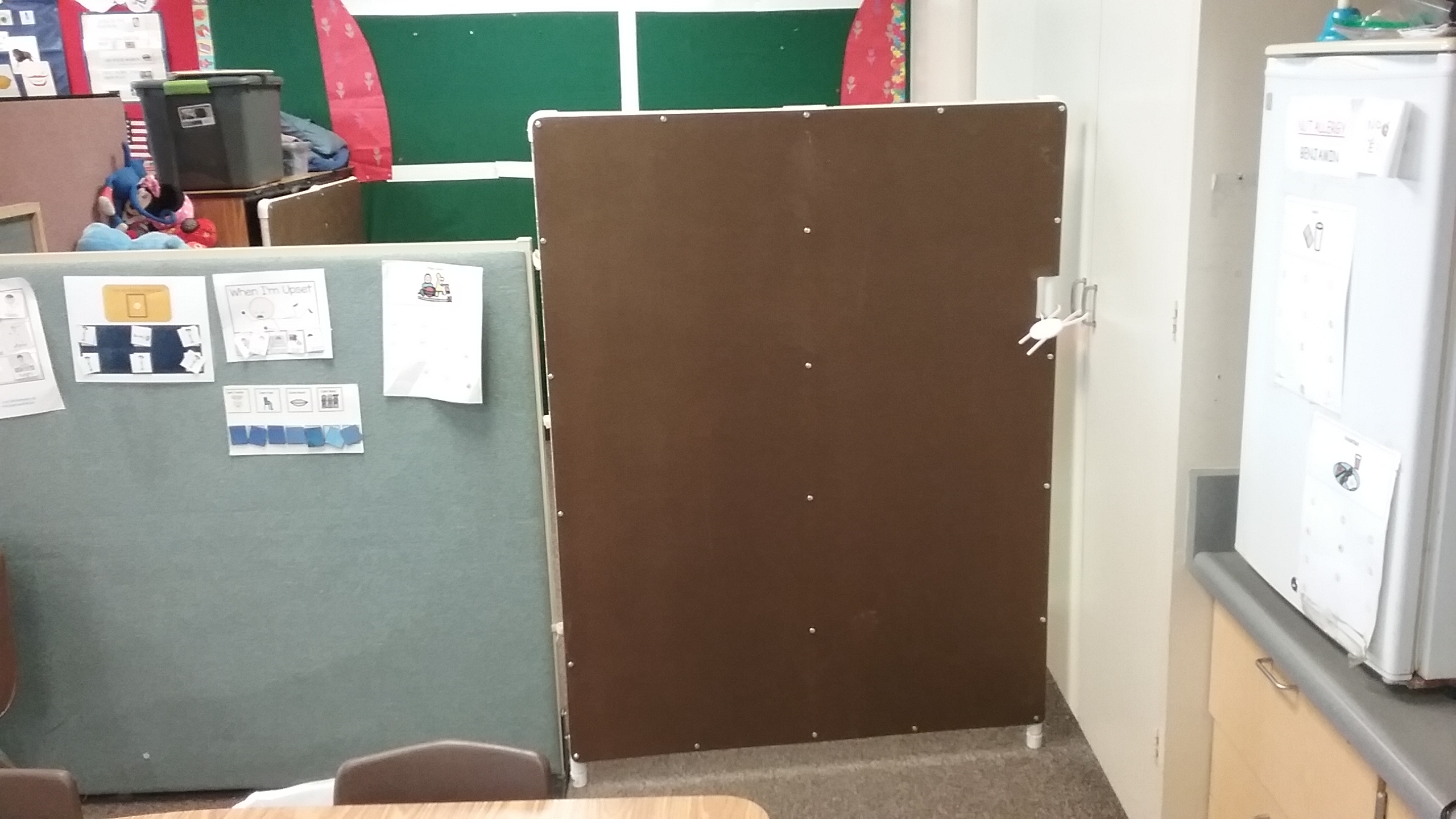

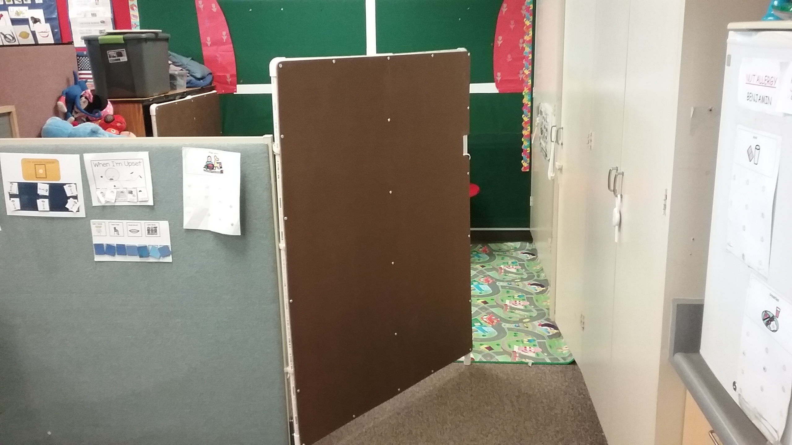

This is the entry into the play area.

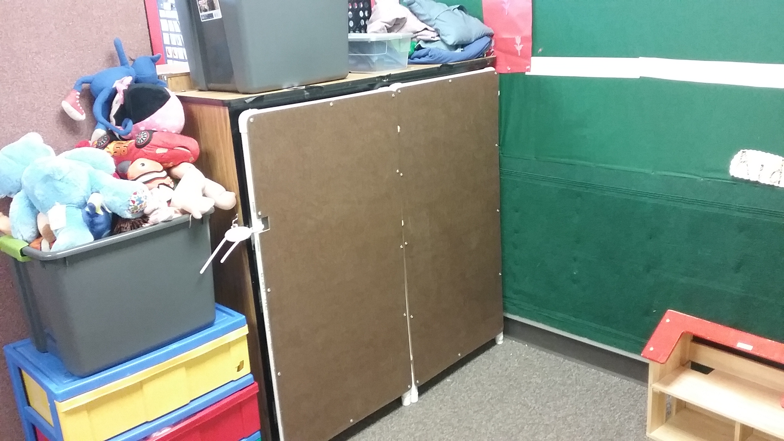

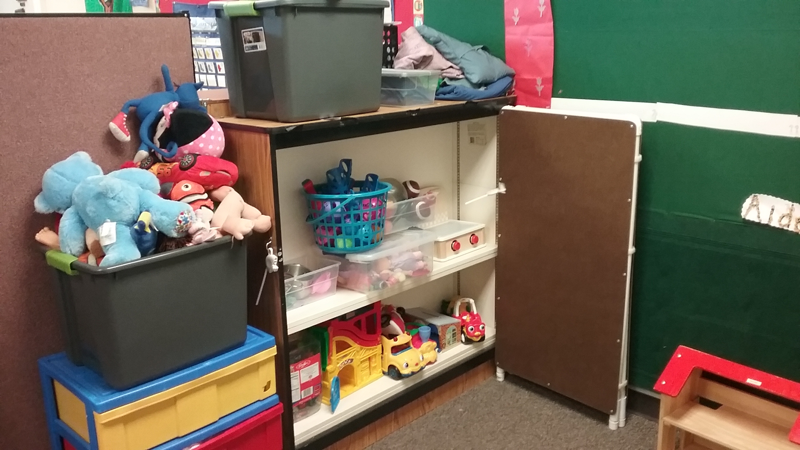

This is the toy cabinet which is lockable so they can't sneak in and take the toys.

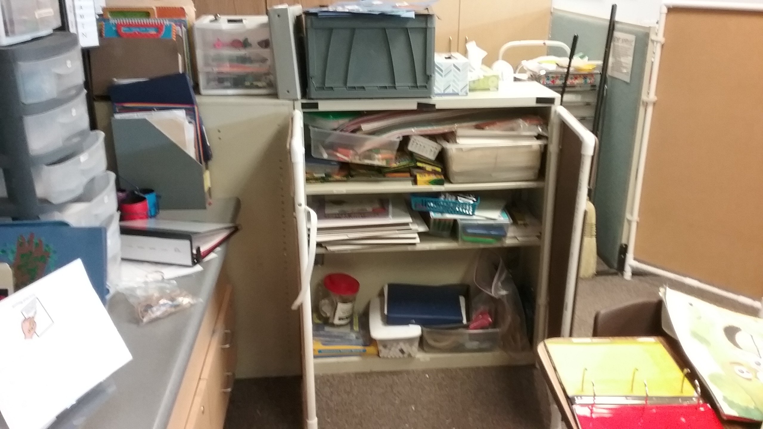

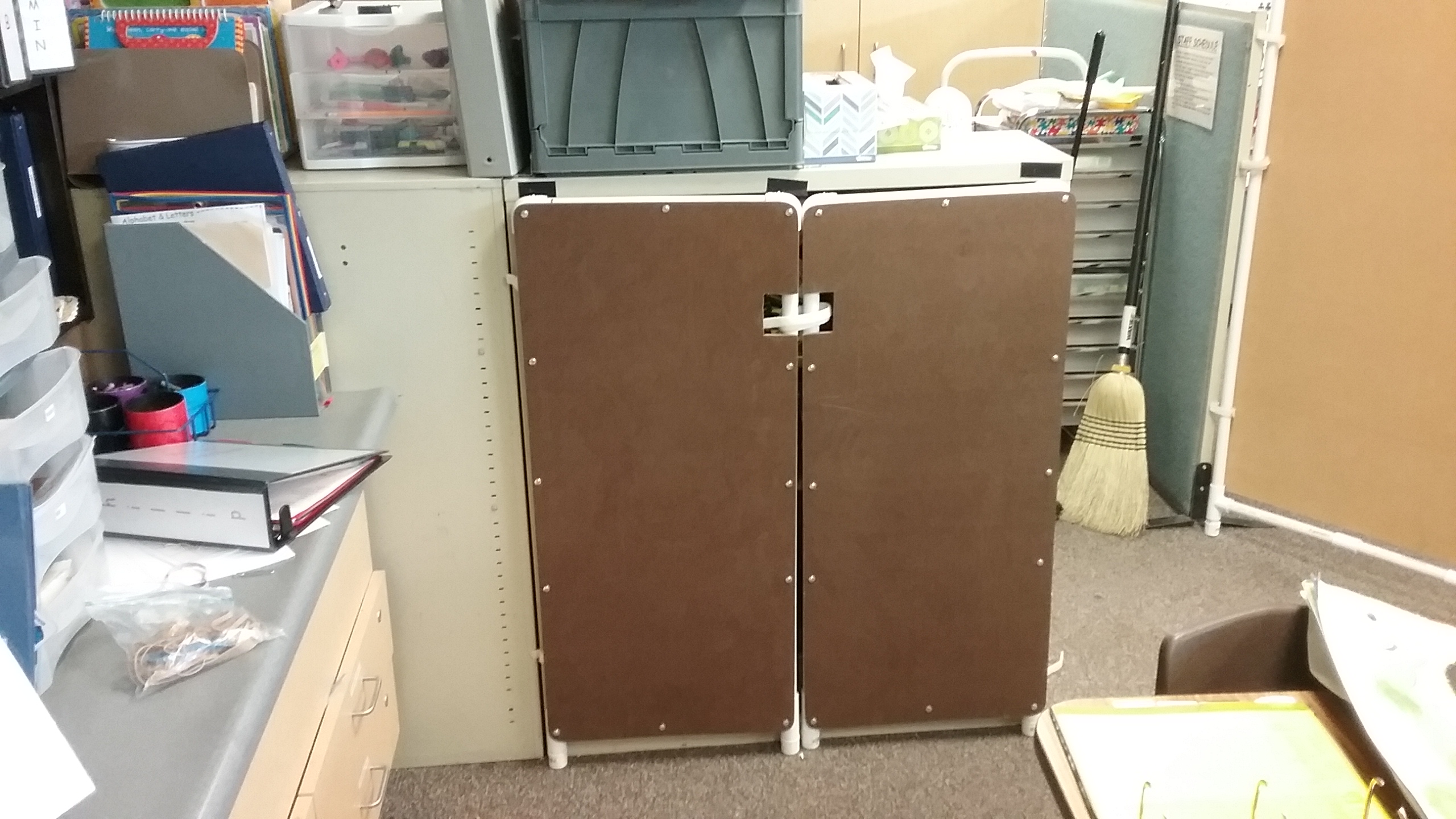

This is the cabinet that has the coloring books, crayons and markers. They always check the kid's backpacks before they leave to go home as they love to take the crayons and markers home.

The locks for the play area entry and toy cabinet are typical cabinet child locks. They have adjustable straps on two sides. The center part has 2 push buttons that have to be pushed simultaneously and it will seperate. To lock it you snap the 2 pieces back together. The other cabinet with the coloring supplies I screwed a long piece of peel & stick velcro with one side hook and the other side loop to the PVC and then wrap it around to keep the 2 doors shut. Not high tech but it works.
