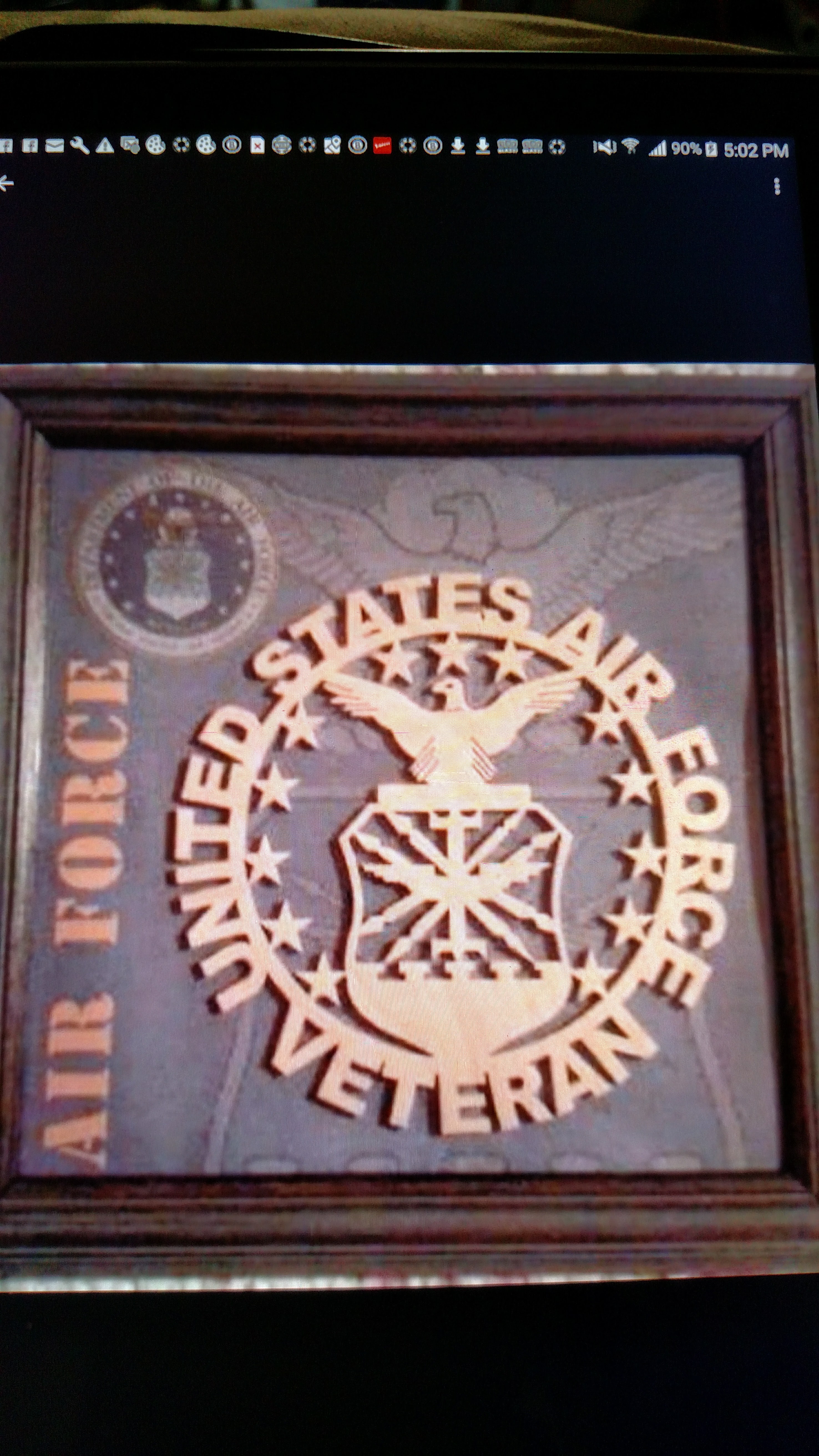

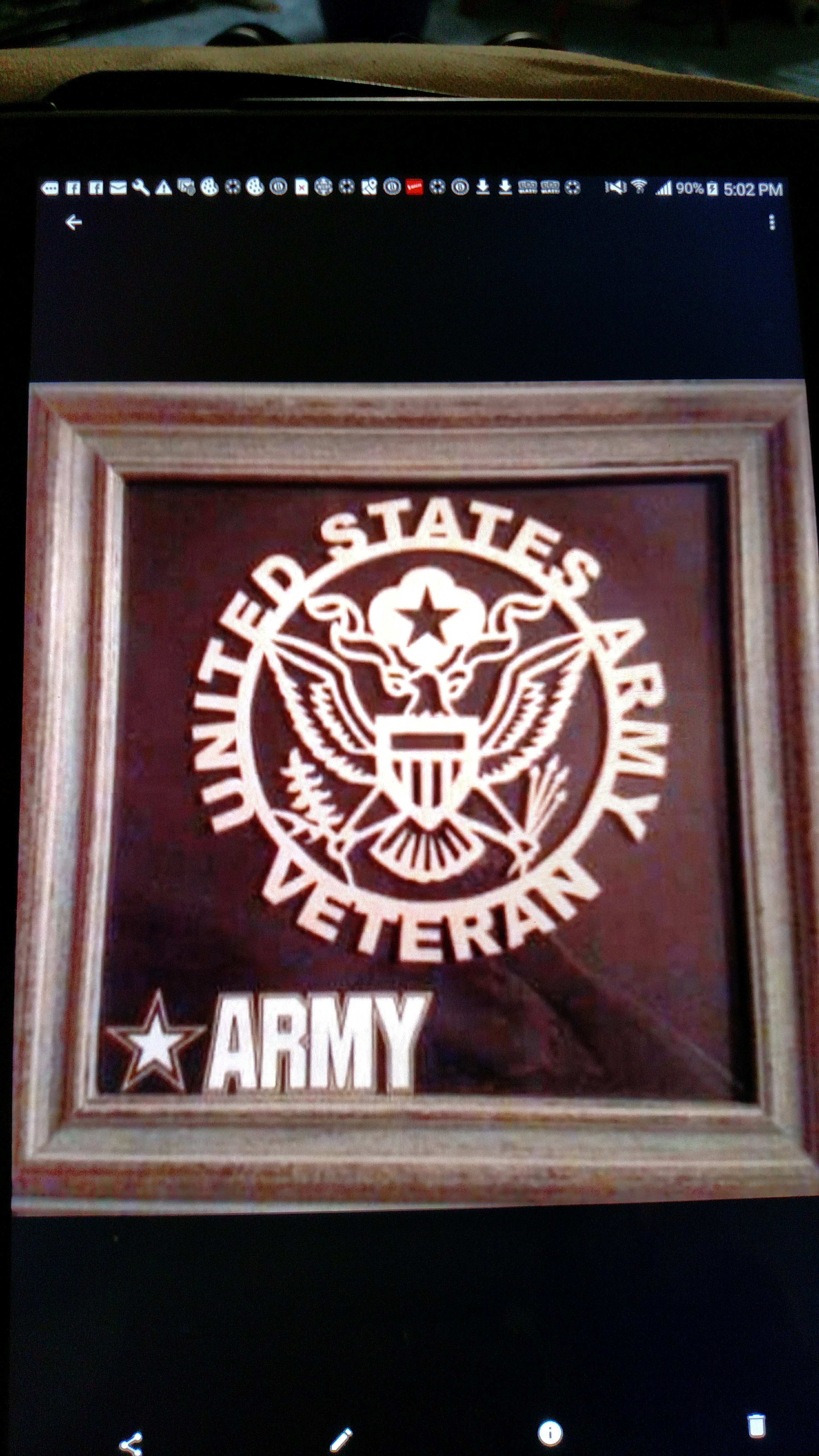

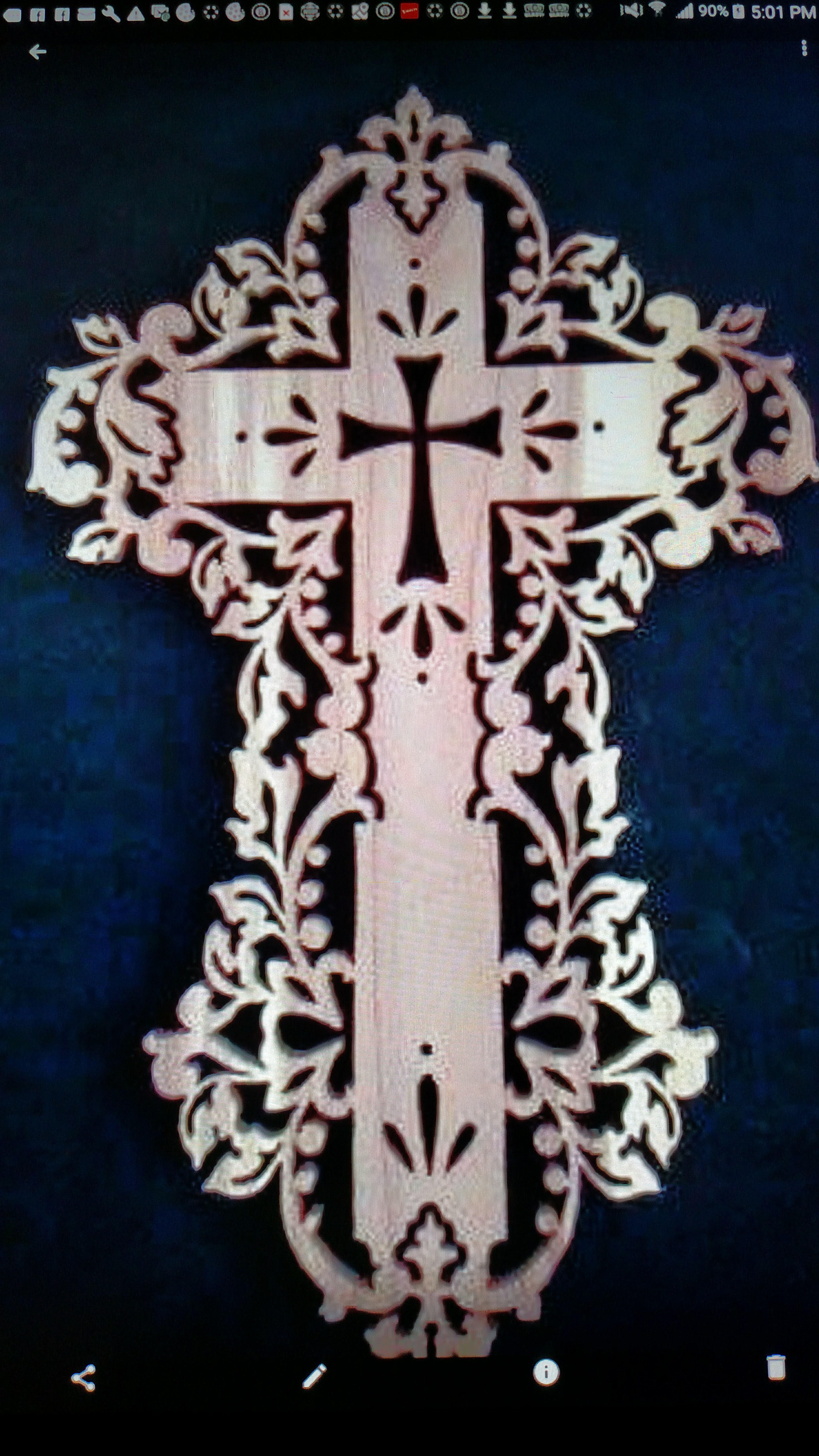

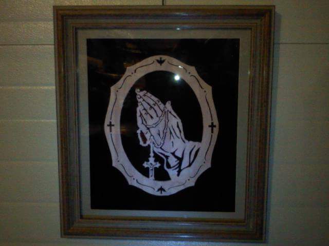

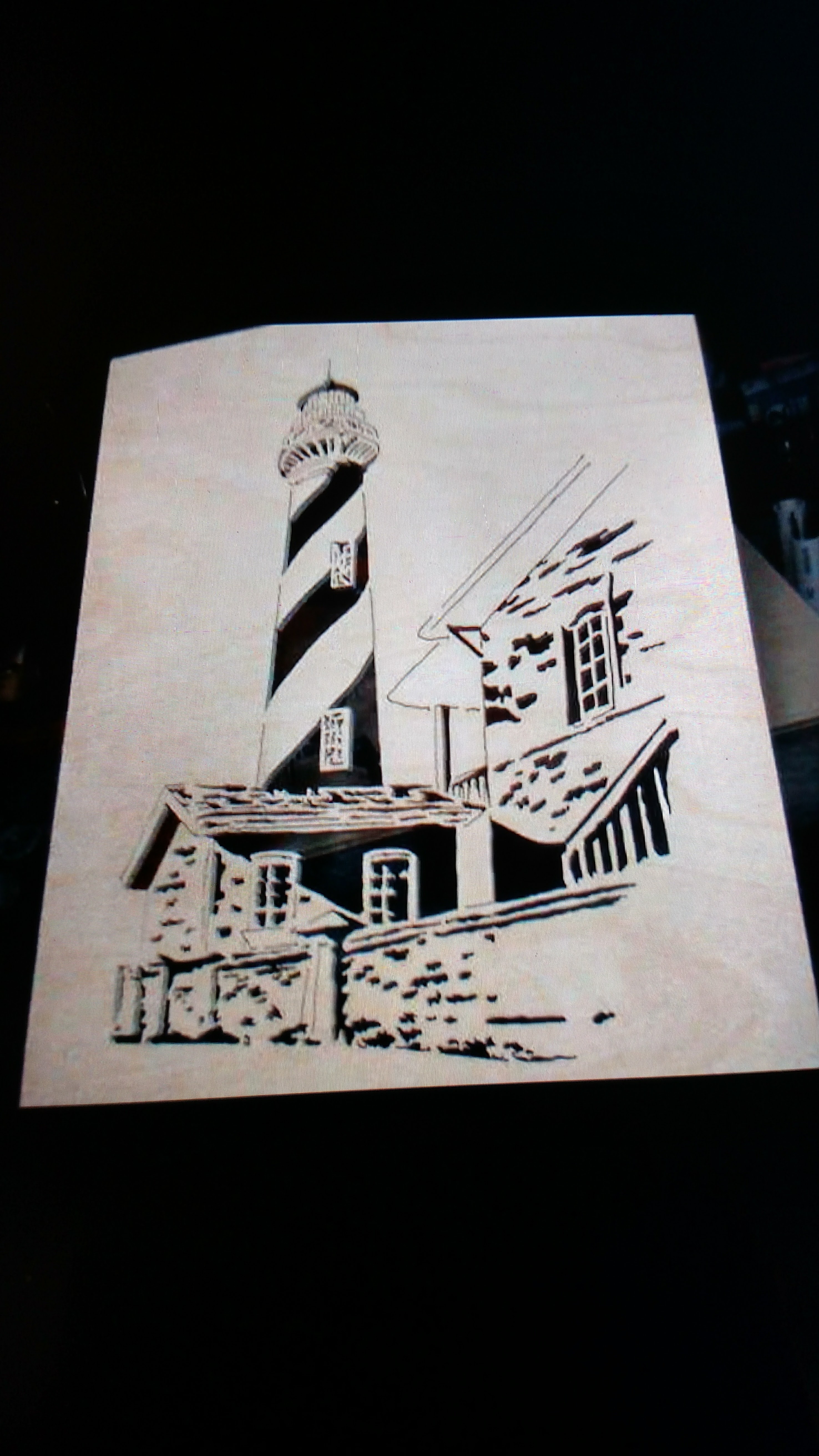

All I have to do is sand the flat sides. Here are some things I cut with spirals.
So again, what in the world do you use to sand all those edges.? And does that not take all day on each?

  I can see where the spiral blade has its advantages, stone work in the lighthouse, small tight areas. On the pieces with an exposed edge I would prefer a smooth edge that a straight blade would produce. Reverse tooth blades, IMO, leave the smoothest cut with minimal clean up. Again this is personal preference.

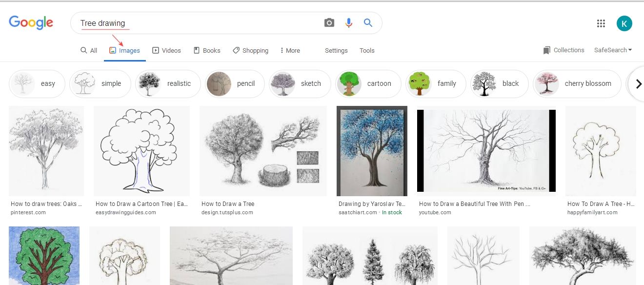

I get my images from google....
I type in what I want and always put the word "Drawing"
at the end. After it loads I click on "Images"
