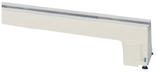

January 8, 20179 yr comment_91821 Howdy folks, I have a Jet JML10414 Mini Lathe like the image shown and the extension bed as shown below, the distance between centers is 14" stock model. The extension bed that I have will extend the working distance between centers to 40". I need another 6 or so inches in order to turn my rear chair legs for the shaker rockers I am going to build. I like the small foot print of this lathe, it also has an indexing head which I really need for my rung hole positioning marks for the chair legs. So I'd really like to use this lathe for chair parts, but it comes in just a tad too short. Does anyone have any suggestions to get that extra 6" into the working distance? Report

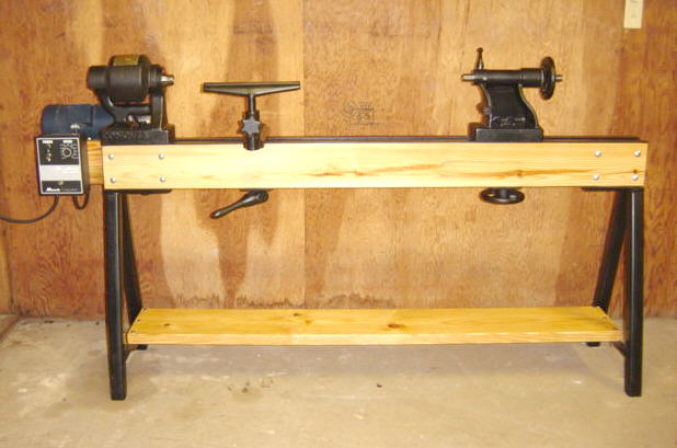

January 8, 20179 yr Author comment_91831 Hmm, I could use the Conover lathe principle, some angle iron for the lathe bed over some timbers. Report
January 8, 20179 yr comment_91833 Remove the extension table and make a filler piece to cover the additional length needed and attach the extension to the filler piece. You will need to make sure that you have the dead center the exact same height as the live center and that it is secure so there will not be any lateral movement. Report
January 8, 20179 yr Author comment_91834 7 minutes ago, Allen Worsham said: Remove the extension table and make a filler piece to cover the additional length needed and attach the extension to the filler piece. You will need to make sure that you have the dead center the exact same height as the live center and that it is secure so there will not be any lateral movement. Allen, that's a great idea, the filler piece would not even have to be functional, just an extension block really, right? Report
January 8, 20179 yr comment_91837 That is correct. As long as it is stable and can hold the work piece solidly. At least that's how it looks to me from my couch. :-) Report

January 8, 20179 yr comment_91843 Would something like this work? http://lumberjocks.com/CartersWhittling/blog/27811 Report

January 8, 20179 yr Author comment_91849 12 minutes ago, lew said: Would something like this work? http://lumberjocks.com/CartersWhittling/blog/27811 That would work too Lew! Report
January 11, 20179 yr comment_92185 If the two pieces just bolt together just get some all thread long enough and double nut both sides. Report

March 18, 20206 yr comment_221942 On 1/11/2017 at 8:01 AM, John Morris said: and double nut both sides Or chunks of pipe between. Report
