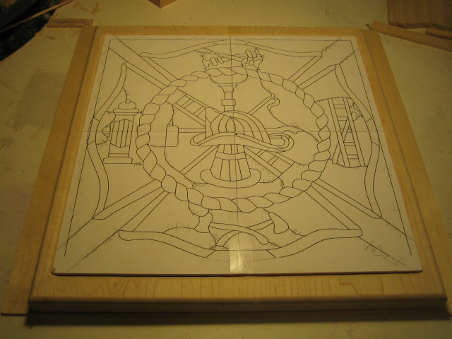

Any picture can be cut to pieces with a scrollsaw after he has glued it on to the top of a flat piece of wood.
 First I found a picture, put it in the printer and sent it to resizer which mom had loaded onto the computer for resizing her stained glass patterns, she done the hard work, and I had resizer to make this firefighter thingy 13x13". It kicked out 4 pieces of paper, which after cutting and taping them together is 13" square. So after preparing the wood flat and smooth I put down a layer of 2" clear packing tape. Next I sprayed stickum all over the clear tape and installed this pattern on to the stickum glue. If any edges out past the pattern are sticky I use news paper or tissue to cover it so my hands won't get stuck making it hard to turn the pattern around and around on the scrollsaw. Next I drill a small hole between the pattern and the area I will call the box. Install the blade and saw all the way around the pattern. This should cut the pattern free of the box. If you haven't pushed the saw blade sideways while sawing, the pattern will push out of the box. If it won't come out, more practice using straight blades is needed using the scrollsaw. And here my friend using a spiral blade will give you no practice operating a scrollsaw. Throw them away.
  And everbody knows practice is mandatory especially if a person wants recognition.
Also this being a stained glass pattern I have to stop and cross out all the unnecessary lines before I start sawing. Although on some of my projects I use all the glass lines so the picture ends up with the same amount of gaps on the entire picture so hopefully I can place pieces of thin wood around the sides to eliminate all the gaps.
  Learn something everyday. One does not have to double click when he is inserting a picture unless he wants two of everything. So when I figure out how to take one away, I will.
   You will also notice people who draw patterns for glass don't get real technical. Study this picture for a while.
Thanks!
Can I ask why you used the clear packing tape between the printed picture and the wooden surface? Easy removal??
Thats right Lew. See where I peeled off the tape and the rest of the pattern on the box. If I did not use the clear tape I would have lots of glue and pattern to take off the box top. The quickest way to remove that is lacquer thinner.  Lots of extra time spent.
Some use blue painters tape which is okay but is more narrow and takes longer and more uneven surfaces. I like my surface to saw as flat as I can get it if I am cutting really small things so the reason the wide clear tape. I do overlap a little .Some spray the back of the pattern instead of on the tape. I have less screwups if I spray the tape. I had a pattern fold on to itself before I could get it installed is the reason the glue goes on to the tape. My way takes a long while  of thinking and doing.
I have heard the clear package tape also helps to lube the blade. I also use it under my patterns.
I forgot to mention that Rusty. Yes thats the other main reason to use clear packing tape. And if you are stack cutting  put a sheet of wax paper between each layer of wood.
   You can tell and feel the difference if you put the tape a couple of inches from where you start sawing say 3/4" wood and by the time you get to the tape the pressure of pushing the blade will change.
