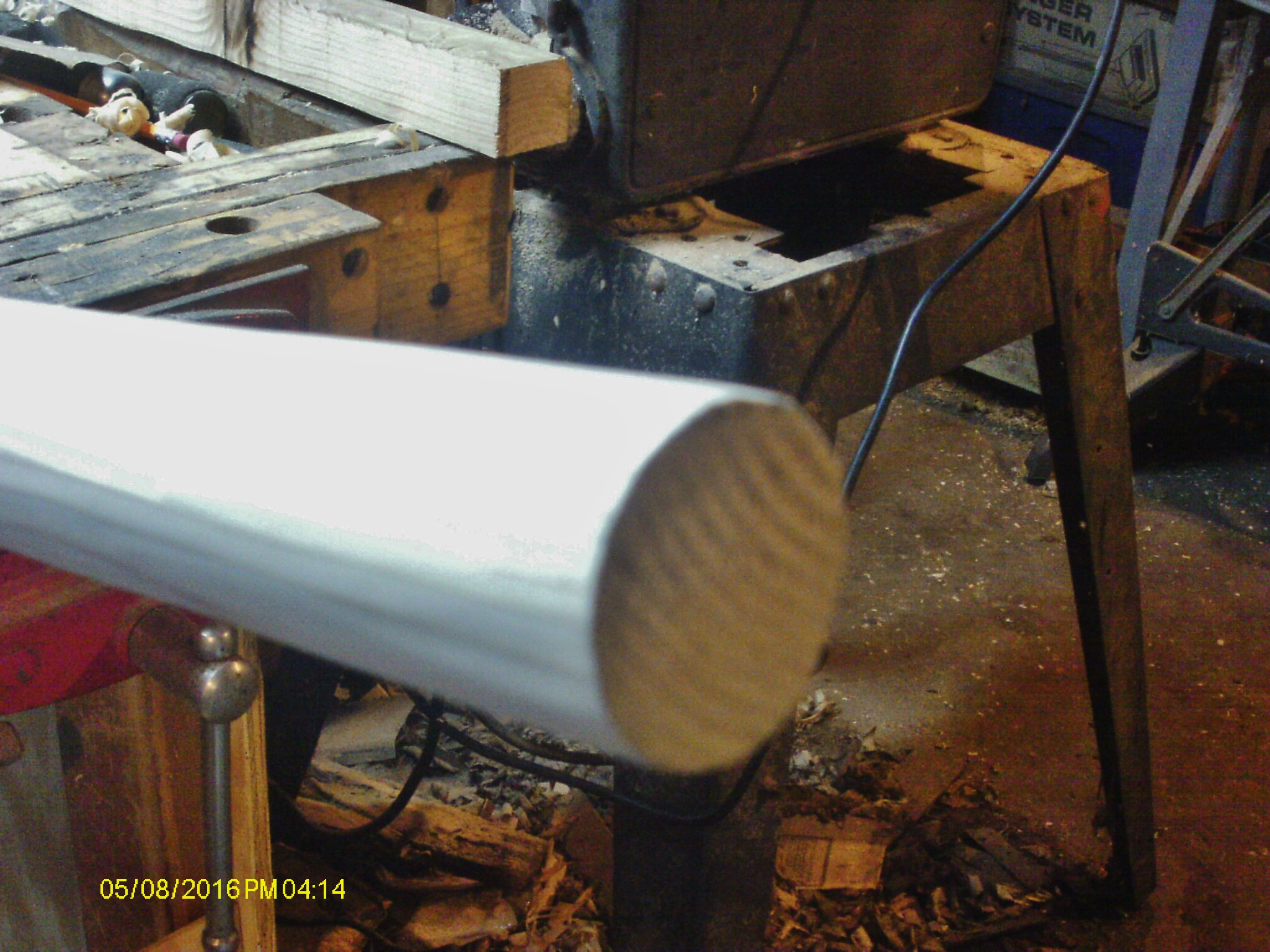

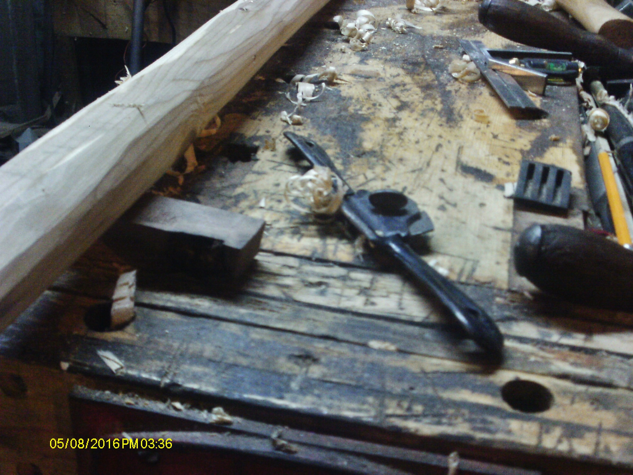

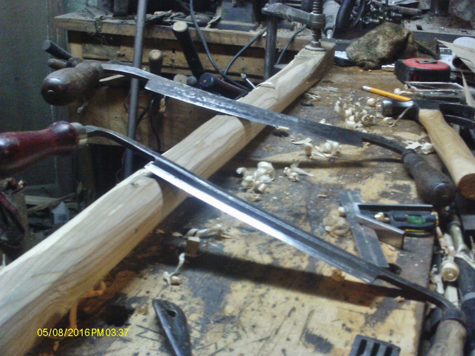

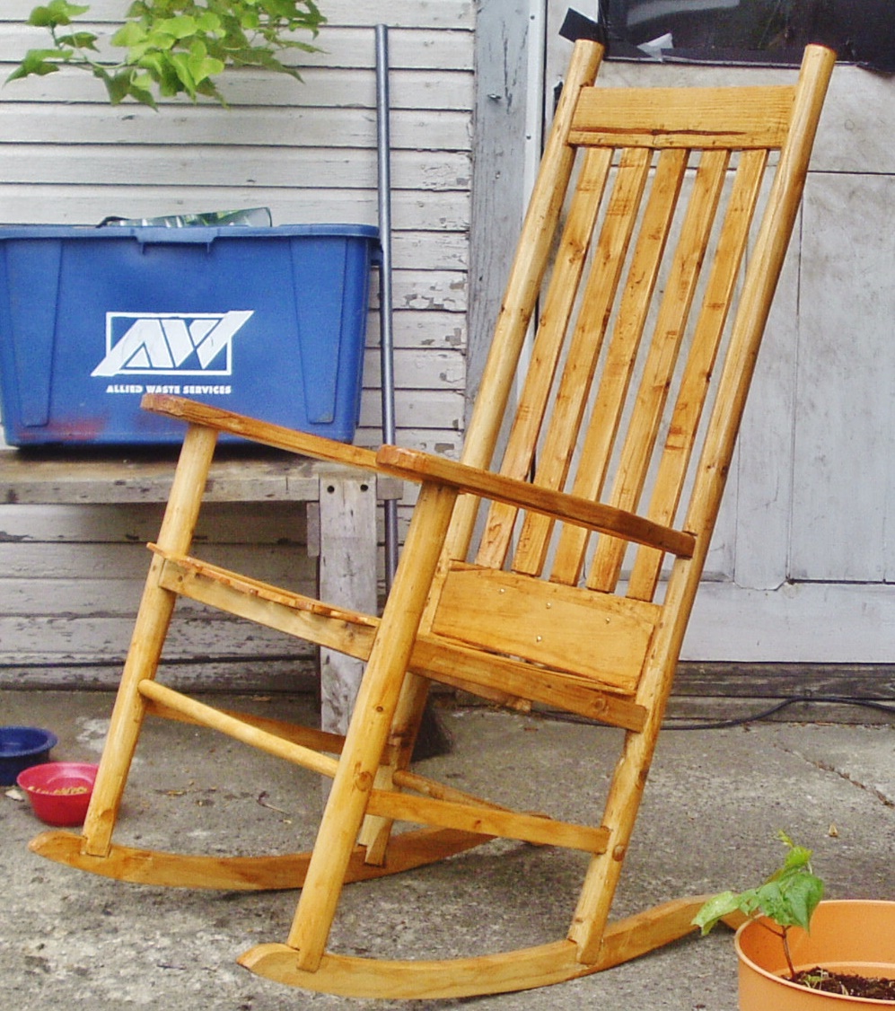

December 31, 20169 yr comment_90231 They come in handy, somedays... Used bevel up, or bevel down, depending on the direction of the grain. Making a square post into a round one.. Clean the facets round with the spokeshave, might not even need sandpaper... Just to make a four poster rocking chair... All because my lathe wasn't long enough. Both tools also helped with the rockers. Mainly to remove saw marks. Report
