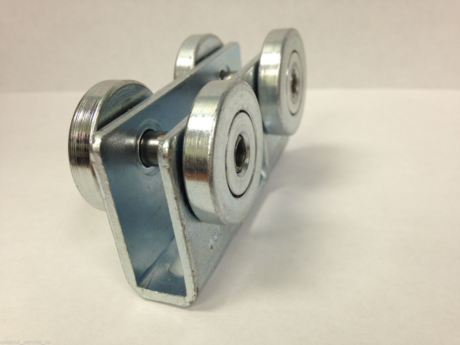

December 27, 20169 yr comment_89581 The configuration of my shop dictates storage of planer and sanding machines on low shelf, with lifting them to bench height; both tools are in the 60# range, and any tool upgrades in future will probably entertain tools in the 100# range. Herniated disks suggest that now is a good time to think of mechanical aids. The first step will be to mount the tools on pull-out shelves that will place the tool in the shop space aisle, about 4" above the floor. I looked at floor lifts (mostly designed for motorcycles), but [in the size range I need] they won't lift to 33" bench height, and then the lift itself is a floor device, in the way. So I'm "looking up", to a ceiling mounted hoist. I can mount an 8' superstrut channel with a couple of trolley inserts, and then bolt the trolleys to a hoist. So here is where I'm at the fork in the road: manual or electric hoist? The electric is $90 (400# rating). But there are also manual / pulley hoists for less. Any thoughts on which way you'd go; have you "already gone" there and have advice? I love to learn from the mistakes of others; even better to copy success!! Report

December 27, 20169 yr Author comment_89672 Thanks for all the valued input. I think of this as a "sanity check": if it still sounds crazy after your input, it must be the right idea! The physical constraints are a gross shop dimension of 5'x13' (nee "storage room"); it runs along a side of the garage, with the original opening into the water heater utility room aided by opening a doorway into the garage in the middle of the long wall. The 5' width is divided into a 30" x 13' bench and 30" of aisle. It works. But floor space is a premium. I started designing with the floor lifts, but they always need a footprint, even when folded. Hence my thoughts turned upward. Y'all confirmed my thinking: fixed 8' unistrut bar, two trolley inserts, electric hoist. I'll mount the heavy tools (currently all the tools store under the bench) on roll-out platforms to allow hookup to the hoist. All I really need is to get the tool to about 29" above the floor, at which point I can lift it onto the bench (why 29"? leaves 4" slack when I lift, and the 24" offset of a 5' drop requires 64.6" cable). It looks like all the parts come to about $125. Copay on a back operation is about $400! Smile on g-kids face when I give them a wooden toy: priceless. For me, anyway. They have no idea what it is since it has no plastic on it, but keepsakes are a long term investment. Report

December 29, 20169 yr comment_89836 I would like to mount a unistrut on the ceiling with a trolly and mount an electric hoist to that. Then I could roll the hoist anywhere along the length of strut. Report
December 29, 20169 yr comment_89842 Check into barn door hardware. It may hold more than Unistrut, and rollers are made specifically for it. John Report
December 29, 20169 yr comment_89849 30 minutes ago, HARO50 said: Check into barn door hardware. It may hold more than Unistrut, and rollers are made specifically for it. John costs less too.... Report
