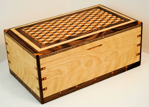

This one took a long time....

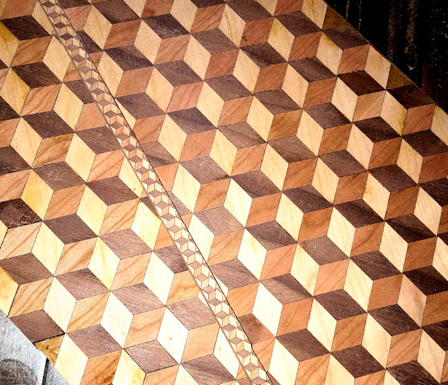

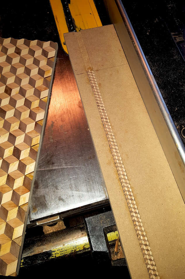

I have always been fascinated by the "Louis Cube" pattern and thought I'd try a little bit of an "extreme" version on one of my boxes....

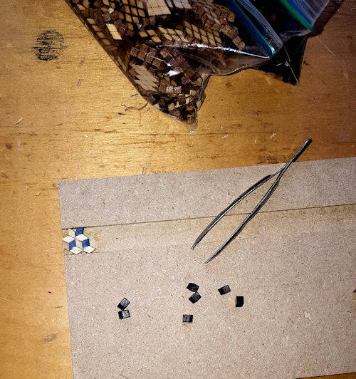

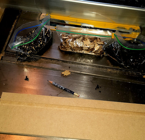

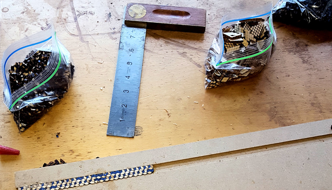

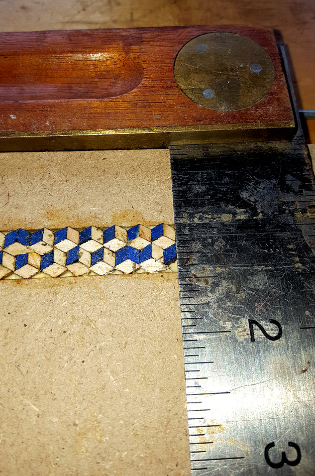

I wanted to incorporate the pattern in to an inlay surround to match the top.  I had a fellow with a laser cut the 1/4" diamonds (30 degrees x 60 degrees) and 1/8" thick of the three species that I used.  Birch, Mahogany & Walnut.

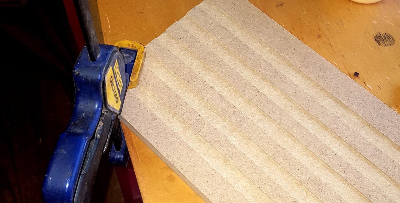

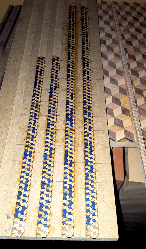

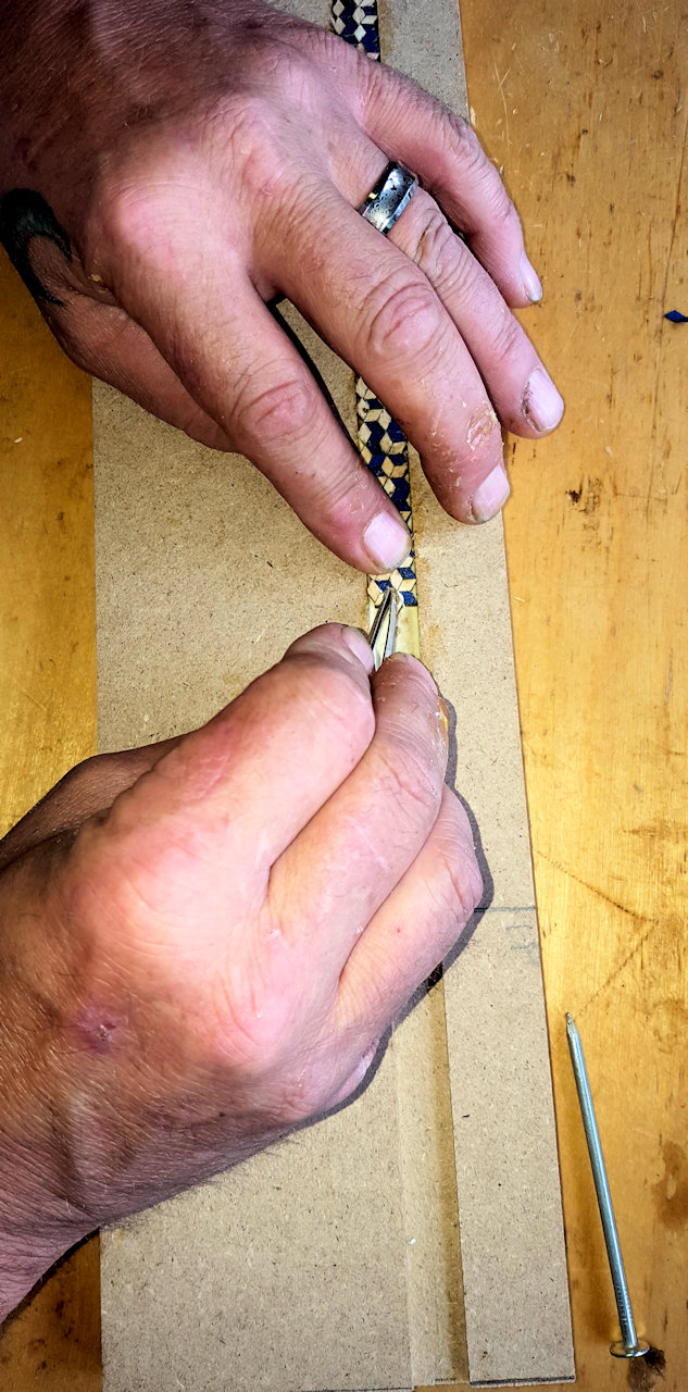

Then I cut several dados in a substrate to give me a platform and a template to lay out and glue up what I needed... and then..... I got busy.  I think I timed it out at 8 minutes per inch to glue these little buggers in place.... total of 56" needed and I probably did about 20" more than required (just to be safe.
Once I got them all glued up and in place, I trimmed down to fit in the dado that I cut in the box...
Don't know if I'll ever do this again, it was one of those things that just had to be done, though....
Thanks for looking.

How did you keep the glue from sticking in the substrate dados?

Thanks, I just glued about an inch at a time.   Once that was used up, I slathered in another inch or so of glue...
I wanted it to stick.  I, then, milled it down from the back side using my drum sander, leaving about 1/8" of substrate.
It was tedious.

well, i had a customer that, over time, bought 5 humidors.   I couldn't justify the time involved as it relates to dollars, so I gifted it to him.  Incidentally, he just ordered another a week ago.
my guess is this would be a $750 or higher box. really nice work
That was really generous of you,Ed. I would have kept it around awhile just to look at it. What a beautiful piece of work, and such small detail too leave me breathless. I think that is a first on the size of those cubes. Never seen any that small.
