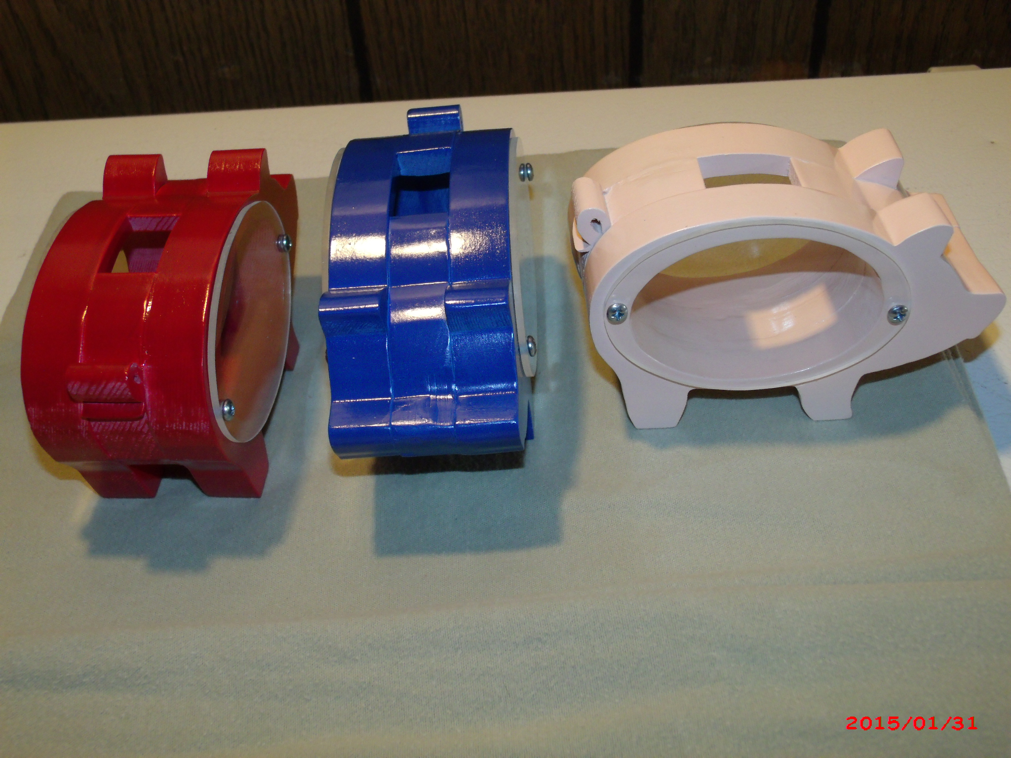

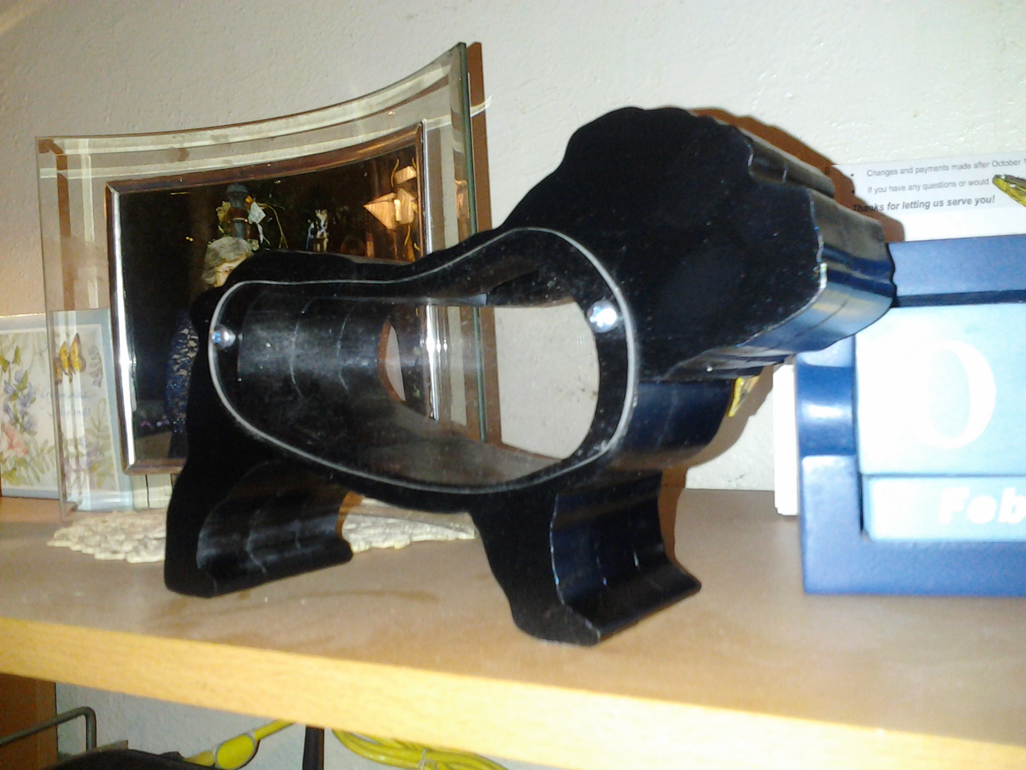

December 22, 20169 yr comment_88894 When cutting the "banks", I use plexie for the windows. Leave the paper on or cover with "blue tape" and then glue the pattern on. I have the best luck stack cutting 2 at a time using a 5R blade. Cutting quick so as not to build up too much heat keeps it from melting back together. Report
