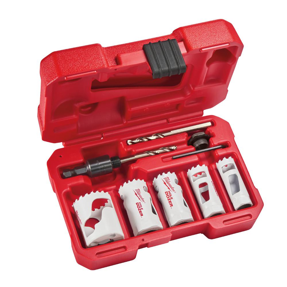

December 19, 20169 yr comment_88385 Most hole saws that have interchangeable mandrels also have a removable pilot bit. Remove the pilot bit but leave the mandrel attached to the hole saw. Mark your hole OD with a pencil or felt tip centered around the current opening...you could make a template by first drilling through a scrap piece of wood and laying over the hole as a guide too Use a variable speed (preferably corded in this case) drill at low/slow speed with moderate down pressure to open up hole diameter. I assume you're only talking about a 3/4" or less floor thickness??? Even so, these styles will drill to ~1-1/2" depth. Example of interchangeable mandrel (arbor) for various size hole saws with removable/replaceable pilot bit Edit add: BTW...Welcome Carey to TPW. Glad you found us and jumped right in with a question. I believe you'll find this a great place to hang your hat and call home. Take a look around and if you have any questions about the site, don't hesitate to ask. We try to be a friendly group and enjoy sharing and learning together. Edited December 19, 20169 yr by Grandpadave52 Report
December 19, 20169 yr comment_88388 The hole saws pictured in Dave's post can be purchased individually at HD. Nice to have the set, but they are somewhat pricey. Welcome to the forums Carey Edited December 19, 20169 yr by It Was Al B Report

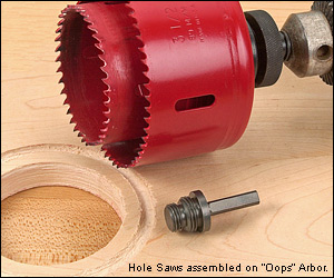

December 19, 20169 yr comment_88398 enlarge the hole w/ one holesaw inside of the other... http://www.lenoxtools.com/pages/lenox-wood-metal-cutting-bi-metal-hole-saws.aspx http://www.leevalley.com/US/wood/page.aspx?p=52518&cat=1,180,42316 Report
December 19, 20169 yr comment_88414 5 hours ago, Stick486 said: enlarge the hole w/ one holesaw inside of the other... Forgot about this idea! Report
December 19, 20169 yr comment_88447 7 hours ago, Stick486 said: enlarge the hole w/ one holesaw inside of the other... http://www.lenoxtools.com/pages/lenox-wood-metal-cutting-bi-metal-hole-saws.aspx http://www.leevalley.com/US/wood/page.aspx?p=52518&cat=1,180,42316 One whale of a good idea! Report
