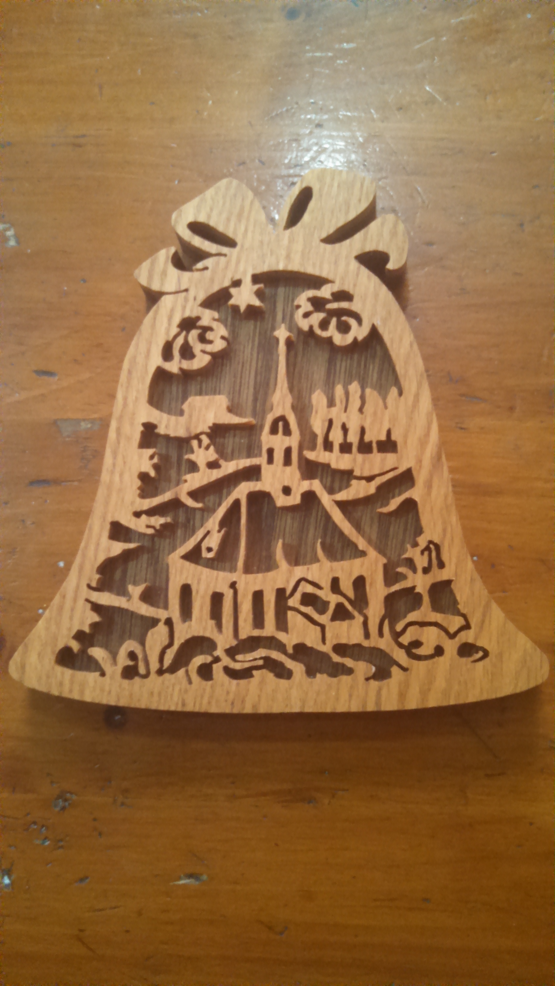

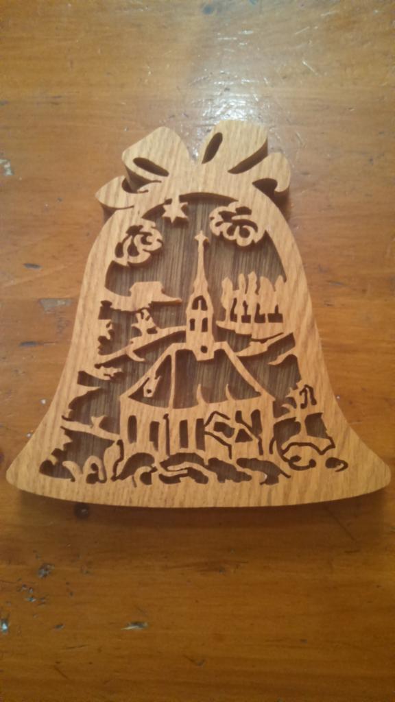

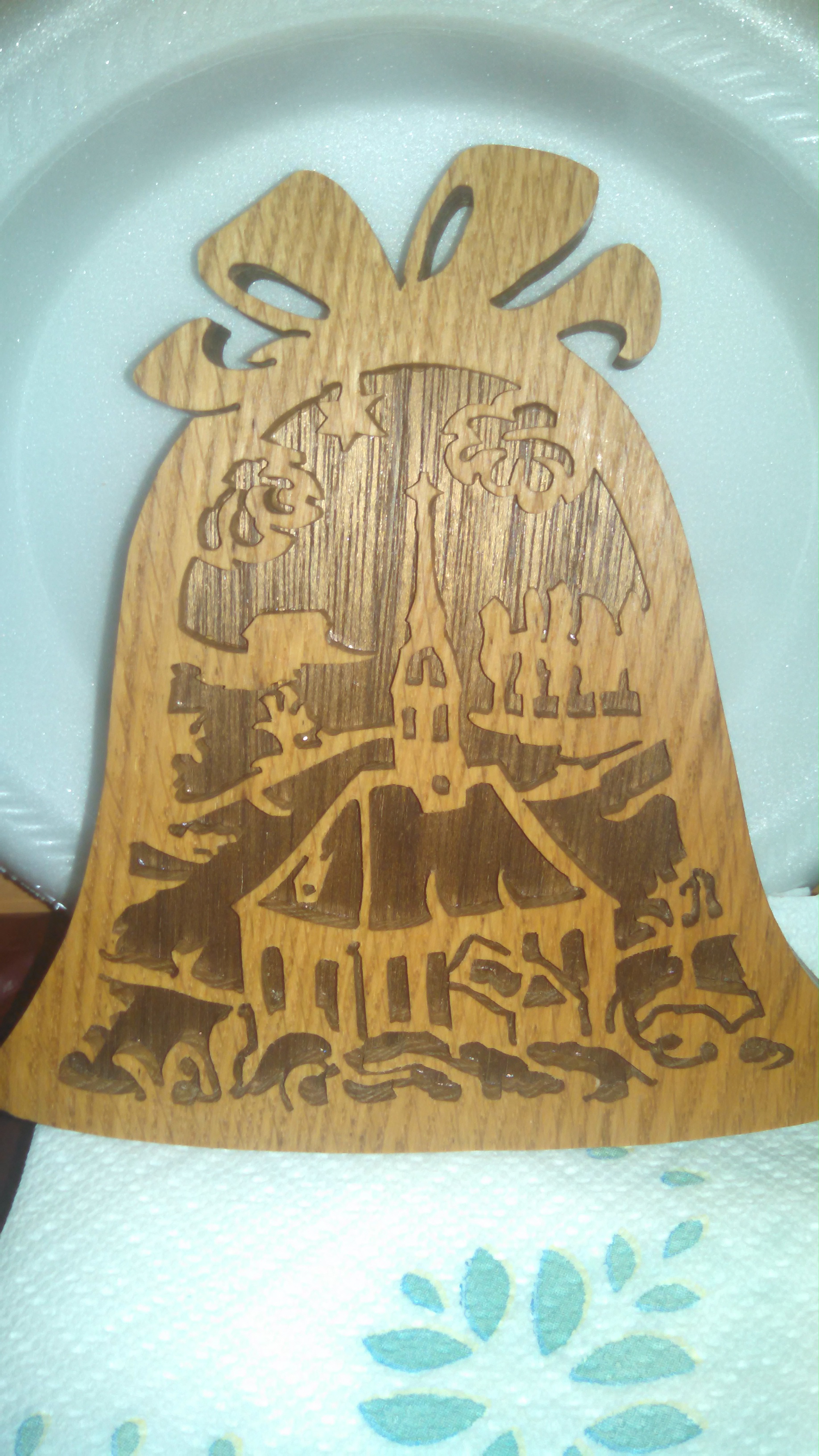

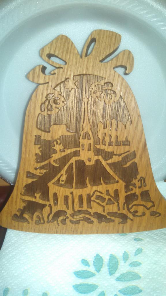

December 2, 20169 yr Popular Post comment_86079 In a pinch I used Pam to finish this, surprisingly its held up quite well. Report
