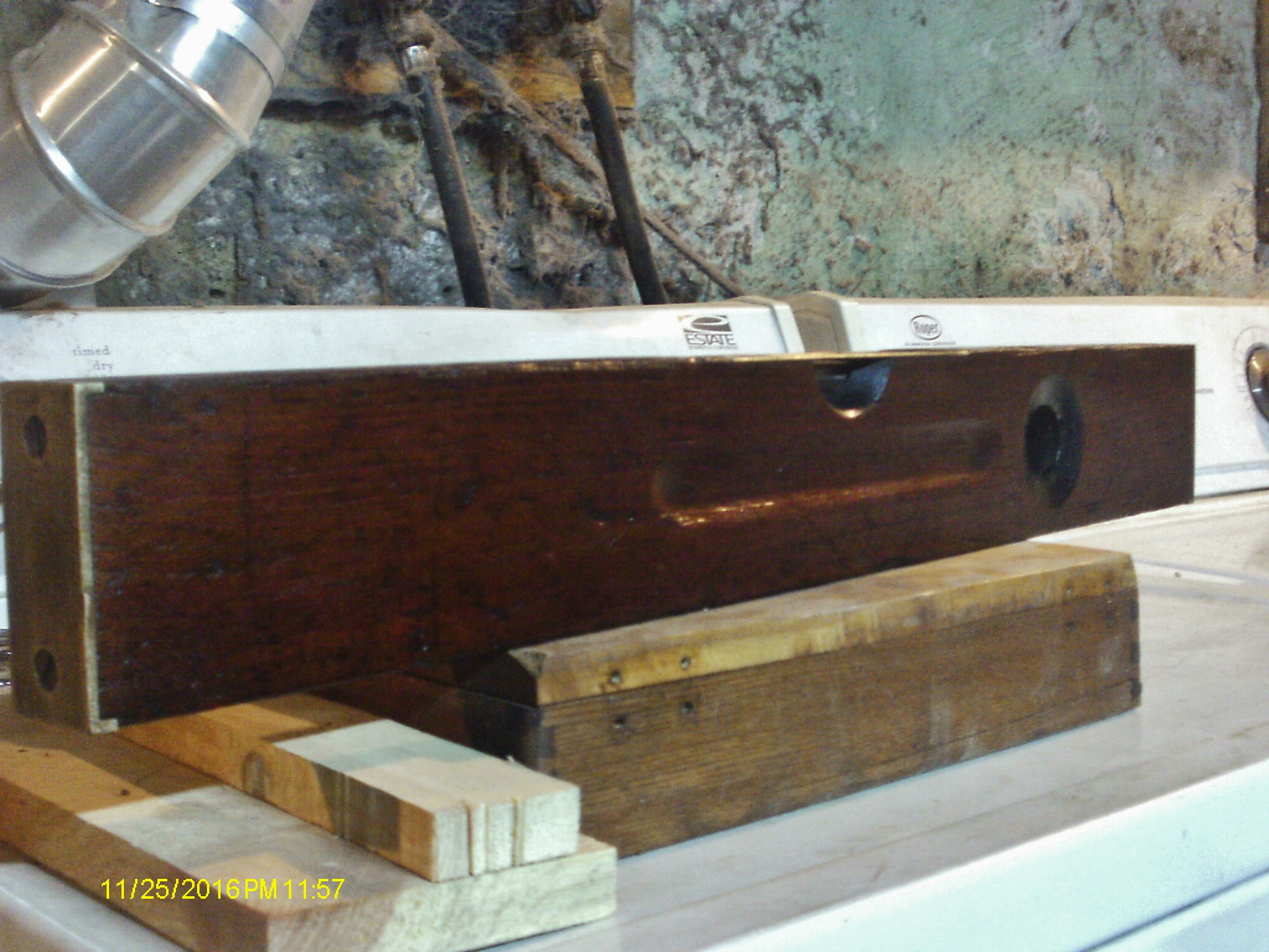

November 26, 201610 yr Author comment_85397 Testing in progress........smell was gone from the level......waiting on the spray coat to dry now.....will see how it turns out. IF it works out, I'll put a coat of BLO on the box, and wait again til the smell goes away. Then spray it. No woodworking until after the finishes are done. And the knee stops hurting. Report
November 26, 201610 yr Author comment_85408 Went stumbling down to check on the lacquer results.....so far, so good. I sprayed the Stanley level, at least I thought i got it all... Between the BLO and the Lacquer, this Cherry turned nice and dark. Didn't seem to bother the Beech handle, though But it turned some old Rosewood almost black.. But, there wasn't any "crazed" surface, and hardly any bubbles. Will check again in the morning and might be able to re-do the Cherry Box. What is with that blue line under these words, and why are they blue as well? Report
November 26, 201610 yr comment_85409 your problem came from applying too thick of a coat of the blend. BLO takes weeks to dry on it's own. your mix should've contained 1/3 mineral spirits this thins the BLO allowing it to dry faster. also this blend is a very low build finish so don't just brush it on like a varnish. it's better to flood the surface keeping it wet for 20 minutes or so then wipe off any remaining mixture. repeat this the next couple of days for a low build finish. If you desire a thicker film let it cure for 3-5 days then it can be top-coated with plain poly. Report
