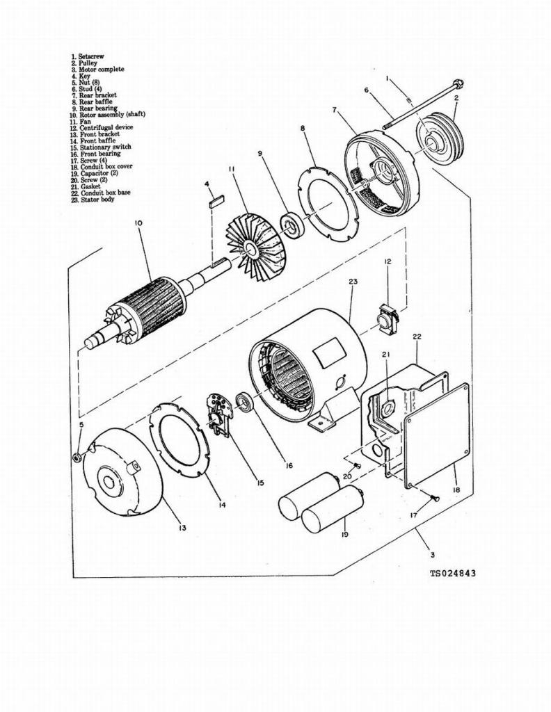

November 25, 201610 yr comment_85357 and for those of us who are unlearned regarding electric motors, would you care to explain what a 'point' is, where they are located, what they do, and what goes wrong with them that needs fixing down the road? Report
November 25, 201610 yr comment_85363 Centrifugal switch function. When the motor is OFF and at rest, the points on the contact plate are closed. When the motor is started, current is sent to the start capacitor, through the closed contact plate points, and then to the motor start windings to get the motor up to full speed as fast as possible. When the speed of the motor shaft gets close to the rated motor speed, centrifugal force causes the flyweights to override actuator spring tension, swing out, and open the contact points. When the points are open, current is cut to the start windings and the start capacitor, allowing them to cool. At this point, the run windings take over and operate the motor. (Note: Often a run capacitor is used in the run circuit to increase motor efficiency.) When the motor is turned OFF, centrifugal force diminishes, and the springs draw the flyweights back in (sometimes with a click sound), returning the contact points to the closed position. Report
November 25, 201610 yr comment_85378 i barely got a C in my one course on electrical engineering. i'm sure that what you wrote is correct, but that doesn't mean i understand where i would go looking for points in a motor tomorrow. i plug it in, i hit start/on, it better work! Report
November 26, 201610 yr comment_85388 45 minutes ago, DAB said: i barely got a C in my one course on electrical engineering. i'm sure that what you wrote is correct, but that doesn't mean i understand where i would go looking for points in a motor tomorrow. i plug it in, i hit start/on, it better work! Yes, most are on the fan end. Try blowing the dust out of it with air before taking it apart. Dust can get in the works and keep the points from closing. Report
November 26, 201610 yr comment_85390 3 hours ago, DAB said: and for those of us who are unlearned regarding electric motors, would you care to explain what a 'point' is, where they are located, what they do, and what goes wrong with them that needs fixing down the road? all-about-electric-motors-fa.pdf Electric Motor Troubleshooting.pdf Part #12 is the switch... Report
