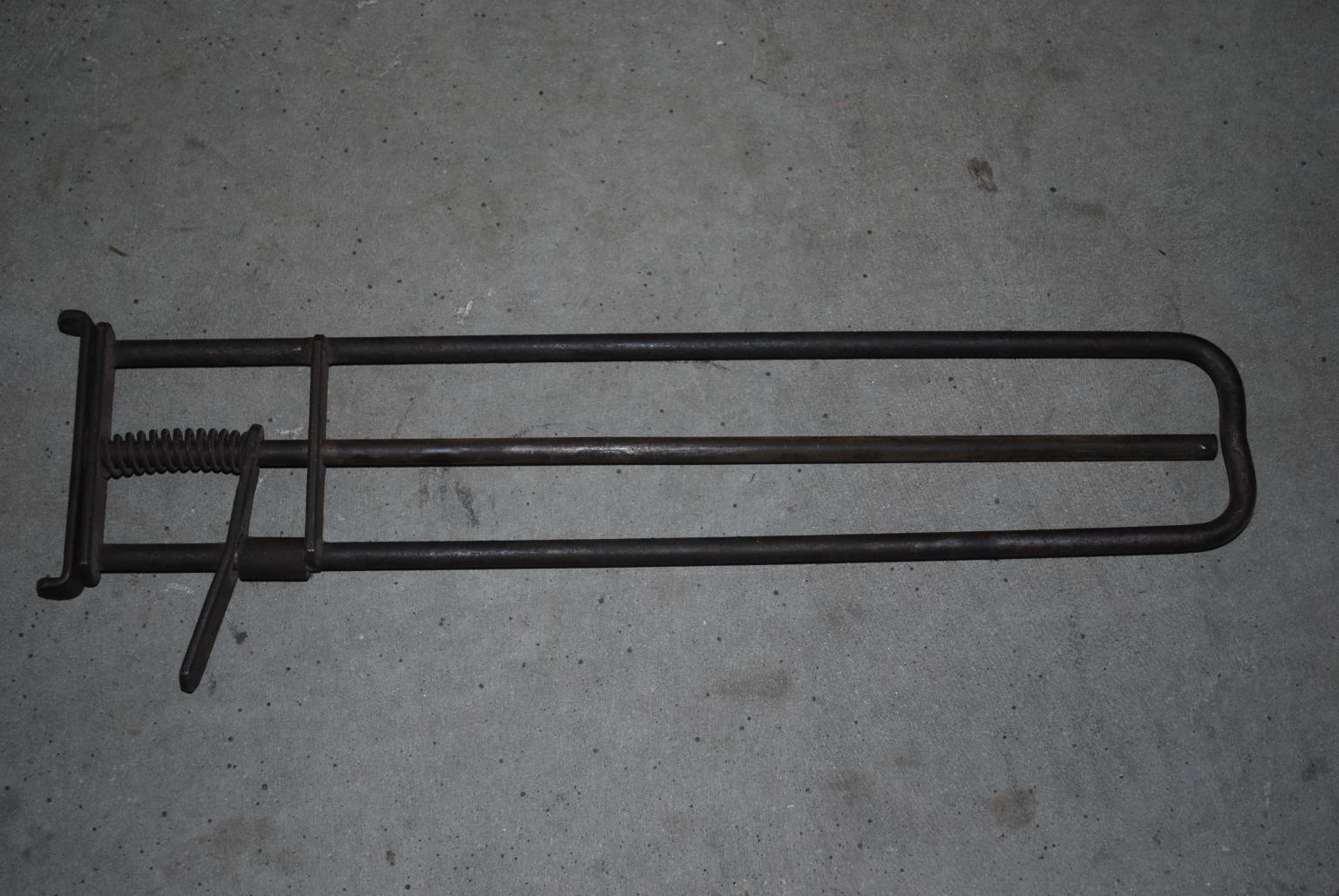

November 18, 201610 yr comment_84577 Went to see a friend today, and he showed me some old tools, dating back to his father and grandfather. I got close in my guess on this one; wanted to see if anyone else can figure it out. Keep in mind that this is not a woodworking tool. It's about 16" long. John Report
November 19, 201610 yr comment_84626 Wow! Cool Haro! Since we have a live what's it, can we ask questions, like does the cross member above the spring and lever slide up and down? Report
November 19, 201610 yr comment_84639 Seeing as how opening my car hood stumps me, I won't venture a guess. Report
November 19, 201610 yr comment_84676 Look like the center rod along with the left end with feet extend. The spring loaded handle would automatically lock it in place until you depressed the handle. But I don't know what it was used on. Roly Report
November 20, 201610 yr Author comment_84683 Worked all day, so I haven't been on the computer, but I won't keep you in suspense any longer. Some good guesses here! John... there are actually two cross members. The center rod slides through a hole in the inner one, while the outer one (with the 'ears') is attached to the rod. Gene.... since you can't get the hood open, you would have no use for this item. Stick.... since Mike is a mechanic, he may well know! Dan.... a little small for a gate. Lew and Roly... RIGHT ON! The tool belonged to our local Studebaker dealership. When a procedure required the clutch, brake or gas pedal to be depressed, the rounded end was placed against the front of the seat, and the rod extended to keep the pedal down on the floor. When done, pushing the little lever released the contraption. It is a manufactured tool, not a one-off, but we don't know if it was a Studebaker exclusive or (more likely) a generic tool used on any vehicle. Thank you all for playing! John Edited November 20, 201610 yr by HARO50 Report
November 20, 201610 yr comment_84709 2 hours ago, HARO50 said: When a procedure required the clutch, brake or gas pedal to be depressed, the rounded end was placed against the front of the seat, and the rod extended to keep the pedal down on the floor that's where I saw it in use... 2 hours ago, HARO50 said: a generic tool used on any vehicle. correct... Report
