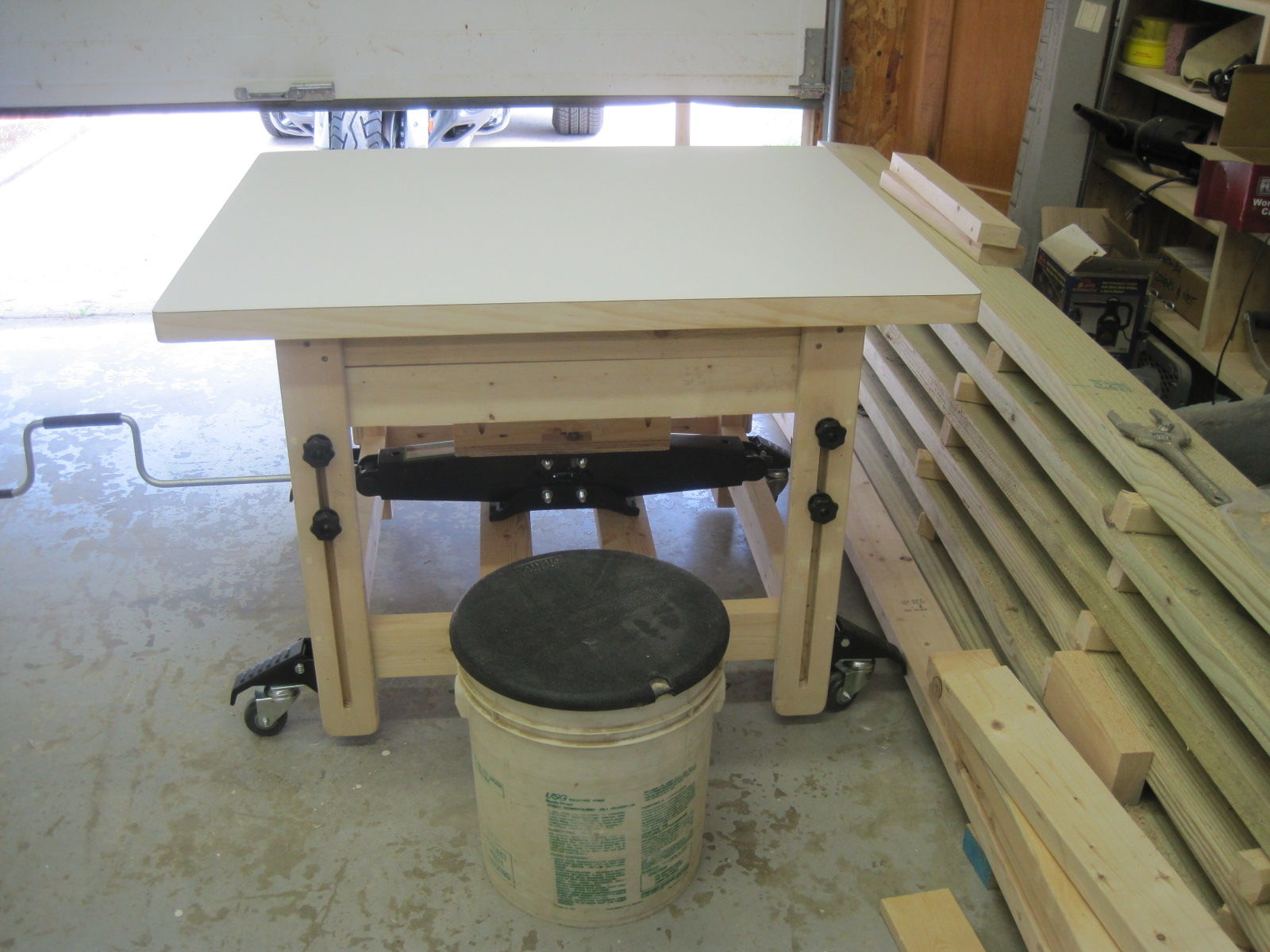

tomp Posted November 16, 2019 Report Posted November 16, 2019 I made mine adjustable in height - a little higher than the table saw on the max, and low enough to sit on my favorite 5 gallon bucket at the low end. Bought an RV scissor jack from HF, works perfectly to raise and lower the table. The upper and lower frames are built with2x4's that were trimmed and squared, assembled with pocket screws and glue, and the upper legs are two strips of 3/4" ply, joined at 90° to wrap around the lower legs and slotted for the clamping bolts that hold it at the selected height. The top is two layers of 3/4" plywood, edged with poplar and covered with plastic laminate for easy clean-up - I've since added a Kreg base plate for a clamp at each end. I built the top with an overhang all round so I could clamp to the top if needed as I didn't want t-tracks in it.. And I added cabinets underneath to store all the little tools and supplies that need to be handy. It's on retractable casters (Rockler) as it gets moved from the end of the TS to the open space that becomes available when I put the Gold Wing outside. If I could do it again, and had more room, I'd make the top larger - limited to about 32" wide x 36" long - but I can always fall back on (2) sawhorses, (2) 2x4's and a piece of plywood if I really need a larger top. Because of the flexibility, the adjustable height was well worth the extra work involved. JimM and p_toad 2 Quote
