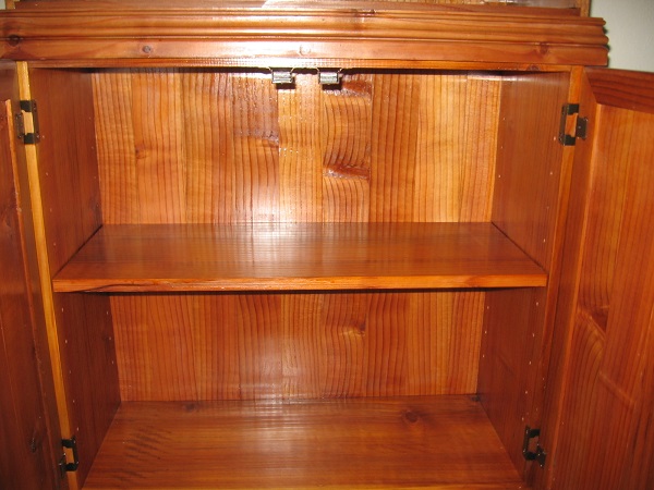

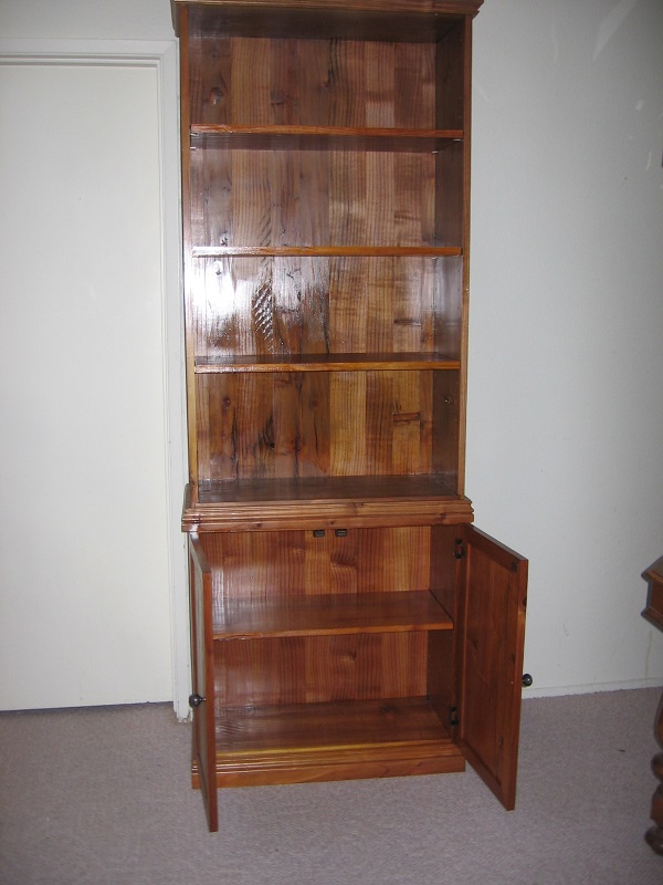

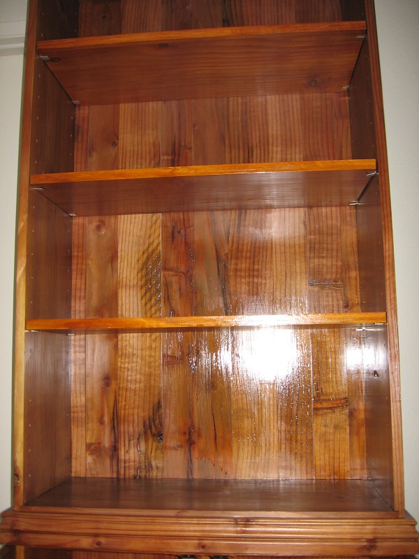

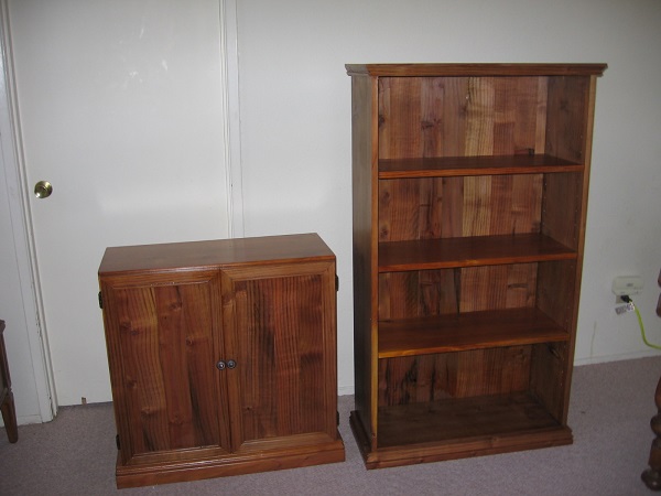

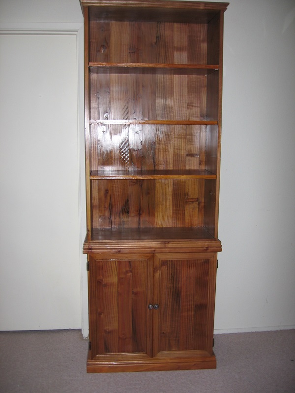

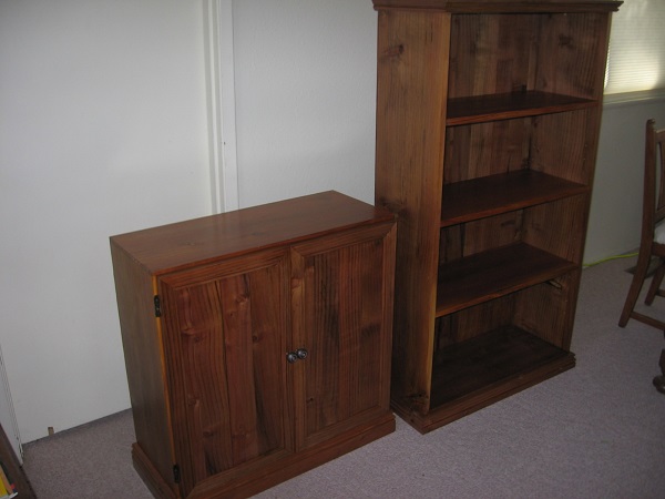

November 8, 201610 yr Popular Post comment_83300 After the fellow at the little sawmill got his deck furniture, he asked me to make him a cabinet and book shelf for his office. He had a jag of red wood and offered to pay me in some air dried lumber he had stored, mostly maple, a little dog wood, and some wild cherry. He couldn't make up his mind whether he wanted the book shelves above the cabinet or setting on the floor. So I solved that problem for him. I made the cabinet with a finished top, and the book shelves with a base molding to fit on top of the cabinet ,that way each piece could be used together or separately. Sort of like a hutch. The redwood is finished in orange shellac, he wanted the red to stand out. The back and doors are made from 1/2" thick redwood T&G I milled on the table saw. just barely had enough material, had to make the back out of the leftovers,that is why it looks sort of ruff. Herb Edited November 8, 201610 yr by Dadio Report
November 8, 201610 yr comment_83304 Outstanding work! Great Pictures and now the questions. What is your finishing schedule for this project. any dyes used? any stains used? Orange shellac, how many coats, sprayed, wiped or brushed. Any clear finish over the shellac? Report
November 8, 201610 yr Author comment_83311 24 minutes ago, Michael Thuman said: Outstanding work! Great Pictures and now the questions. What is your finishing schedule for this project. any dyes used? any stains used? Orange shellac, how many coats, sprayed, wiped or brushed. Any clear finish over the shellac? Thanks ,Mike, for the compliments. I am not an authority on finishing. No dyes, no stain, just Orange Shellac the one with the Bullseye on the can,(Zinser)? 3 coats /day,sanding between coats up to 400g on 3rd coat, next day, one more coat. done All coats brushed on. Herb Edited November 8, 201610 yr by Dadio Report
November 8, 201610 yr comment_83318 Very nice pieces. We do not get redwood here except in the big store outdoor furniture. I did not know redwood had that heavy grain in it. Report
November 8, 201610 yr Author comment_83323 24 minutes ago, Gerald said: Very nice pieces. We do not get redwood here except in the big store outdoor furniture. I did not know redwood had that heavy grain in it. This redwood came from a lone tree in a school yard. They did an expansion on the school and removed it. It was near 4' in diameter at the base and went about 80 ft in the air. The bottom tapered fast in the first 20' or so from 48" down to around 24". it had limbs as low as 6' off the ground. The big wide growth rings indicate it was a fast growing tree and since it was standing alone had plenty of sunshine all way around. Plus with the rainfall we get had plenty of water, not like a forest tree that has to compete with other close by trees for water and sunshine. Herb Report
