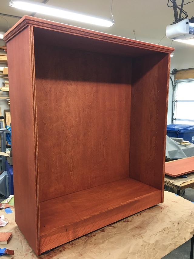

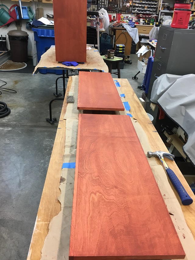

November 6, 201610 yr Popular Post comment_82877 I've been AWOL for a while, but here's my current project. It's a bookcase for a grand-niece of mine. Made from birch plywood and some lumber. Stain is Old Masters Cherry (her choice of color). Next up are a couple of coats of Old Masters Clear Satin poly and taking it to her place. She thinks I'm splitting the cost of it with her, but it's actually going to be a freebie. And yes, there are some flaws in it. Report

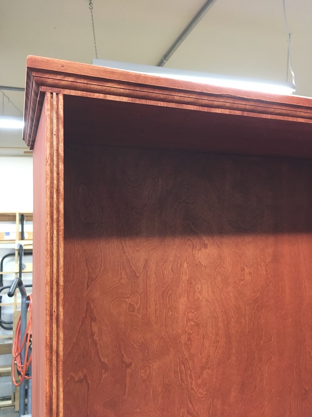

November 6, 201610 yr Author comment_82880 Yep, I'm doing just fine, no problems. Still doing the part-time FD thing (taught a trench rescue class last month). Trim was made from birch lumber. The cutter of the double beading bit I bought was only 5/8" tall, so I had to improvise and make two passes on the 3/4" edge of a board to make that trim. Glue and some 23ga. pins are holding it on. Edited November 6, 201610 yr by FireJohn Report
