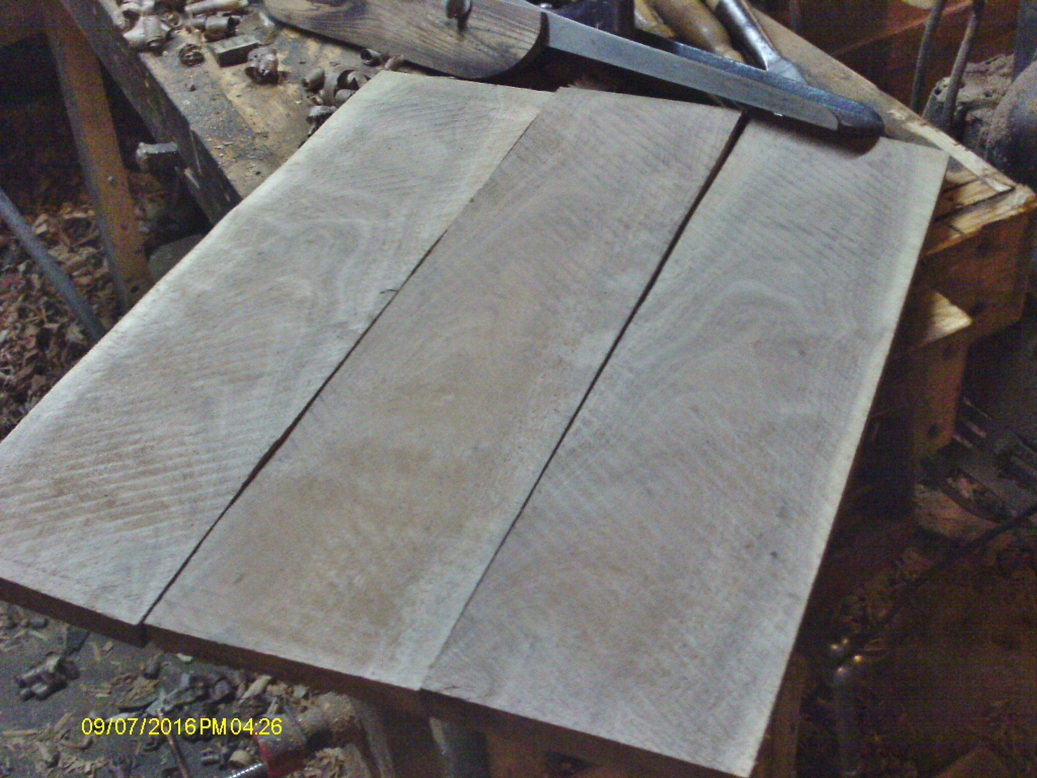

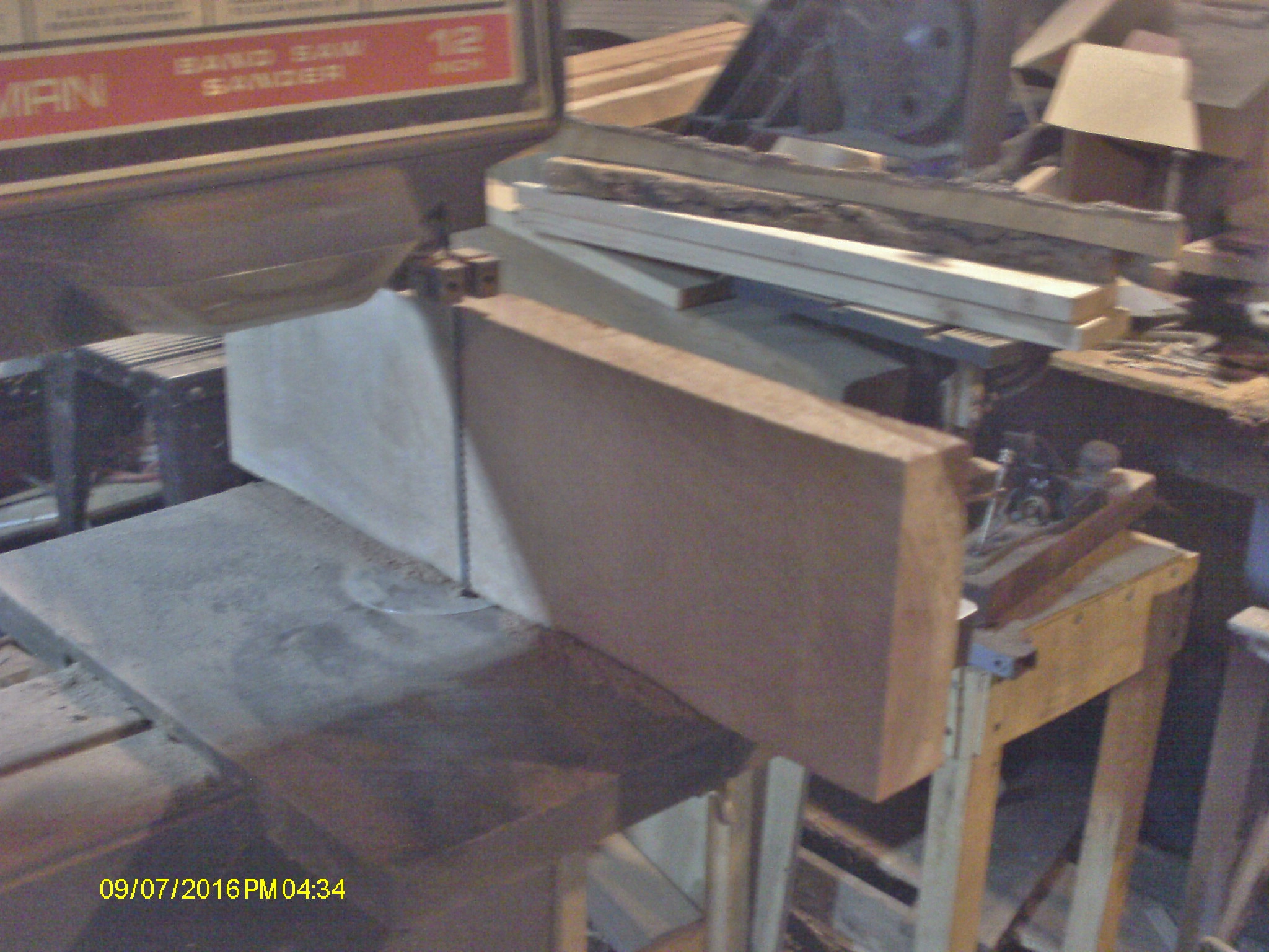

November 4, 201610 yr comment_82611 2 hours ago, Ralph Allen Jones said: what width do you prefer to saw in order to have a smooth and accurate cut? Whatever width I please. I'm confused at your question. I'f I'm resawing from rough sawn ( chain saw) cants I will use a sled to get a nice surface on one side - - run that across my 12" jointer and then back to the saw with the jointed edge on the table for a reference I'll often re mount my sled ( that runs the length of the rough cant) for a reference against the fence. Then Joint the other fresh cut face and I'm golden from there on. If I'm resawing logs I use a chalk line to get started. Edited November 4, 201610 yr by Cliff Report

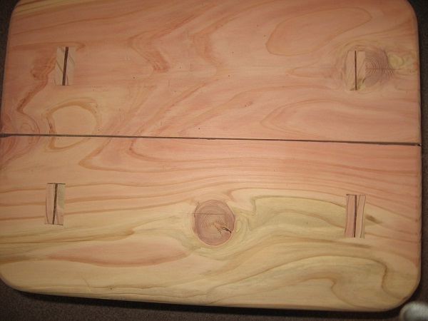

November 4, 201610 yr comment_82648 14 minutes ago, Kelso Chris said: So this thread just helped me solve the problem of re sawing a wider board on my band saw. The re saw capacity on my saw as others have said is just shy of 6". You could re saw a taller piece in two operations. Say I had a 10" board and wanted to make a book matched panel or two 10" wide panels for separate doors. I could first rip the board to 5" then re saw those two pieces. I would then have four pieces that were 5" wide each. If I carefully matched the pieces together at glue up I would end up with a 20" panel. More common would be when I am building a raised panel and need panels that are wider than 5 3/4" like maybe 7" or 8". I could take an 8" board thick enough to yield the needed panels rip it down the middle to give me 2 4" wide pieces and depending on how I reglued the pieces back together I could get a couple different grain patterns. Sorry for thinking this out loud but I've just managed to get a little more mileage out of the band saw. Thanks guys I do this exact same thing quite often to flatten warped boards, cut drawer holes in rails of tables, cut through mortises through stool seats, etc. This was a redwood stool I made, it was from a 14" wide plank. It was warped from corner to corner. so I ripped into 4 narrow boards and if you look closely you can see the rip cuts at the center of the through mortise for the legs.Then I cut the mortises before I glued the boards back together. Herb Report
