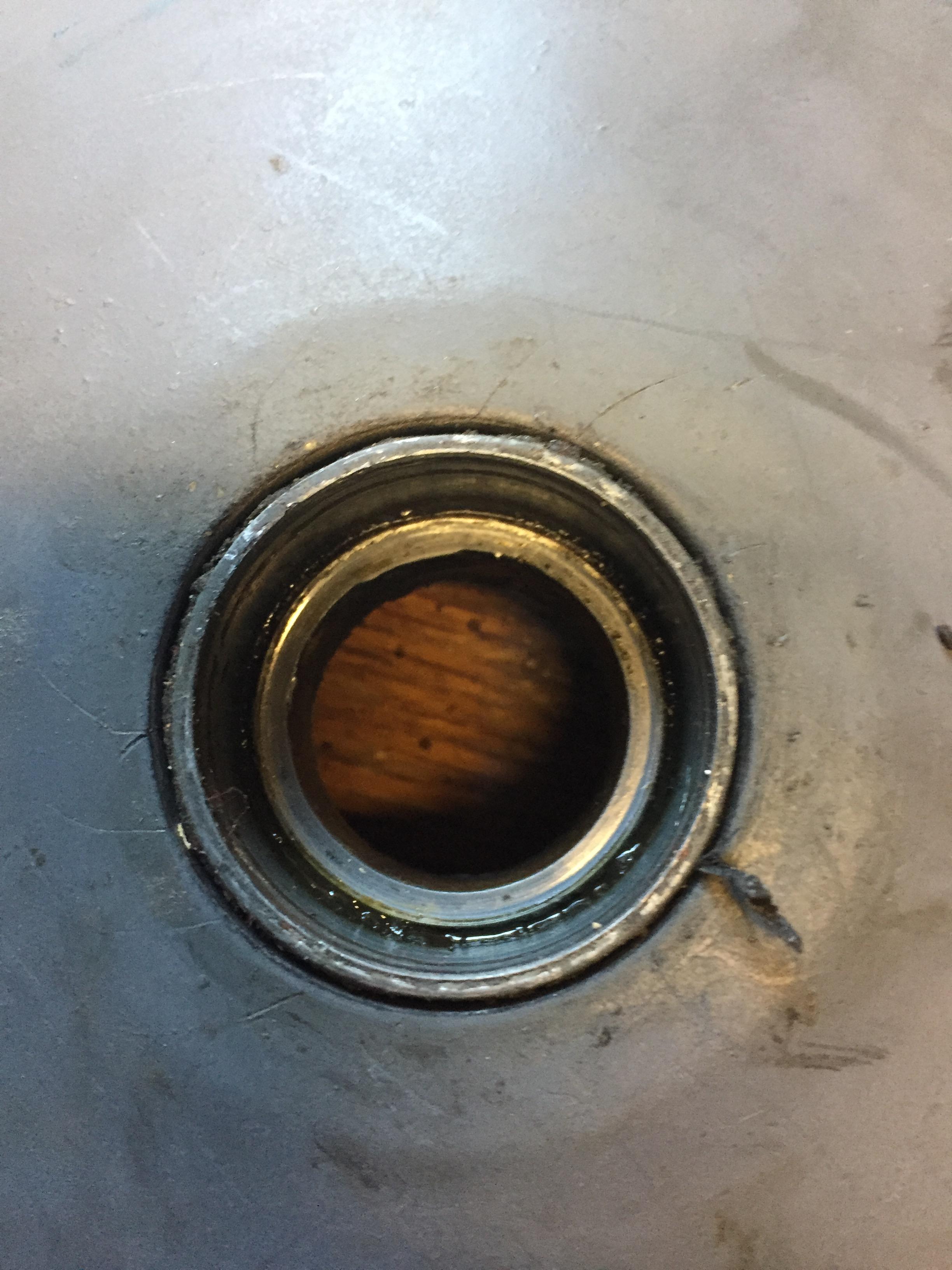

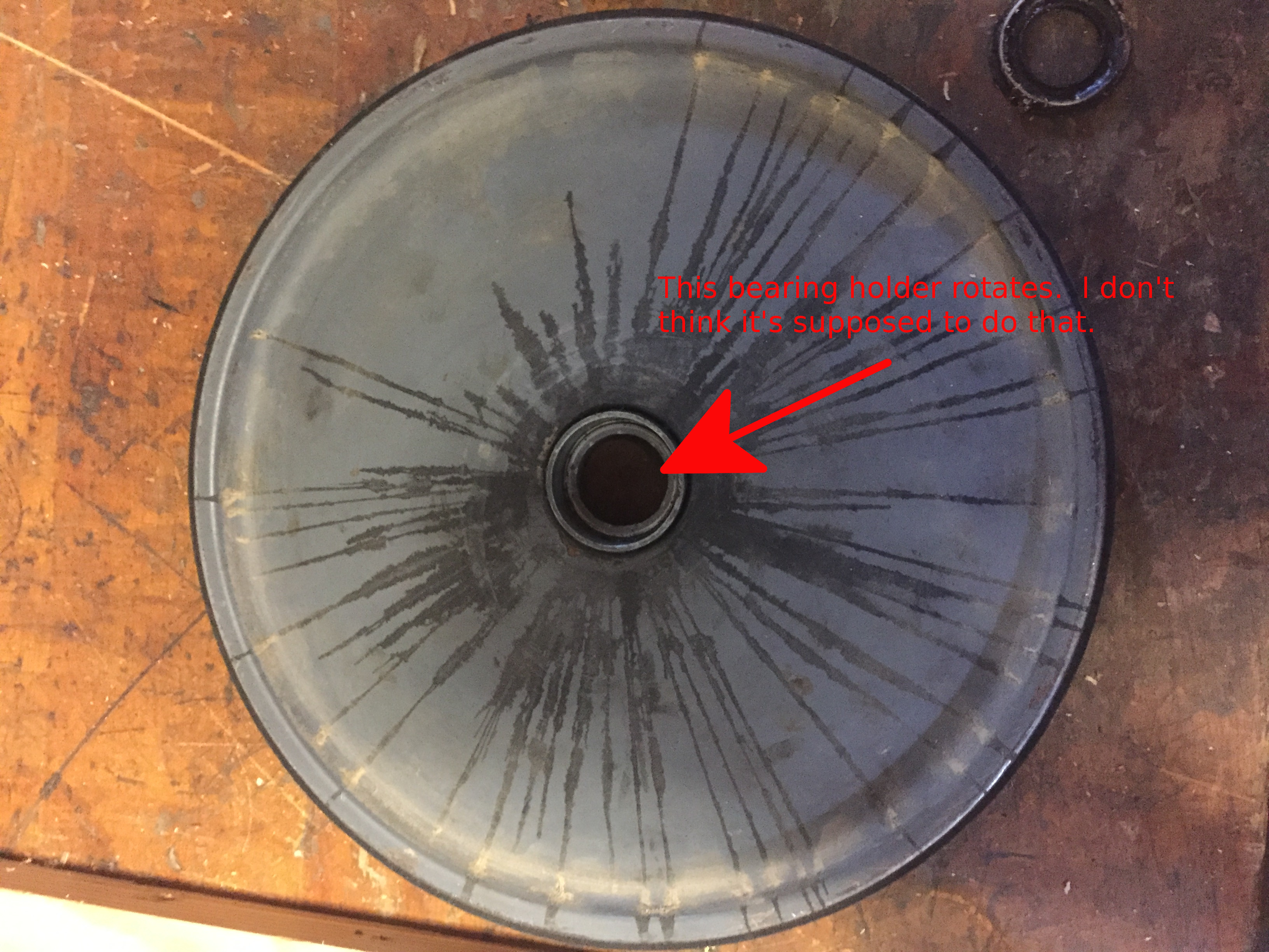

John Wright Posted November 3, 2016 Report Posted November 3, 2016 I recently found a pretty nice (at least I thought it was) Delta 785 10" Bandsaw. Got it home and took a closer look. Missing the upper blade guard assemble which I found over on OWWM. Removed the upper wheel due to awful sounds from bearings (I thought it was bearings). Bearings are bicycle type so I am rebuilding them, but that's not the problem. The wheel seems broken??? By that I mean the outer tin shell rotates on the bearing housing. I don't think its supposed to do that. You can see the problem in the photo. The bearing housing is not connected to the wheel. Soo, any ideas on how to repair that problem? Miataguy 1 Quote
Cal Posted November 4, 2016 Report Posted November 4, 2016 What does the flip side of the wheel look like? Is there a bushing or race missing? Can't imagine it worked very well like that!!! Cal Quote
Stick486 Posted November 4, 2016 Report Posted November 4, 2016 oversized race pressed in... Miataguy 1 Quote
Grandpadave52 Posted November 4, 2016 Report Posted November 4, 2016 John, can you remove the inner race from the "tin" shield/ carrier? If so, pictures of it removed as well as pictures of the opposite side would be beneficial. I've used a center punch to peen ID of race carrier, thus disrupting or displacing metal to reduce diameter, then used Loctite 660 Bearing & Race Adhesive to fully secure; assuming of course bore ID is not so enlarged and condition of your bearing race. This Link might help describe that process a little better. Quote
Stick486 Posted November 4, 2016 Report Posted November 4, 2016 (edited) A jiffy ring or a speedy sleeve may be the answer,,, http://usatolerancerings.com/index.php?page=more-information http://www.skf.com/us/products/vehicle-aftermarket/heavy-duty/specialty-parts-and-programs/speedi-sleeve-shaft-repair-kits/index.html get a hold of Precision Bearing.... they use to have all the answers to questions you never asked... Edited November 4, 2016 by Stick486 Quote

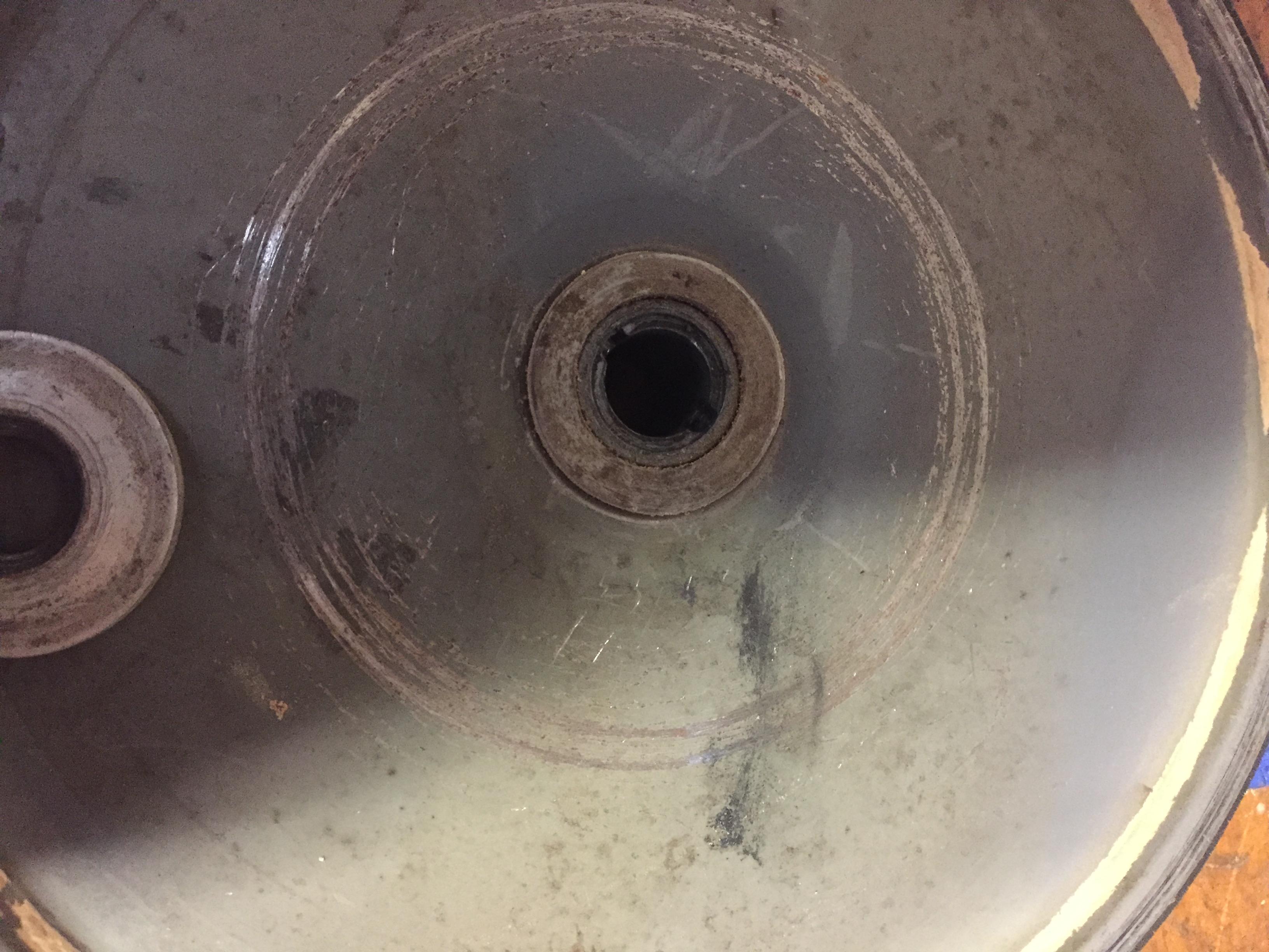

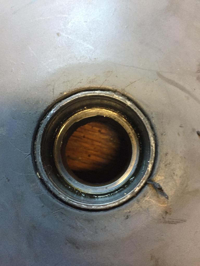

John Wright Posted November 4, 2016 Author Report Posted November 4, 2016 (edited) Ok, I am attaching photos of the reverse side of the wheel. The inner race will not come out. I have included a video of the inner race rotating inside the outer tin wheel if that helps at all. 2016-11-04 08.53.20.mov Edited November 4, 2016 by John Wright Quote
Stick486 Posted November 4, 2016 Report Posted November 4, 2016 find your replacement/repair pieces... slit the race at 120° interval and pull the old one out in pieces.. Dremel and a cut off wheel is your weapon of choice.. Quote
Grandpadave52 Posted November 4, 2016 Report Posted November 4, 2016 John, Thanks for the video and extra pics...helped a little...that race has to come out some fashion from one direction or another...I suspect the wheel has formed a ridge or burr from spinning on the race... Interesting enough in the archive forums here, John Buskirk dealt with a similar issue during a 785 Restore he documented... Take a look Here and see if this helps any...keep asking questions & posting where you're at...more eyes & heads on this might help. Quote

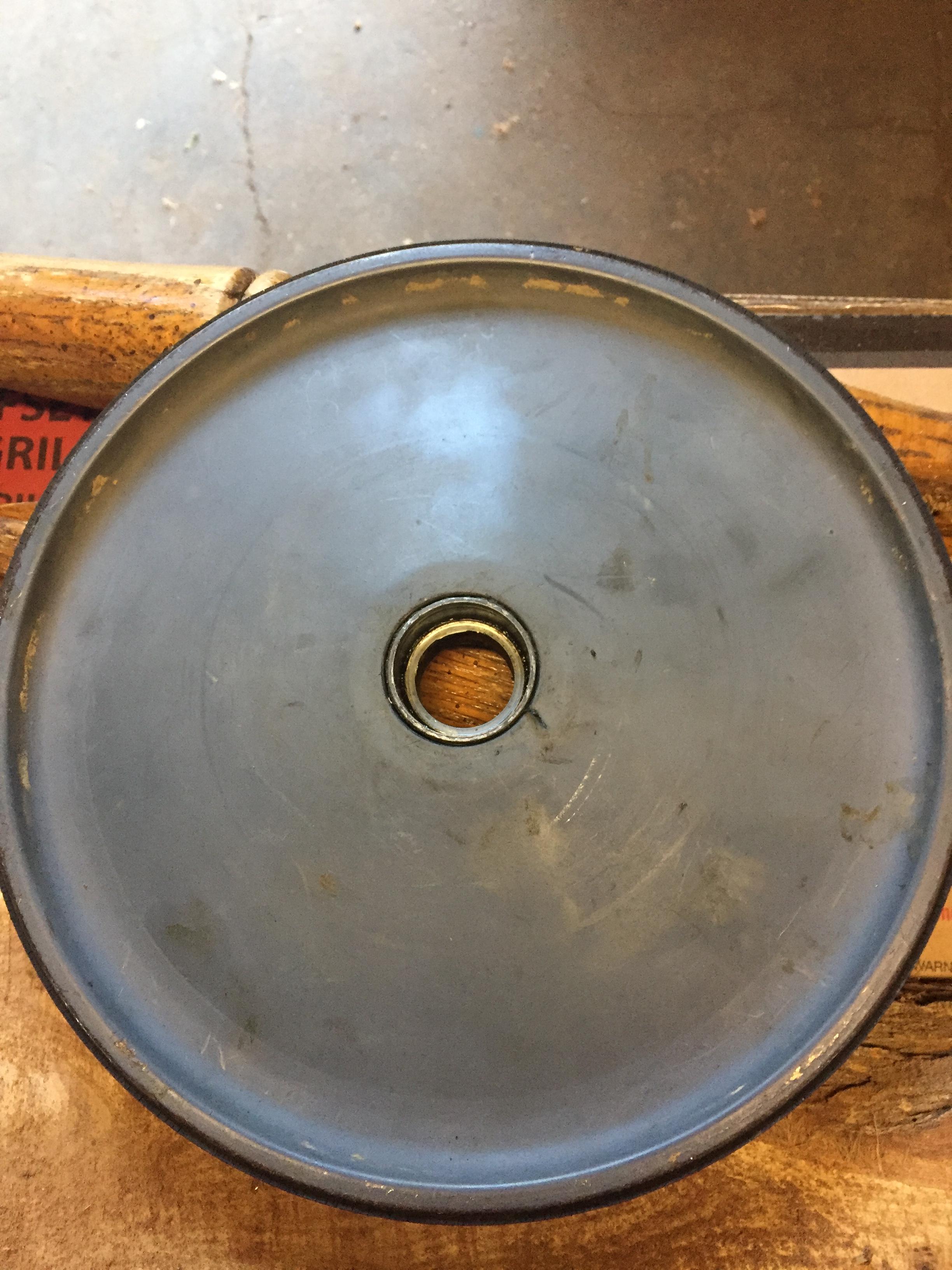

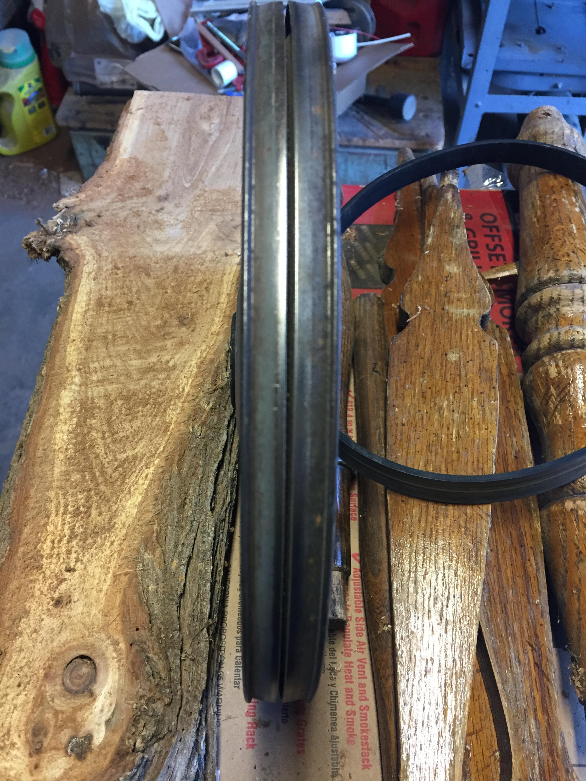

John Wright Posted November 5, 2016 Author Report Posted November 5, 2016 I took the lower wheel off. Its pretty flimsey construction. The wheel is in two pieces. See photo below. The tire wasn't glued on so it just came off revealing the two part wheel. My thought is the outer tin shells were somehow pressed on the race. Through the years the bearing wore out and froze on the shaft. The wheel then kept turning breaking the tin/race seal. My thoughts now are to try and braze them together or maybe rivit the shells to the race somehow. I have a friend who is a machinist, I will take this over tomorrow to get his thoughts on how to fix it. Here's the lower wheel race. By the way, the lower shaft is not original. The original shaft was one diameter all the way through. Mine has been turned down. The original used bicycle bearings, mine has regular ball bearings, so my thought is that there has been a mod much like Larry did on his 785 a few years ago. Here's the shaft. Here's the lower wheel. This is the side toward the body of the saw. So we shall see what my friend says tomorrow. Cal and Grandpadave52 2 Quote
Grandpadave52 Posted November 5, 2016 Report Posted November 5, 2016 That makes more sense now John seeing the bottom wheel. I think you've hit it on the head so to speak what happened to the top. best I could tell the original was not a sealed bearing of any type since a "grease/dust" seal was used. Pulley's such as these were (are) used quite commonly on farm & L&G equipment...each half pressed onto a bearing outer race, then the halves riveted or spot welded together. Of course they use sealed,ball bearings today. Your friend might be able to get the remains out w/o further damage to the wheel ID and possible match up a ball bearing. I'm still confused why this wheel needs a bearing versus a hub if the top shaft rotates. I'm probably missing something; just trying to get it in my head. I see the drive lug/pin in the bottom shaft to drive that wheel. Is the top shaft fixed with the wheel rotating on the shaft? From the parts schematic, it appears the top wheel spins with the shaft?? I appreciate your interaction on this...find it interesting & challenging trying to get this oldie up & running again. Quote

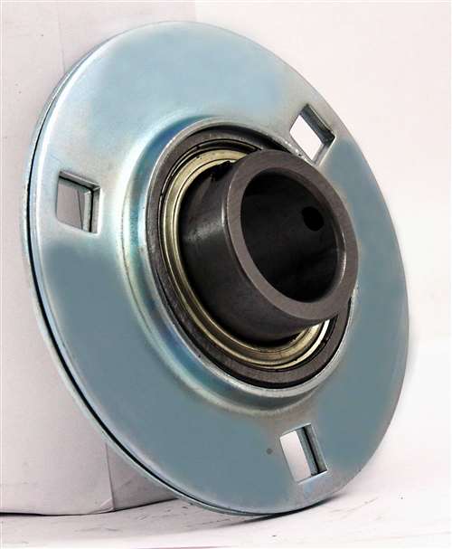

Grandpadave52 Posted November 5, 2016 Report Posted November 5, 2016 7 minutes ago, John Wright said: Ahh, now I understand the confusion. The shaft does not rotate. The wheel rotates on the shaft which is attached to the tension blade tension device. So the race contains the bearings. The race is stationary to the wheel and the bearings rotate on the shaft. Like the front wheel of a bicycle. Got it......makes complete sense and must be an older model / type from the parts list I found... One option might be getting something like this and either welding flanges in place with the bearing in place or possibly drilling and bolting to existing wheel center...would add some weight and would need to try and balance (which wouldn't be that difficult for no faster than this turns)...biggest trick would be getting concentric to wheel OD with little run-out...should be able to match bearing ID to shaft OD...would not need the extended race type with shaft lock collar...just thinking out load here... Quote

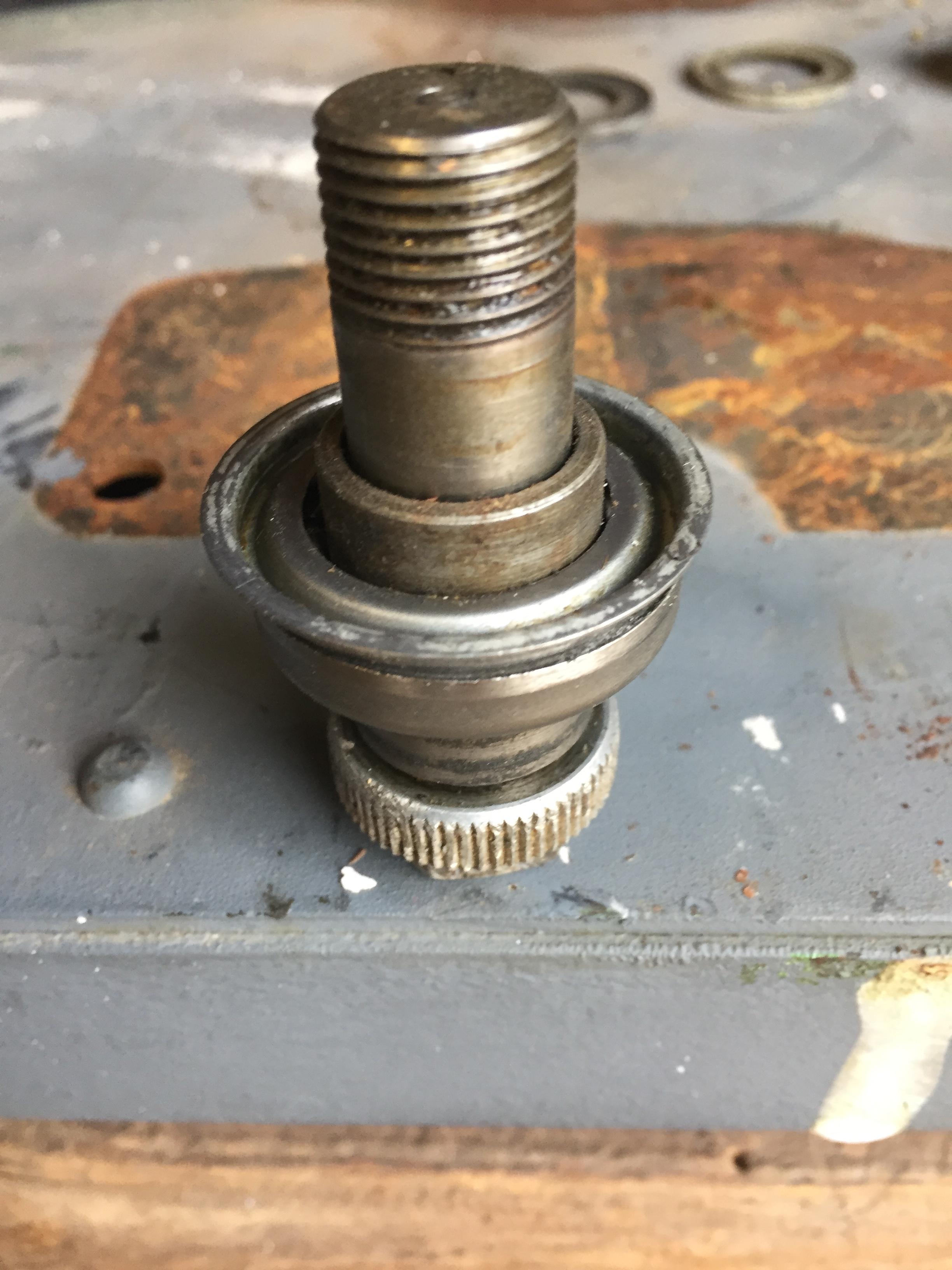

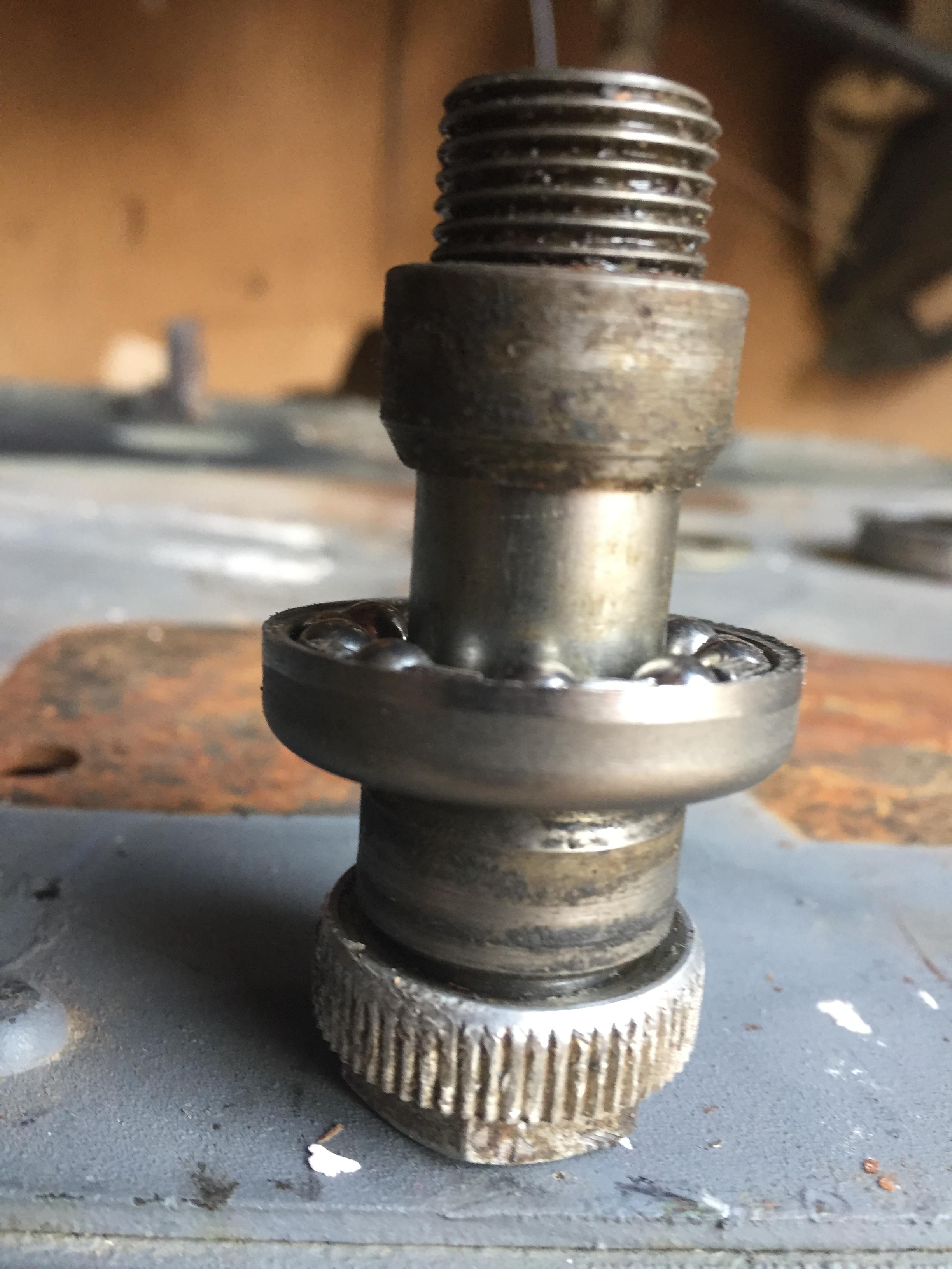

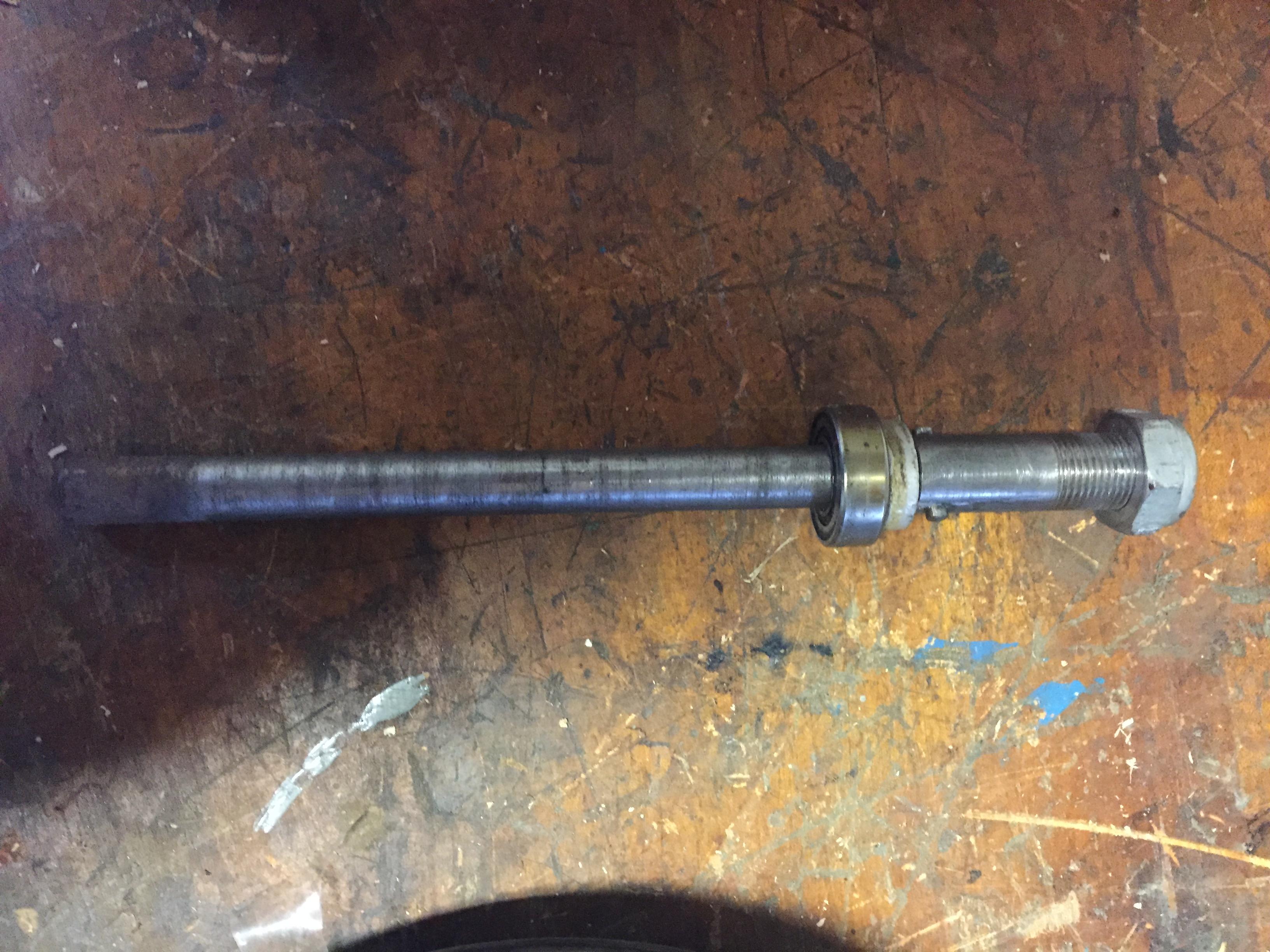

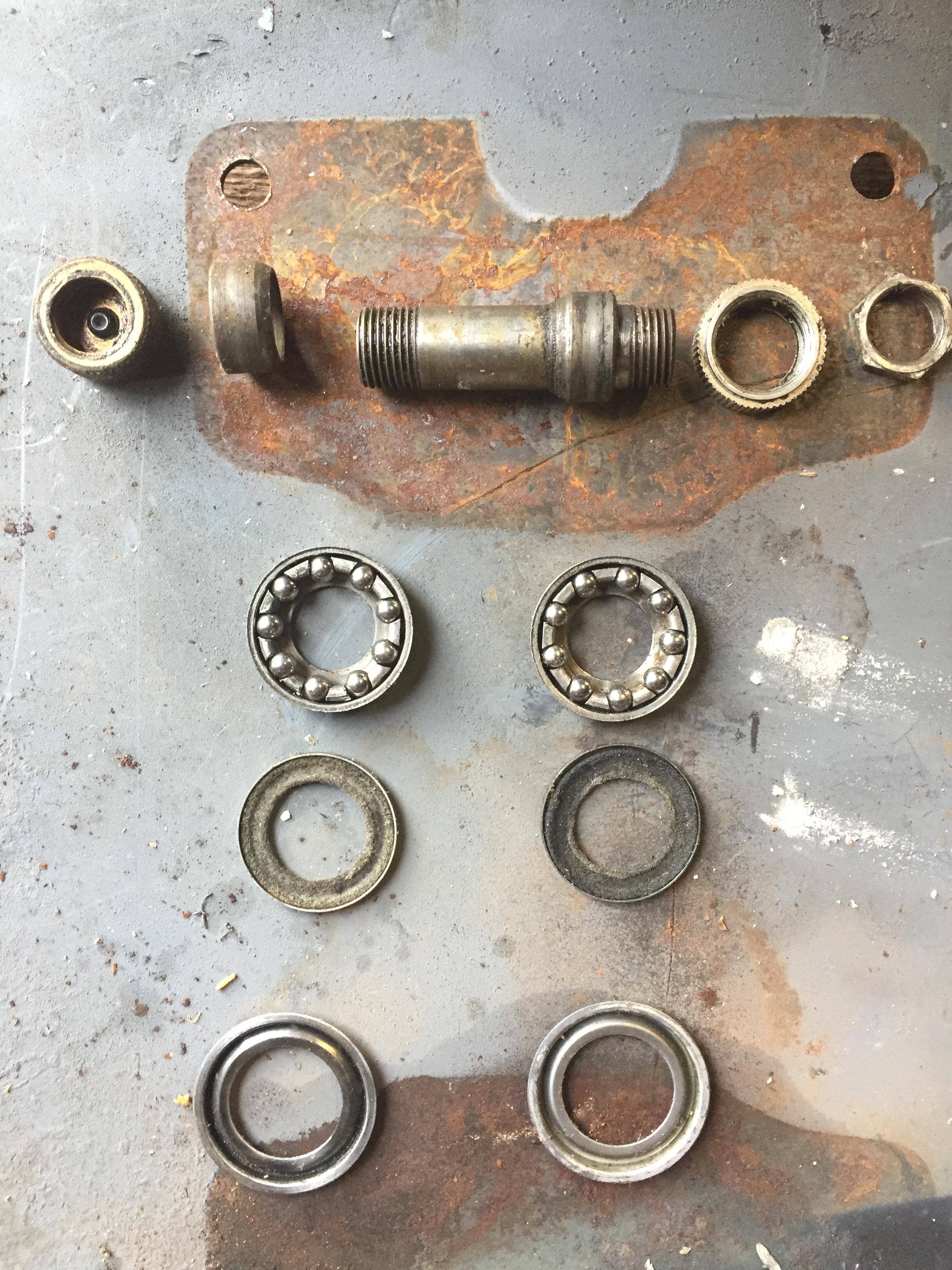

John Wright Posted November 16, 2016 Author Report Posted November 16, 2016 (edited) Grandpadave, Ok, took some photos today. Here they are. This is the axle assembly on top and the bicycle bearings below. Notice the "swedge" type shoulder on the axel and the swedge type fitting that slides on the axel. Here is the outer bearing on the axel assemble. Note the "cup" arrangement the bearing sits in. The swedge then presses against the bearings. There is a caution in the owner manual to use caution not to over tighten the nut that puts tension on the wheel/bearing assemble. It should only be tightened enough to prevent side to side slip. I think what happened is it was over tightened and the wheel was torqued off the race as a result. Here's the swedge assemble inserted into the bearing. Note the dust cover on top of the bearing. This fits on the wheel and over the bearing. Hope this helps you vision how things go together. Edited November 16, 2016 by John Wright Spelling correction Miataguy 1 Quote
