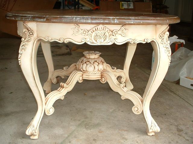

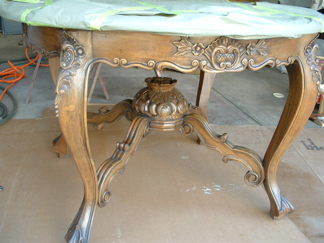

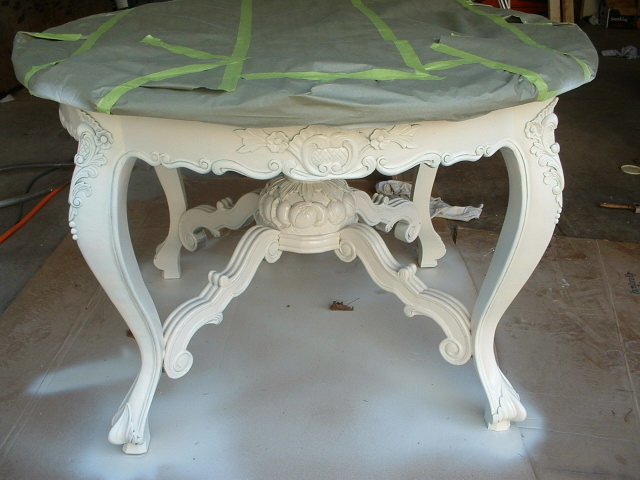

November 6, 201610 yr comment_82989 Not my taste but one of my (retail) customers was trying to get rid of old inventory and I had to change the base to one of the options offered by that mfr. Before image: Edited November 6, 201610 yr by kmealy Report
