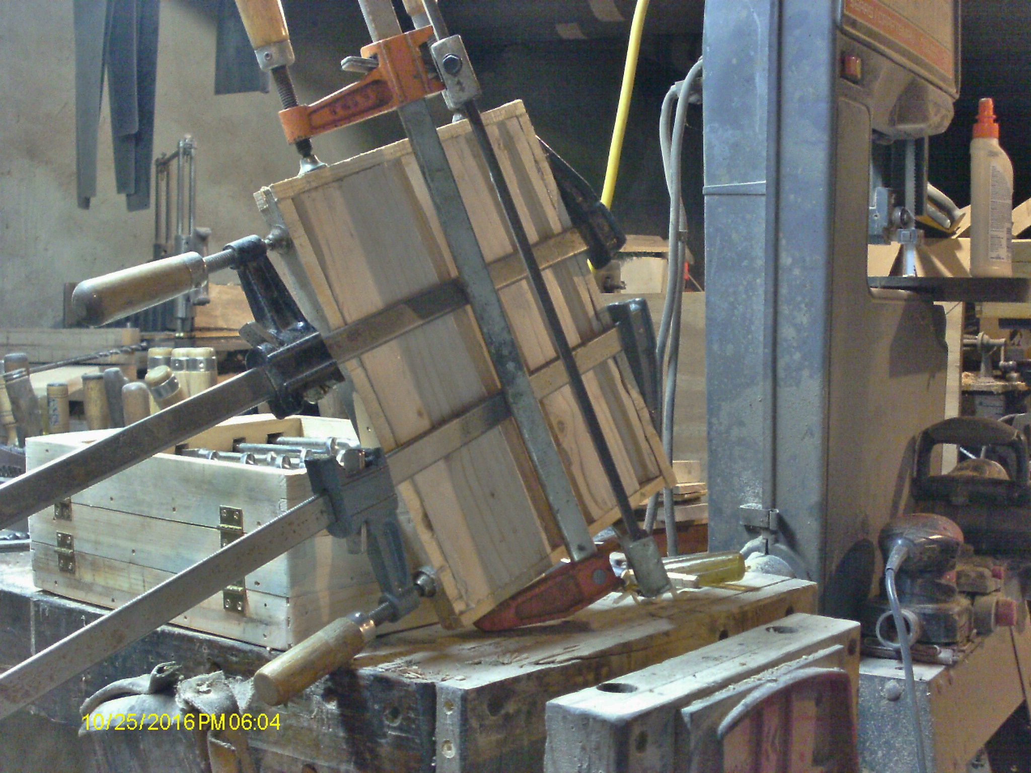

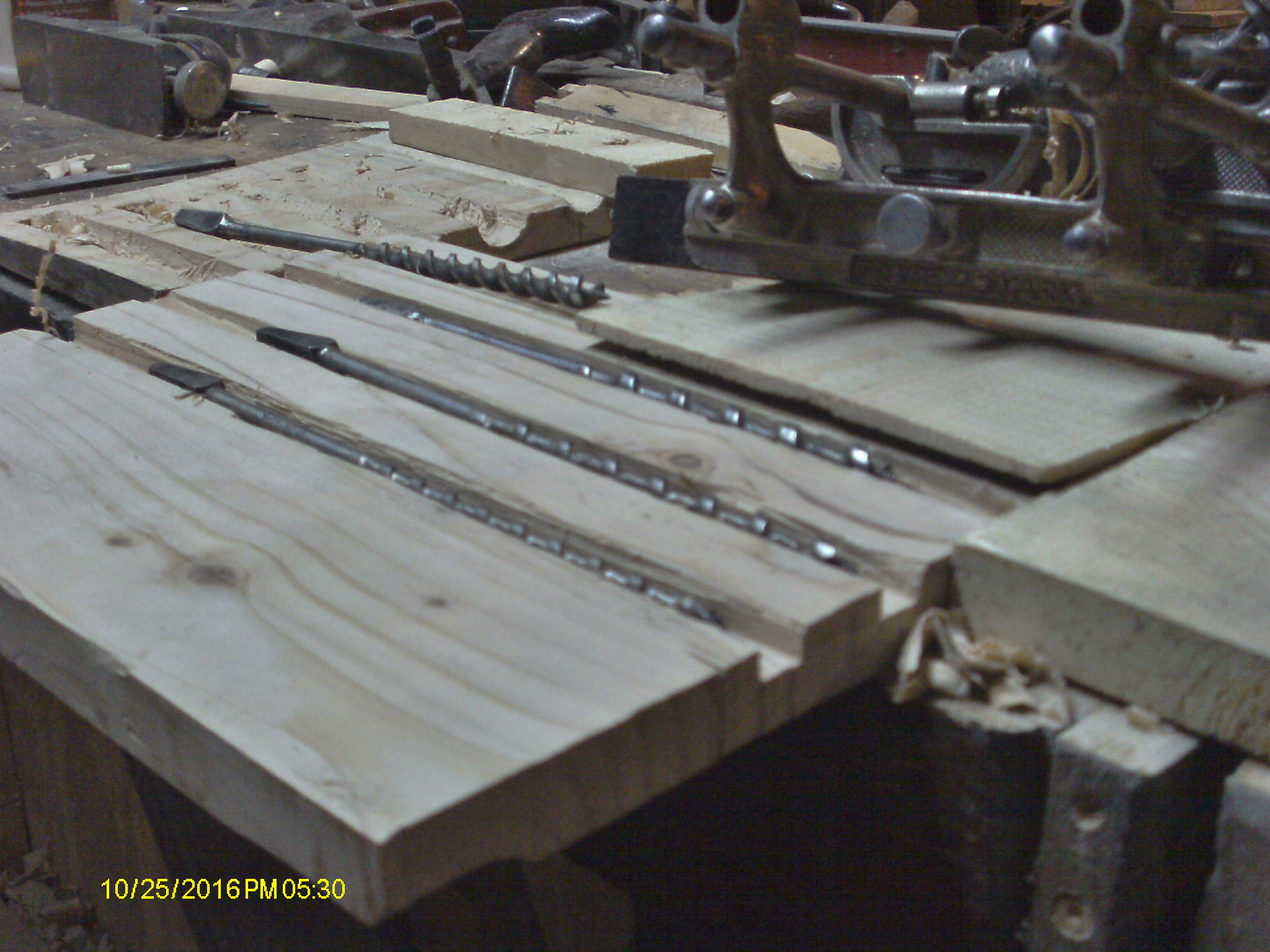

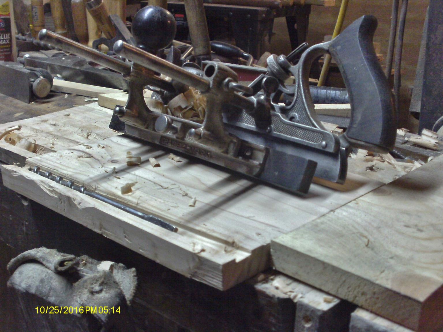

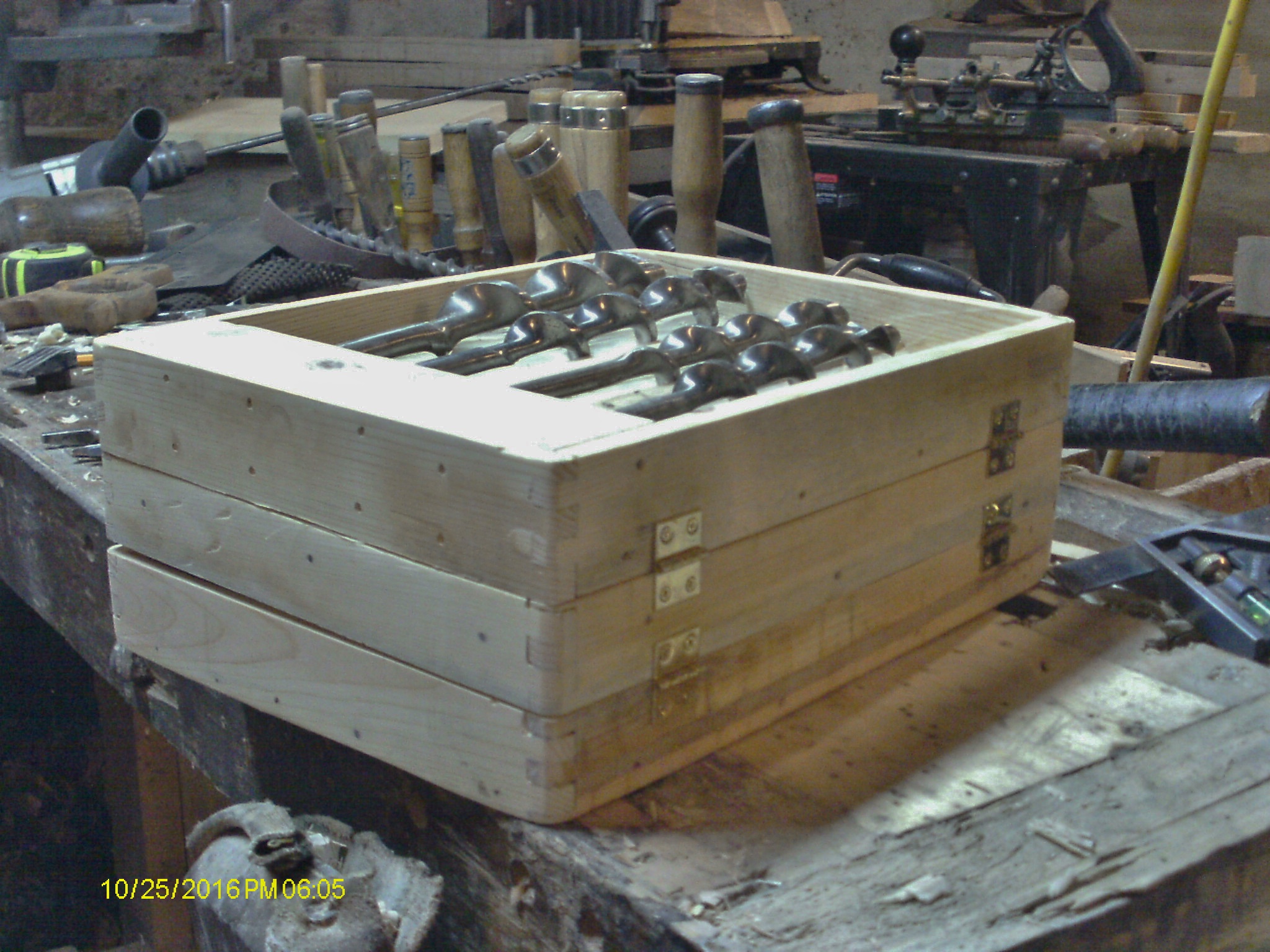

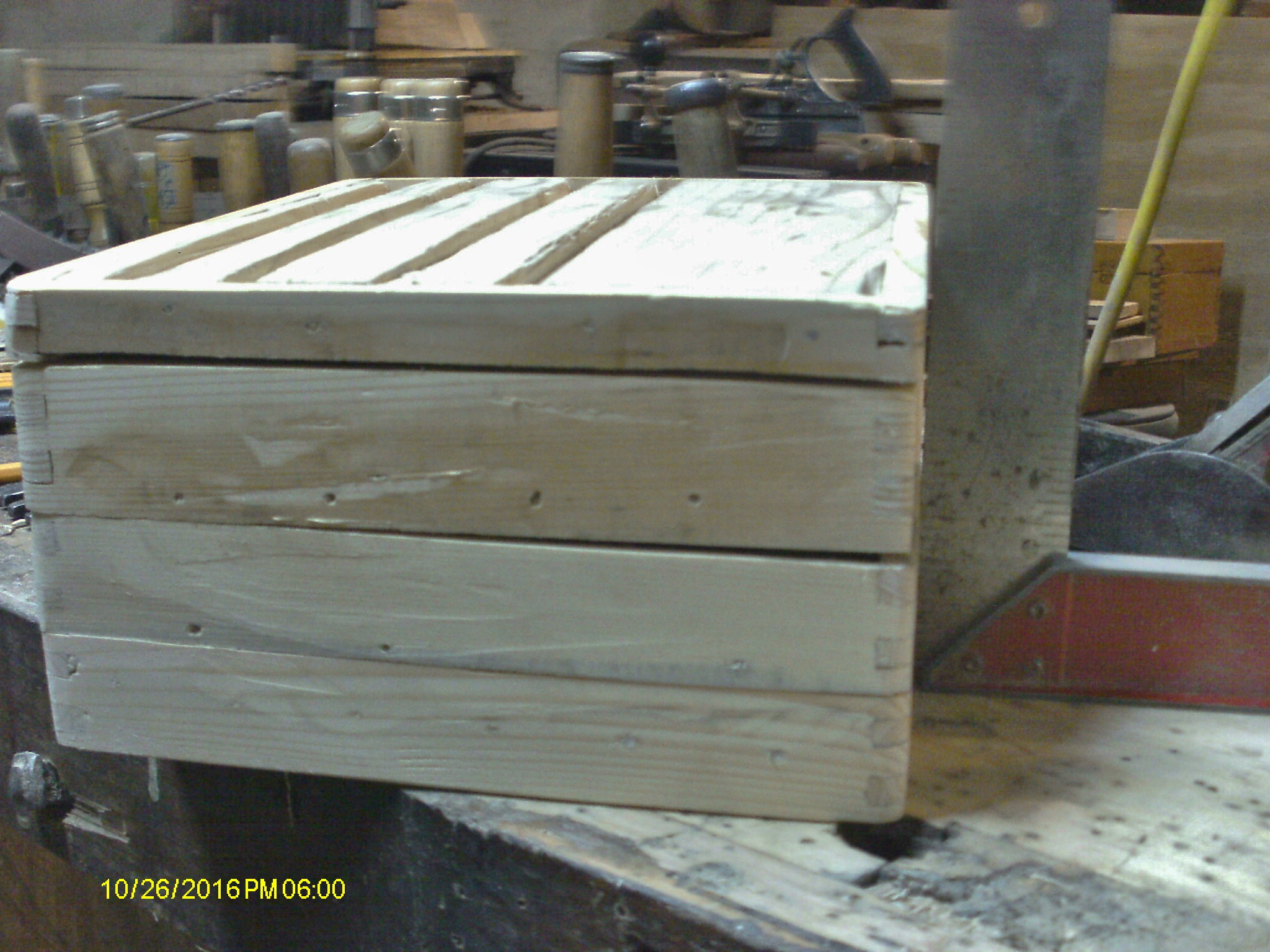

October 25, 201610 yr comment_80661 Well...Mister Gumption finally caught up to me, there goes playing hooky for tonight. Had a few more grooves to mill.. Fought the grain on both of these....as for the third groove.. It was getting to be a bit of a stretch, so I dug out the cam rest, and gave it a test drive, too. The last two? I had to turn the blank 180 degrees, and come in from the other side.. The grain was a lot better to work with. Made that groove with just a single setting. Groove #5 soon followed. Time to make a holder for the shanks to sit in.. Marked out where each bit was, bandsaw to make a bunch of cuts. Chisel to knock out the waste, and pare things smooth. Test fit on the holder end.. Something like this. I could also mark where to cut the outside pieces at, and then give them a test fit... So I could see what needed trimmed where. Glue & nails, might as well get the glue up started.. Glue and nails, and a few clamps. Kept working my way around, had to trim a few places. Then a forest of clamps... Begining to think I should have done the first two this way......might have been a little easier? Tried out the bits.. Seems to look a little better? Still have enough pieces to make the fourth page... But....I think it can wait a day. Will need to change the cutter in the Stanley 45, first. The blank needs to be flattened out. Scrub plane then a smooth plane for that. Both faces. Yep, it can wait a day or so. Stay tune to this Batty Channel.....same Bat Time. Report

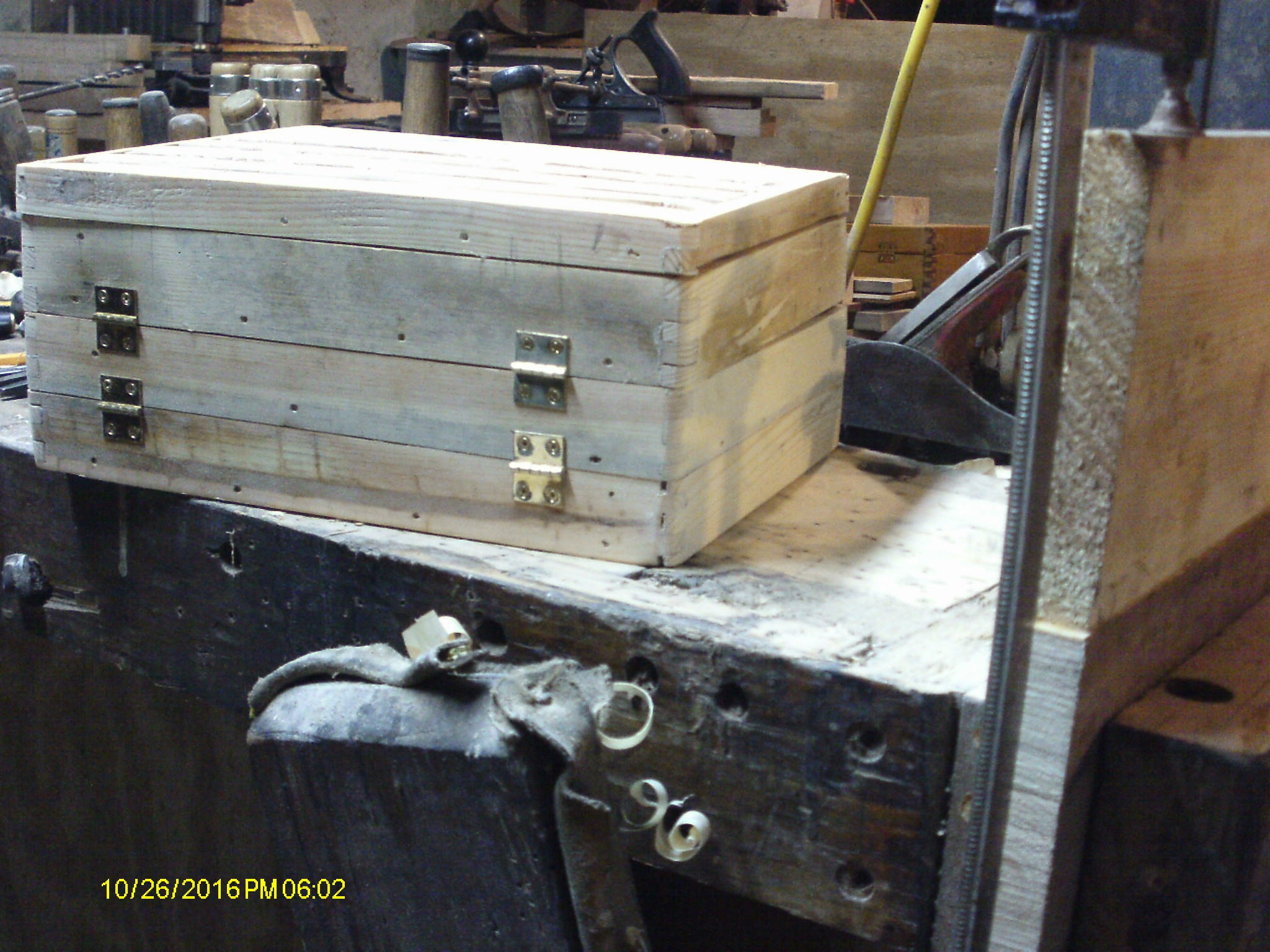

October 25, 201610 yr Author comment_80770 Having a very hard time, finding latches for this box. Would like to find ones like R. Jennings used on theirs.......striking out, so far, BORG? Nope. Lee Valley? Nope.....Hobby Lobby? Nope.....what do I need to look them up as ? Have the hinges, need the latches for out in front.... I doubt IF small brass hook & eye would do the job...... Edited October 25, 201610 yr by steven newman Report
October 25, 201610 yr comment_80773 How about a hasp? Find a couple the right length and lock all 3 leaves at once. Report
October 25, 201610 yr comment_80774 1 hour ago, steven newman said: Having a very hard time, finding latches for this box. Would like to find ones like R. Jennings used on theirs.......striking out, so far, BORG? Nope. Lee Valley? Nope.....Hobby Lobby? Nope.....what do I need to look them up as ? Have the hinges, need the latches for out in front.... I doubt IF small brass hook & eye would do the job...... Try Ebay, Steve might find some old ones too, but they have good prices on "Buy it now" new too. Another search for Trunk hardware, lots of replica stuff on those sites. Herb Herb Edited October 25, 201610 yr by Dadio Report
October 25, 201610 yr comment_80778 @steven newman, latches. Here is an interesting site too ,lots of old stuff here:https://www.etsy.com/market/box_latch Report

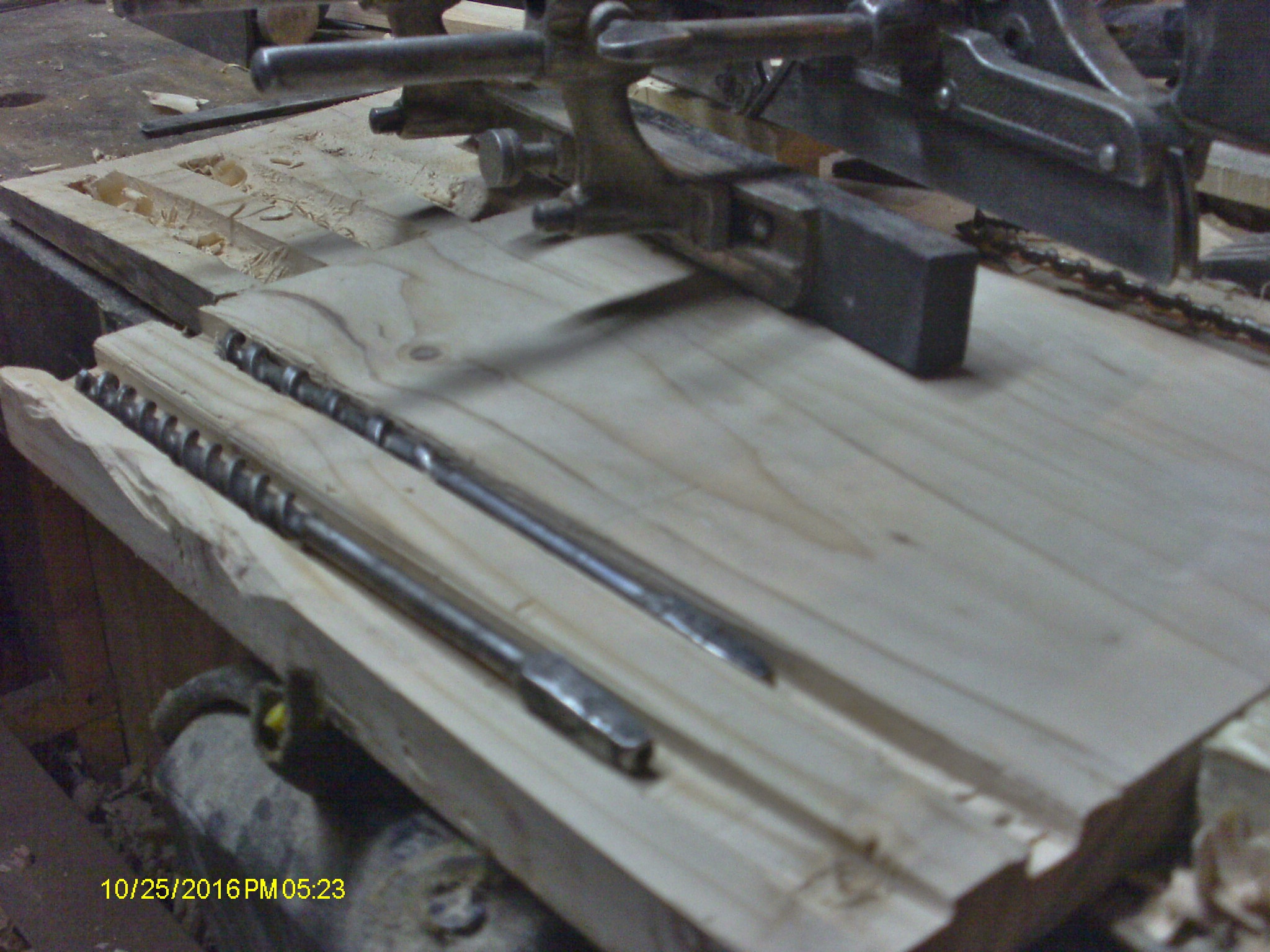

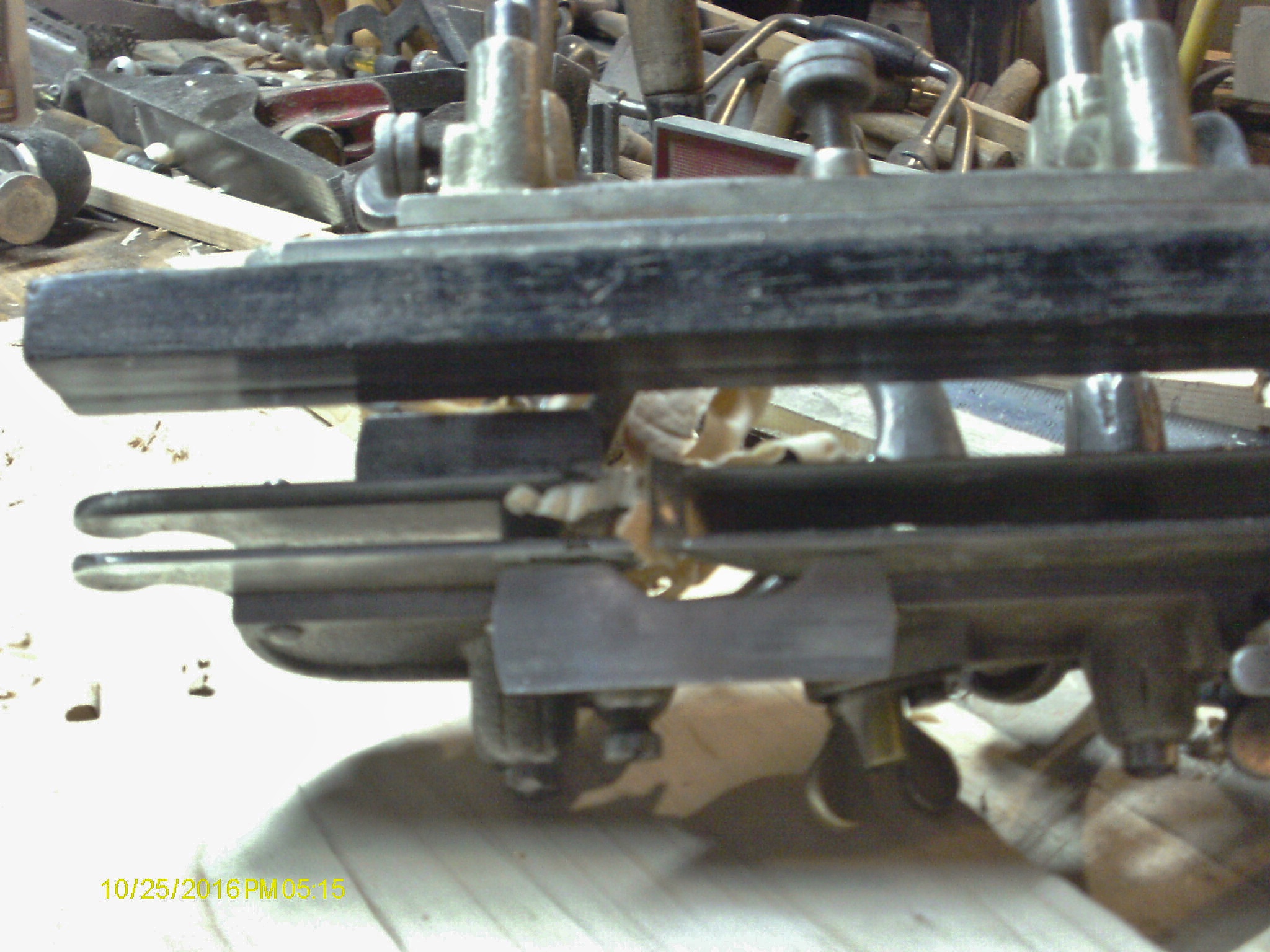

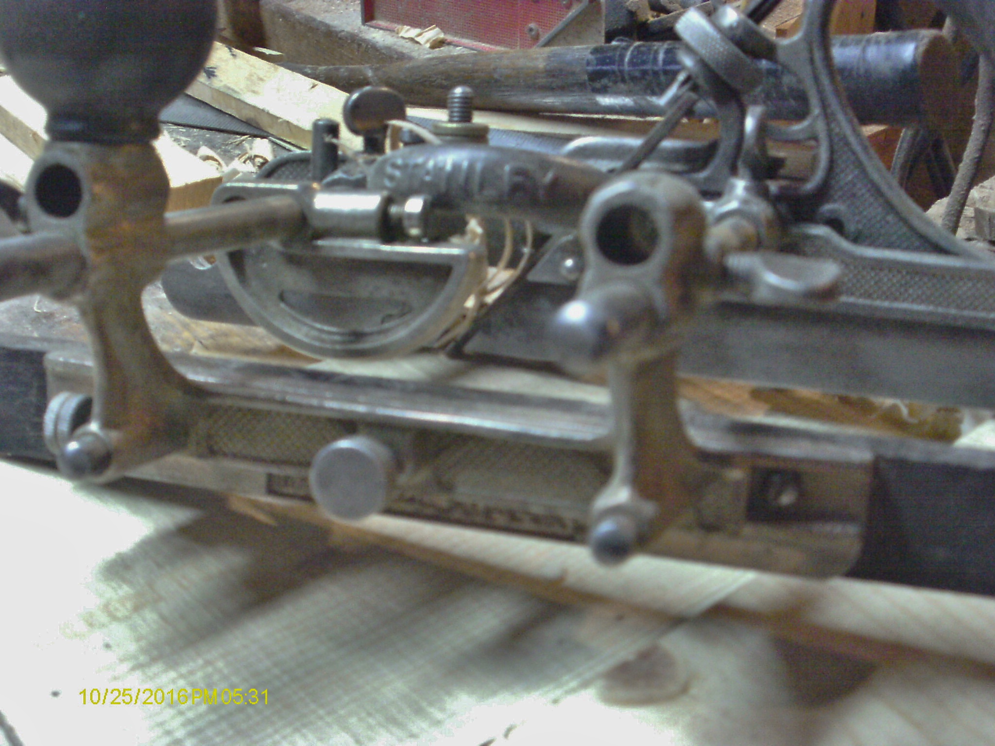

October 25, 201610 yr Author comment_80781 I'll do a bit of shopping later this week..... Right now, I needed to get "page 4" done. I found out I needed to cut a channel into the under side of the blank. So, after cutting the blank to a somewhat final size, and flattenning one face, I used that Stanley #45 as a hollow cutter. Test fits until almost good enough. Didn't want to go too thin. That #20 auger bit IS HUGE! Ok, I then flattened the other face, and a bit of jointing on the edge grain.. Been having issues with the bench dogs,,,,about time to make new ones ( might be the next shop project?) Have enough scrap pieces sitting around, doing nothing anyway. Added a few to the bench... I switched out bits to make a square groove.. I had to use the depth stops for this cutter. Skates would be inside the cut. A look at the scrap pile? The big square thing to the right is screwed down to the vise's jaw. I can clamp an unclamp with the vise. The other is a stop. I added a third piece, to keep things from sliding sideways. Groove is a bit rough, thanks to a knot or two in the way. 45s do not like knots. Groove #2 was a bit better...no knots.. Problem was getting these deep enough. Groove #3 ..needed the cam restback out.. And for groove #4, I rotated the blank around, and came in from the other side..... And that will do it for the grooves. There is a handful of smaller bits, I can put those into a drawer in the tool box. Set about to add the outside pieces with nails and glue.....had the remake one end piece...fingers didn't match up just right. Finally got the mess into the clamps.. As you can see....I did get some more hinges installed. Have to work on the gap-osis.....Thinking since the bottom page is bass-ackwards.....maybe turn it around. Maybe tomorrow, I can start a glue up for a lid. Plain...or..fancified? Hmmm? I think that will do for one day's work in the shop? Stay tuned.... Report

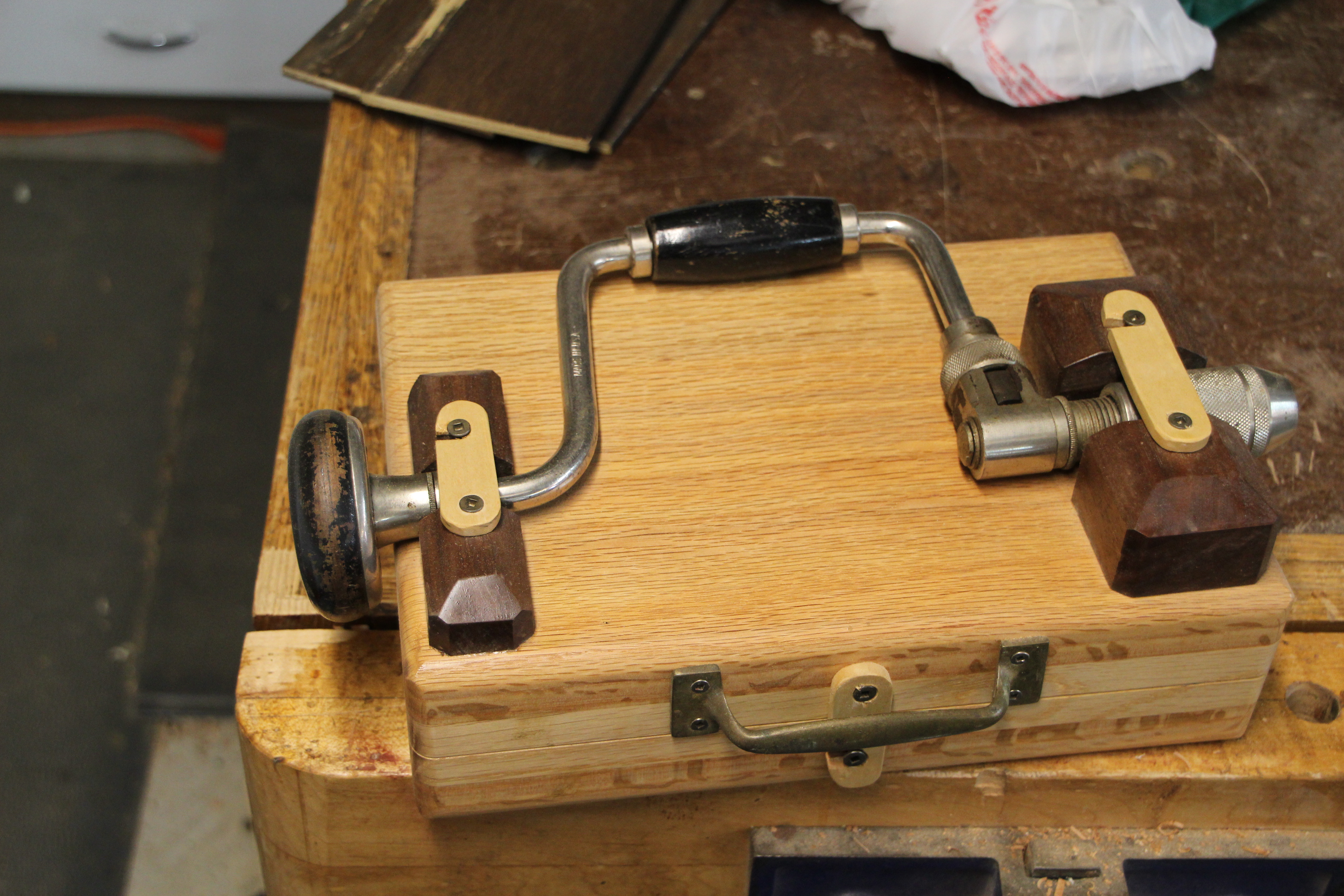

October 26, 201610 yr Popular Post comment_80801 Not the best picture , but I made my own. You cannot see the open end of the latch for the handle. It is open like a hook and snaps onto the screw. OOPS the same thing holding the brace onto the top of the box. Report
October 26, 201610 yr Author comment_80906 Maybe later today, I might sneak down to the Dungeon Shop. Have a glue up to remove from the clamps. I think I have enough pine for a lid, but will need to glue things up... Maybe use a plane to "joint" the two edges? Might go shopping for latches later this week.....prefer brass, or brass plated. Not sure about a carrying handle, yet... Report

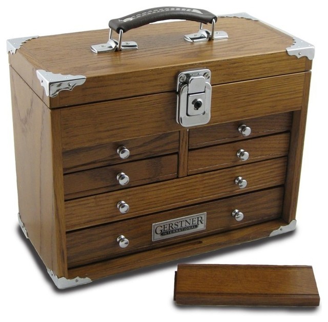

October 26, 201610 yr comment_80926 2 hours ago, steven newman said: Might go shopping for latches later this week.....prefer brass, or brass plated. Not sure about a carrying handle, yet... How about something like the carry handle on this? realize not brass, but might be able to find in brass/ plate. Take a stroll through your local Goodwill or other Thrift stores for something you might be able to re-purpose into a handle, leather or otherwise. Just a thought. Report

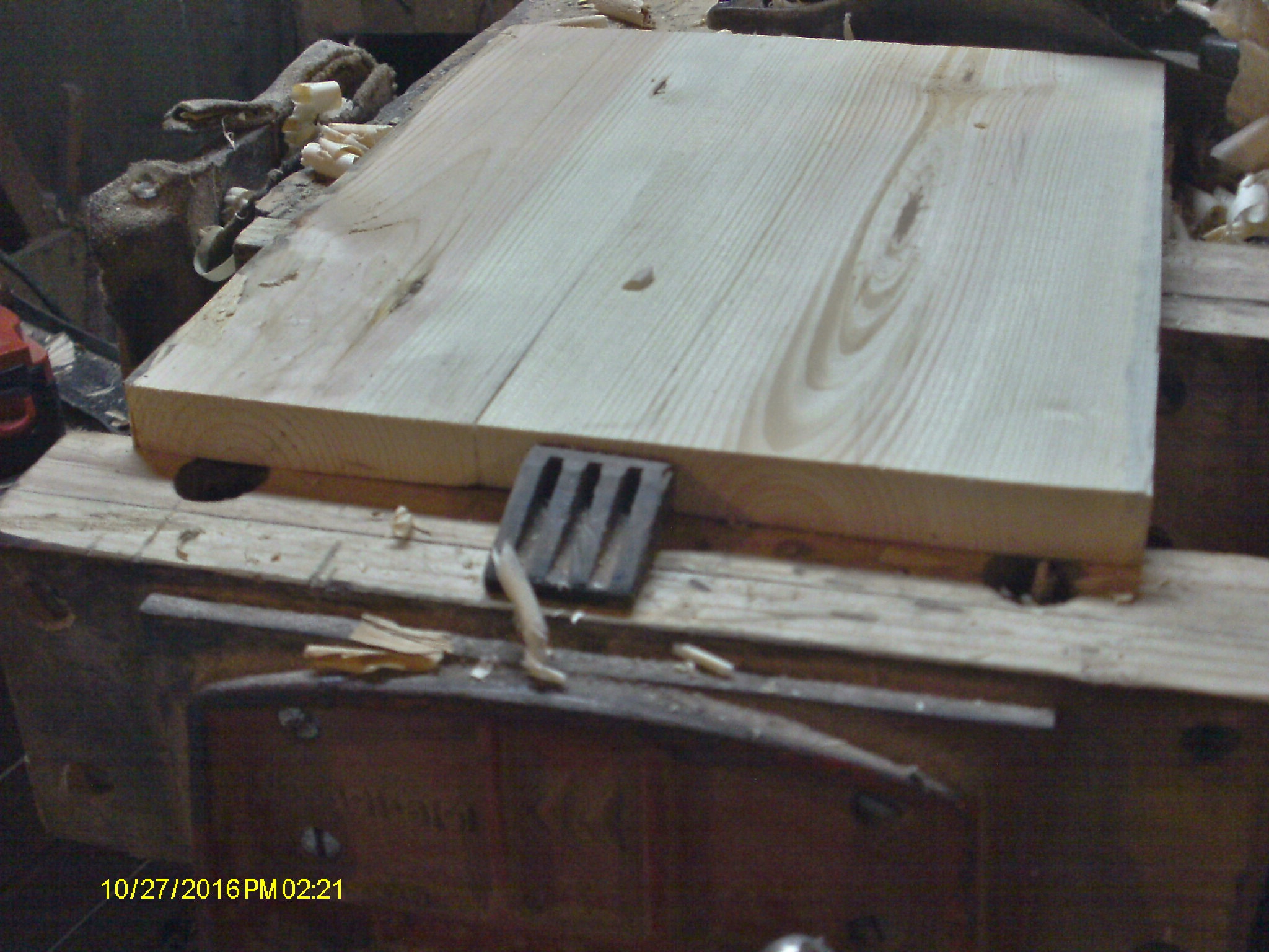

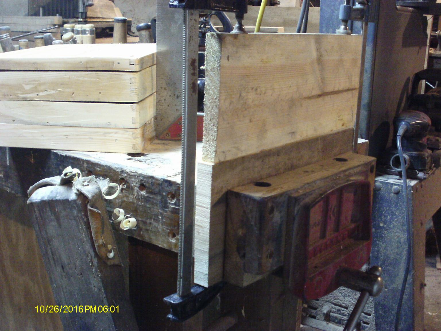

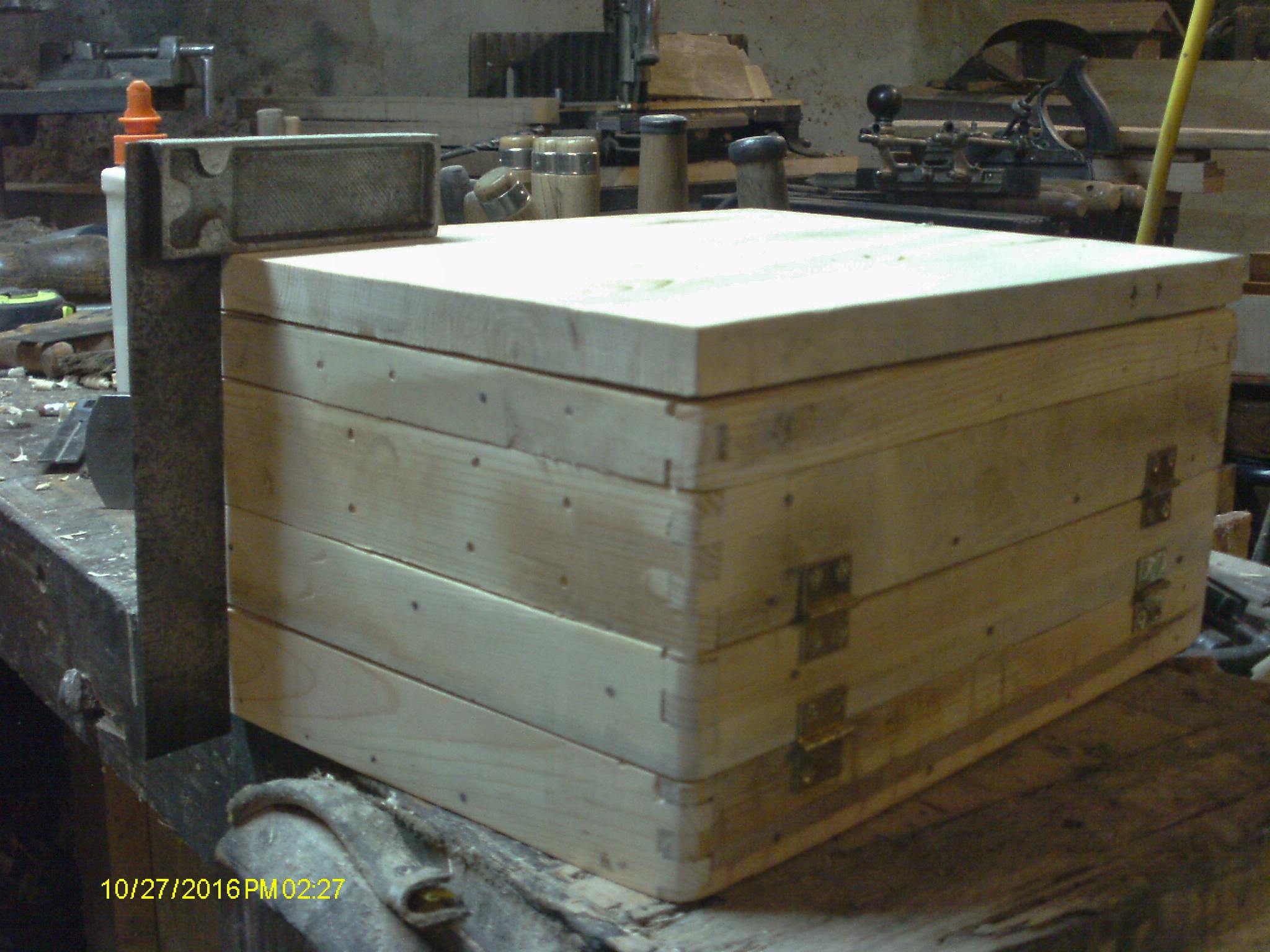

October 26, 201610 yr Author comment_80953 Couple more shots, to show what I am working with.. Not a lot room for big latches. I started with a 1 x 6 to make the outside pieces. Or, about 5-1/2" tall. I did a glue up of the lid today.. End vise makes a great set of extra hands. Will let that sit a while......need to add more hinges, too.. Maybe thenI can work on gap control? Report

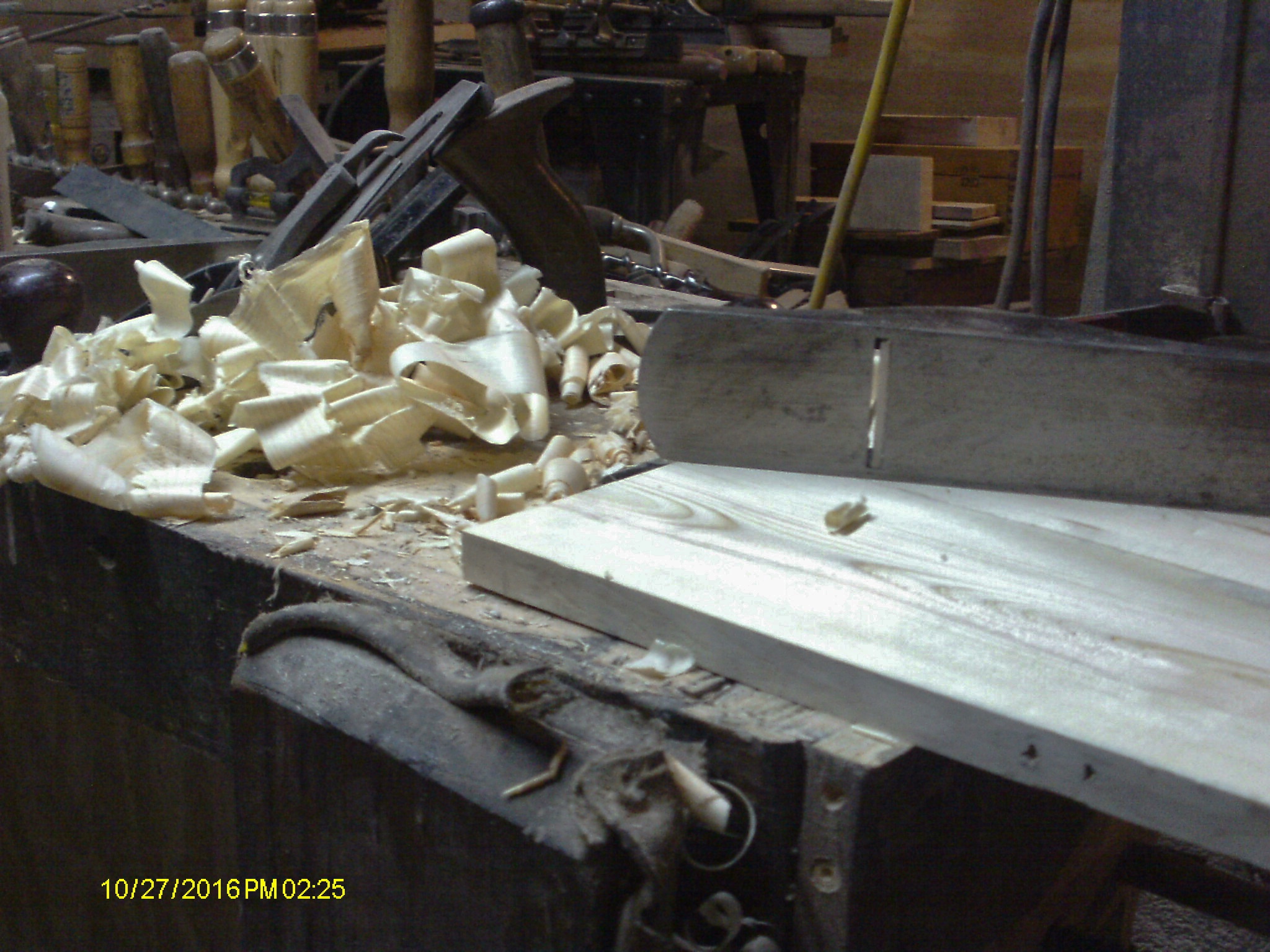

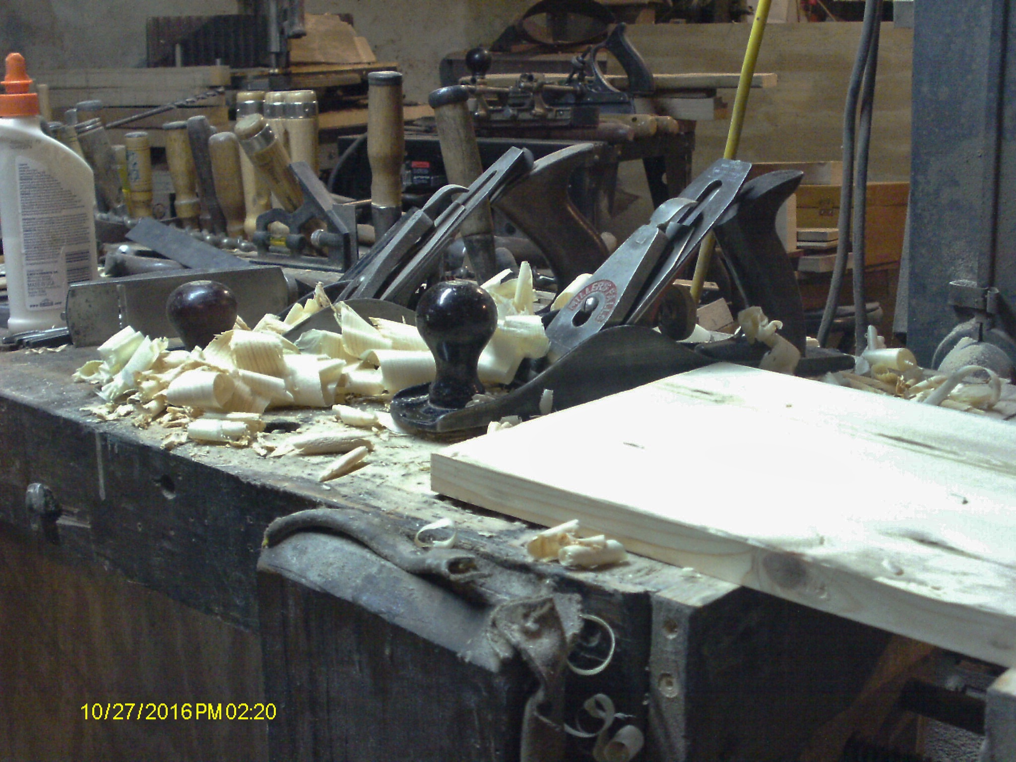

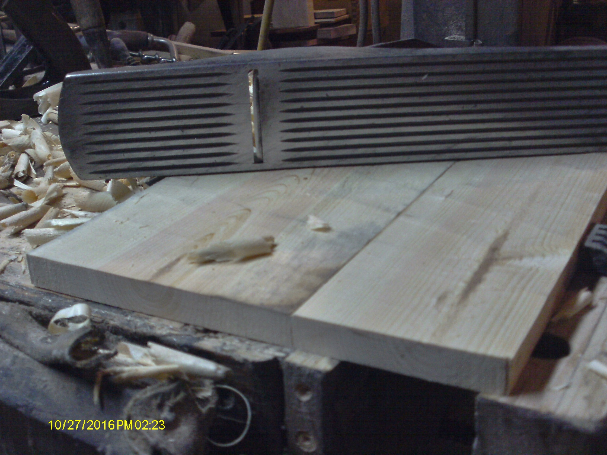

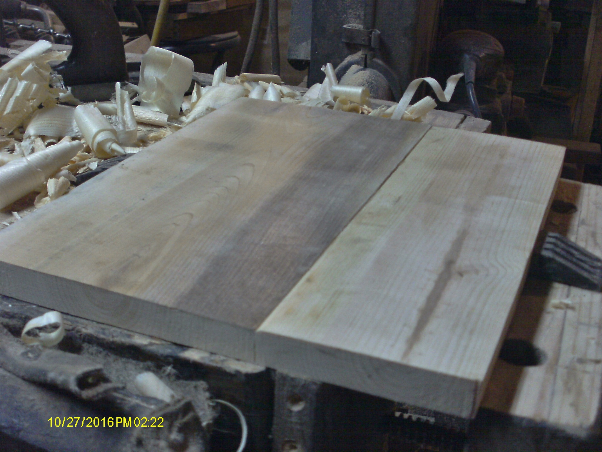

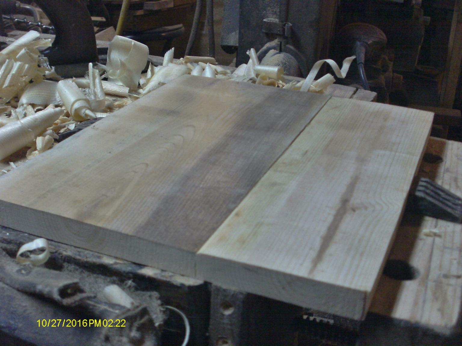

October 27, 201610 yr Author comment_81194 I had an entire post all typed out? Where DID the words go? Is this a sort of "Trick or Treat thing? Maybe I will try to do the words again......NOT. This was detailing the steps to get the blank for the lid all nice and flat. Only needed two planes. Somewhere out in cyperspace is my post........? All that was left was the pictures. Edited October 28, 201610 yr by steven newman Report
