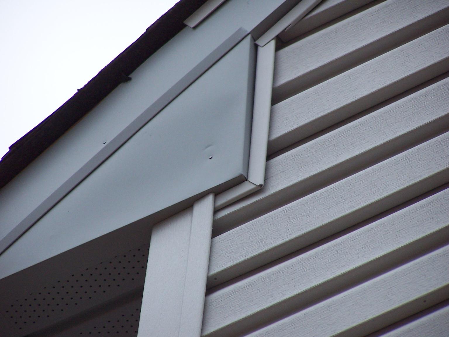

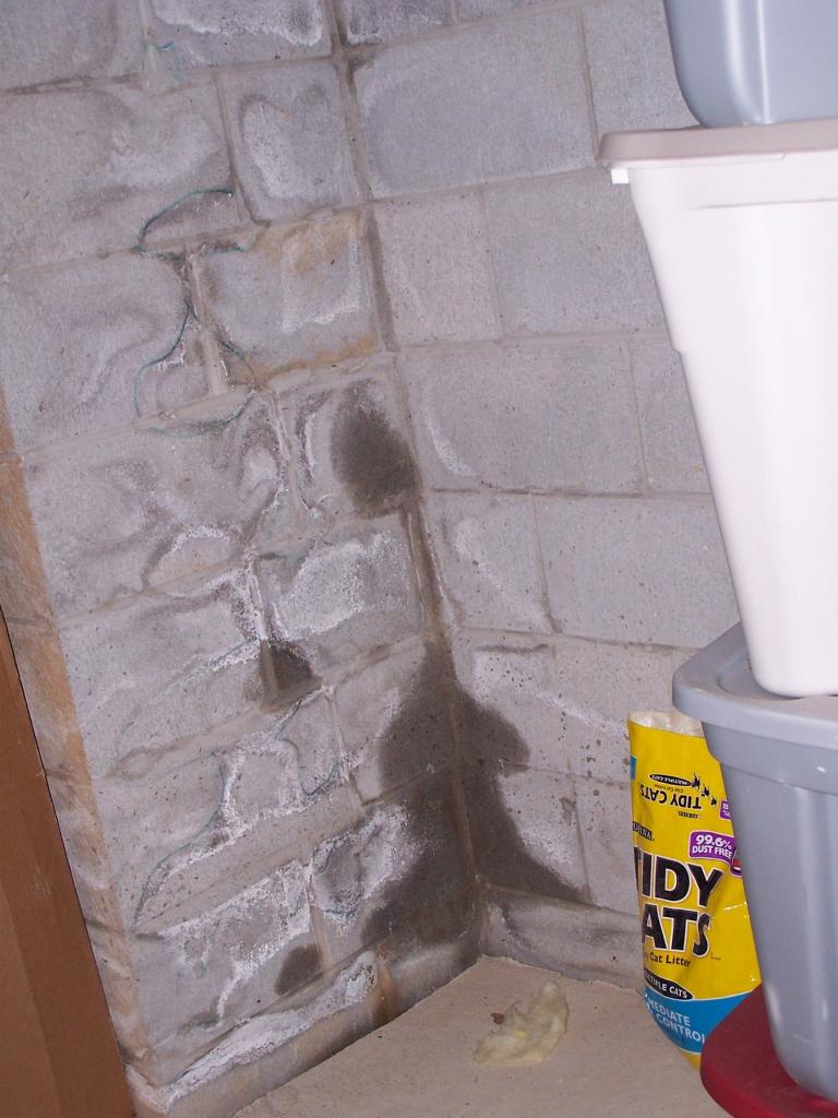

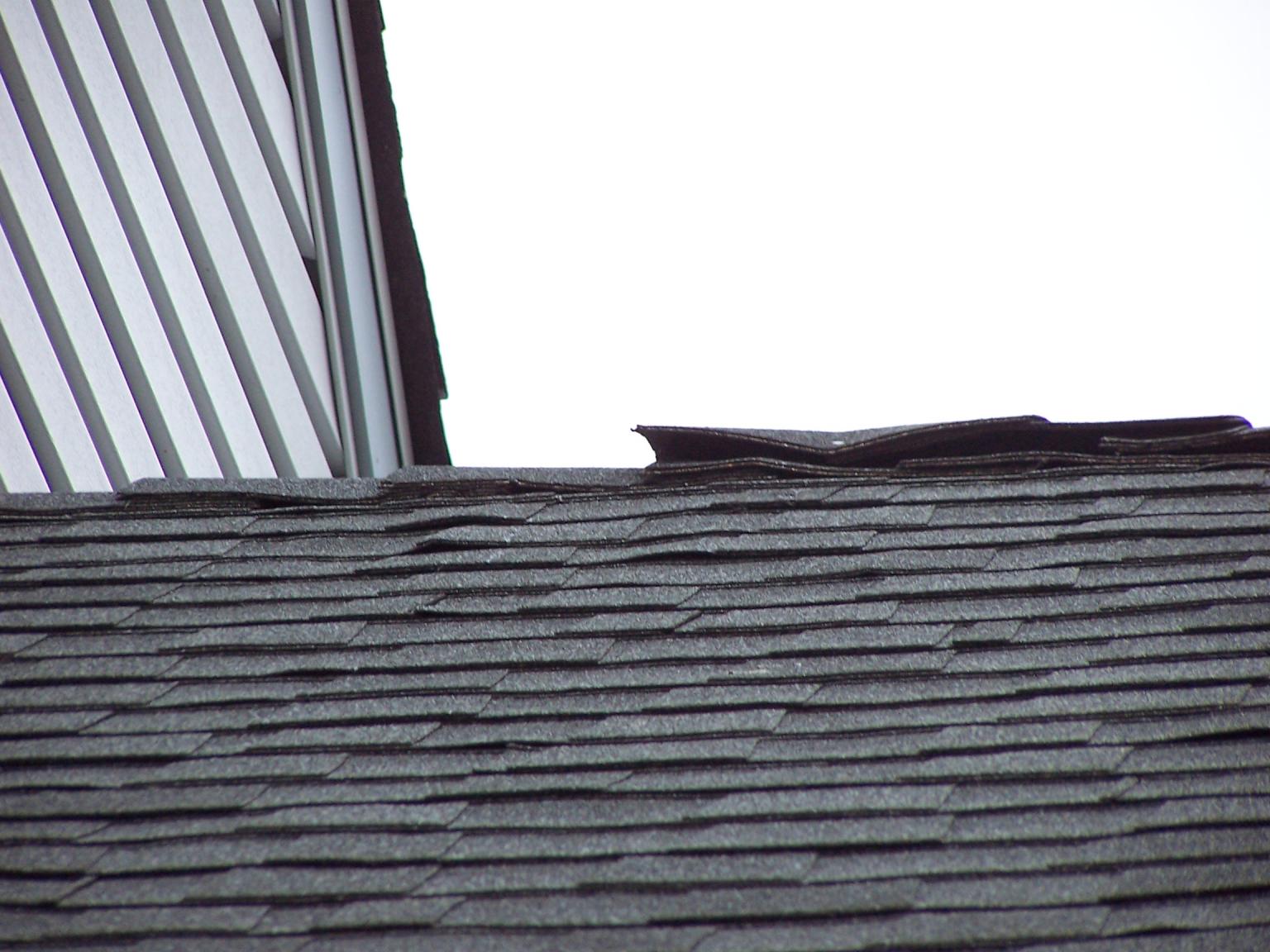

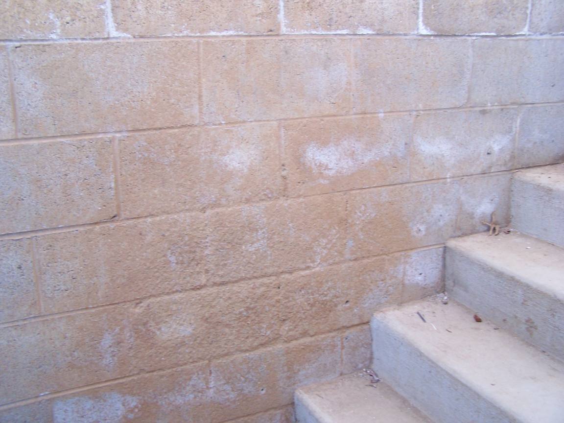

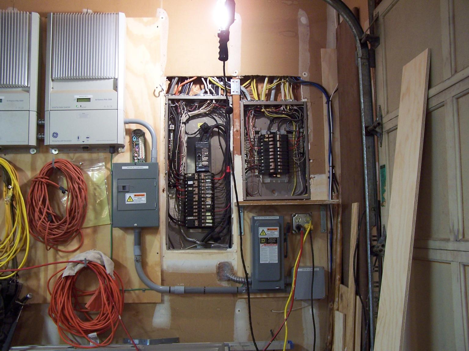

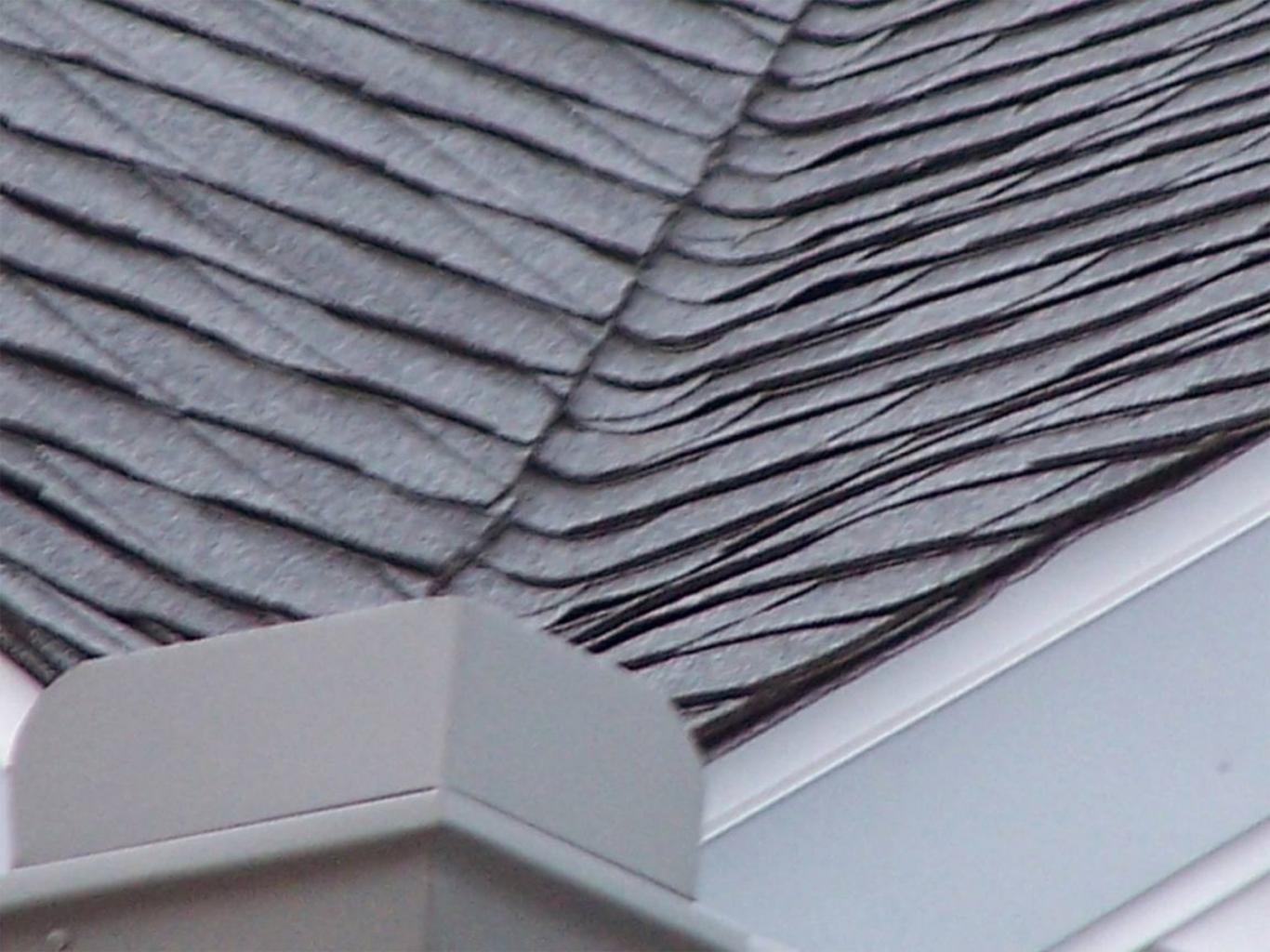

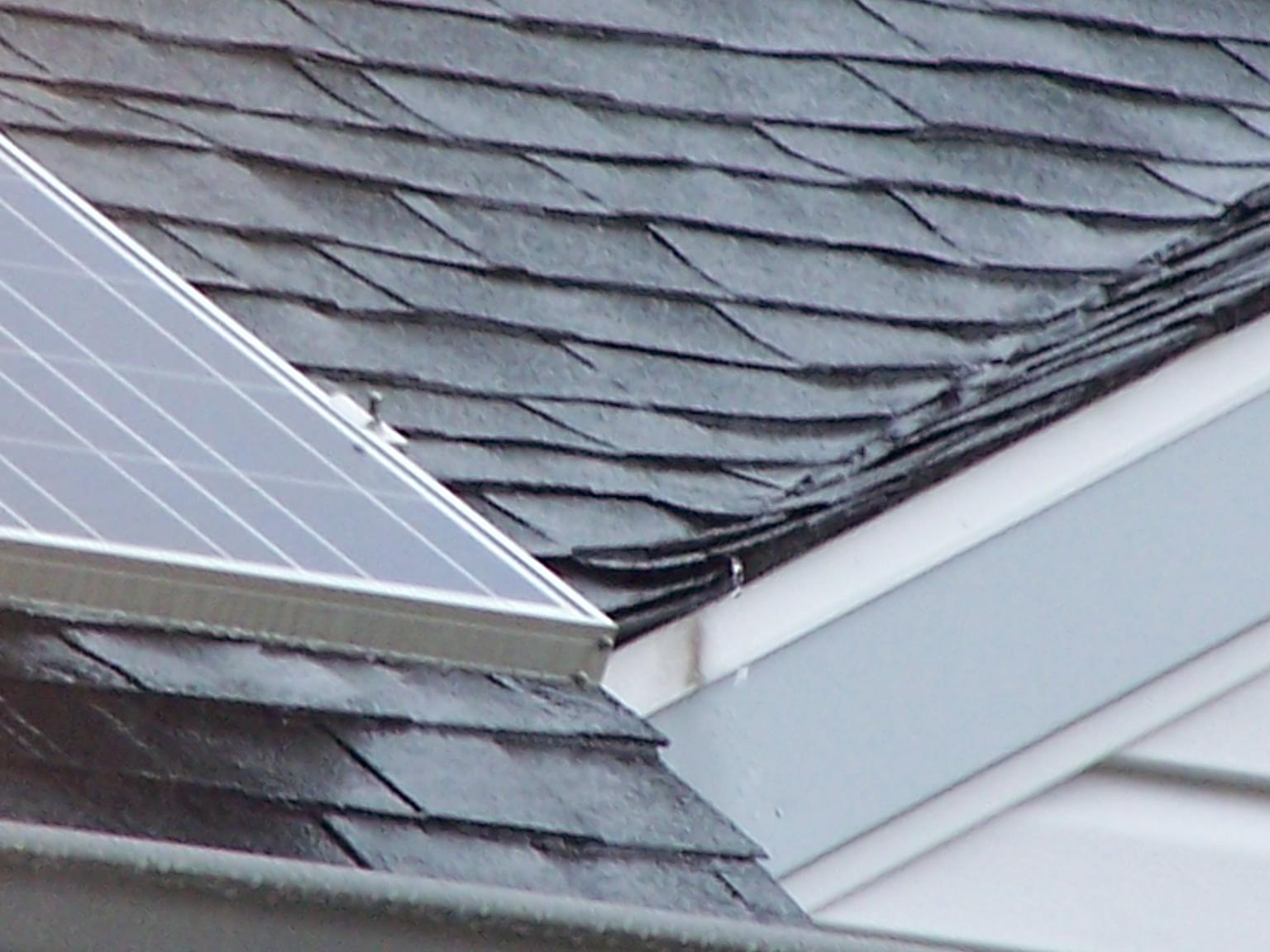

October 21, 201610 yr comment_80041 the siding installers used 2'' roofing gun nails and when the siding went up on the other side of this wall you can only guess how many hits the panel and array controller took... this is after it was all brought up to operational speed... repaired the main panel (the main breaker was missed - somehow) but the sub-panel had to be replaced replaced the buss bars to the main and repaired one feeder... luckily the feeder took the hits inside of the breaker box...... y'all know what had to be done here.... dig up the foundation... waterproof.. add french drains and parge/re-point the interior.. do we mention - haul off all the construction debris???... lets fix the roof too and add flashing while we are here... now this was cute... the Z flashing was upside down... so you know where the water went and what it did... the drip edge came up short too... Report

October 21, 201610 yr Author comment_80212 1 hour ago, lew said: I'm wondering, was all this new construction that had to be "re-constructed"?? the project wasn't even finished (almost though) when I came in as an consultant then the fixer upper guy... Edited October 21, 201610 yr by Stick486 Report
