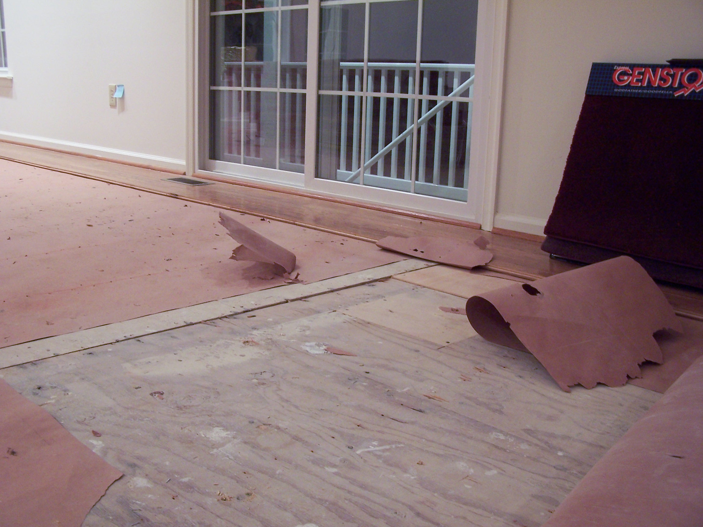

October 21, 201610 yr comment_80038 found a couple of more pics on the great room start up... this is before the flattening process started... foreground.. 3/8 swale... center.. 1/4'' offsets... 3 times the original floor just bridged everything which followed the contours sorta and humped at the offsets... also the original floor had a sub-base print from the stapler in the finish every 20~24''... no no-mar plate on the stapler and 2 of the mounting screws to the sub-base were proud.... SOOOOO..... there were a bazillion drag scratches/gouges in the finished floor along w/ 2 dents and a print of the sub-base at every stapling.... talk about distressed flooring... there as a benefit though.. w/ wide nail spacing and 1'' staples the floor was very easy to get up... quite a few staples never hit the plywood.... or just barely... all of the 8' sticks of 3/4'' QR pre-finished that didn't match the flooring were only poorly butt jointed and lots of splits/blow outs.turned nails in them and gun nose dents from the 15GA.... but we won't mention the really sad miters... Report

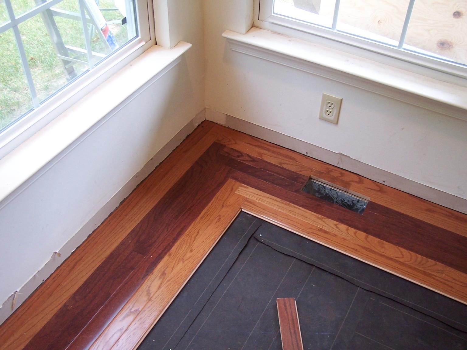

October 21, 201610 yr comment_80042 Beautiful mill work, Stick, is that prefinished, or finished in place? With the dark band ,it gives it a step down effect. You are bringing back old memories. Report
October 21, 201610 yr Author comment_80047 thanks Herb... pre-finished flooring... hard to tell from the photo but it's about 5° out of square.. come diagonal time it got interesting.... what memories would that be Herb??? Edited October 21, 201610 yr by Stick486 Report
October 21, 201610 yr comment_80084 They didnt have much to start with, but you made it look spectacular Report
October 21, 201610 yr comment_80085 Awesome...can't tell it's off... ...and the sticks butting up "square" gives it a nicer look than just plane ole miters... Report
