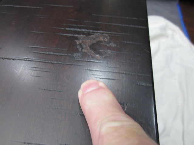

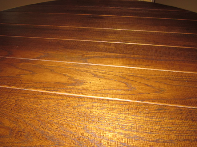

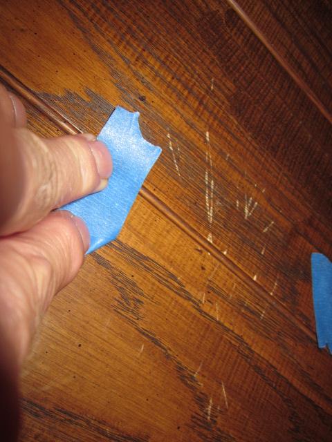

October 28, 201610 yr comment_81199 Here's a couple of jobs I did today. First was just a few coats, second was many Report
