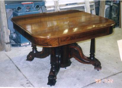

October 17, 201610 yr comment_79577 Hello Friends, I am going to try to upload a picture of a table we refinished. With 5 coats of finish to suite the client. Here goes nothing. Edited October 17, 201610 yr by Ralph Allen Jones Wrong Picture Report
October 17, 201610 yr comment_79599 Looks like you got the picture thing and the finishing thing down pat, Ralph! Gorgeous piece. Report
October 17, 201610 yr comment_79606 Nice looking table Ralph. Coloring and finish look great. Also looks like it weighs in at 10 or 20 pounds... Report
October 17, 201610 yr comment_79607 What a beautiful job on the table Ralph, and I am glad to see you get the hang of the pics! Ok, now the million dollar question, how'd ya refinish it? What did you use? Way to go Ralph! Report
October 18, 201610 yr Author comment_79626 Thanks Guys, I'm glad you liked it and John I stripped it by first cleaning it up with Murphy's soap suds and then stripped it with denatured alcohol, down to the bare wood and found the ebony on the lower portion as well as Walnut bural on the corners. Then I hand rubbed the stain in blending as I went and applied three coats over a 36 hour time. Then I started applying hand rubbed Minwax Tung Oil with five coats over a 64 hour period sanding between each coat to 400 grit. A lot of work but well worth it. I only charged the client $800. 00 for the job and she was very pleased. Report
October 18, 201610 yr comment_79628 8 minutes ago, Ralph Allen Jones said: Thanks Guys, I'm glad you liked it and John I stripped it by first cleaning it up with Murphy's soap suds and then stripped it with denatured alcohol, down to the bare wood and found the ebony on the lower portion as well as Walnut bural on the corners. Then I hand rubbed the stain in blending as I went and applied three coats over a 36 hour time. Then I started applying hand rubbed Minwax Tung Oil with five coats over a 64 hour period sanding between each coat to 400 grit. A lot of work but well worth it. I only charged the client $800. 00 for the job and she was very pleased. Beautiful job Ralph. You made me weary when you wrote about hand rubbing the stain. Well done my friend. Report
October 18, 201610 yr comment_79640 1 hour ago, Ralph Allen Jones said: Thanks Guys, I'm glad you liked it and John I stripped it by first cleaning it up with Murphy's soap suds and then stripped it with denatured alcohol, down to the bare wood and found the ebony on the lower portion as well as Walnut bural on the corners. Then I hand rubbed the stain in blending as I went and applied three coats over a 36 hour time. Then I started applying hand rubbed Minwax Tung Oil with five coats over a 64 hour period sanding between each coat to 400 grit. A lot of work but well worth it. I only charged the client $800. 00 for the job and she was very pleased. Sounds wonderful Ralph, it was a wonderful job, I bet she was happy! Report
