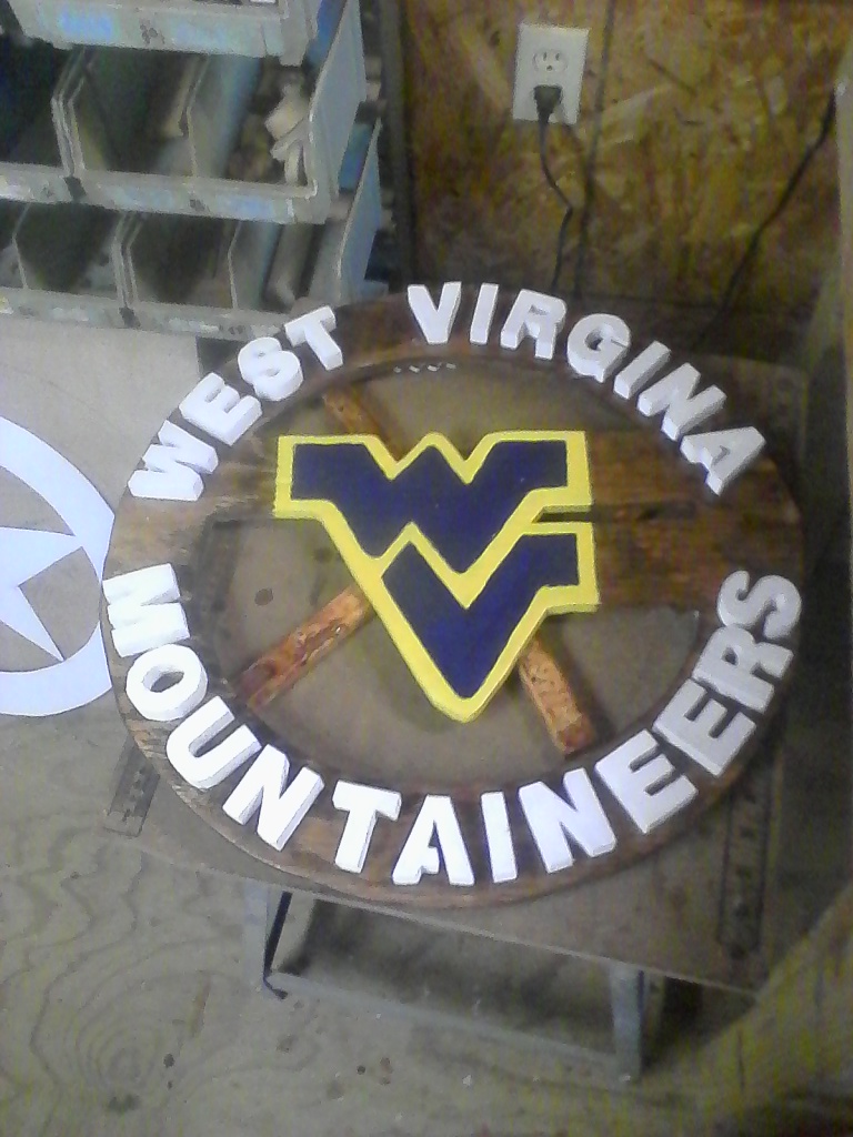

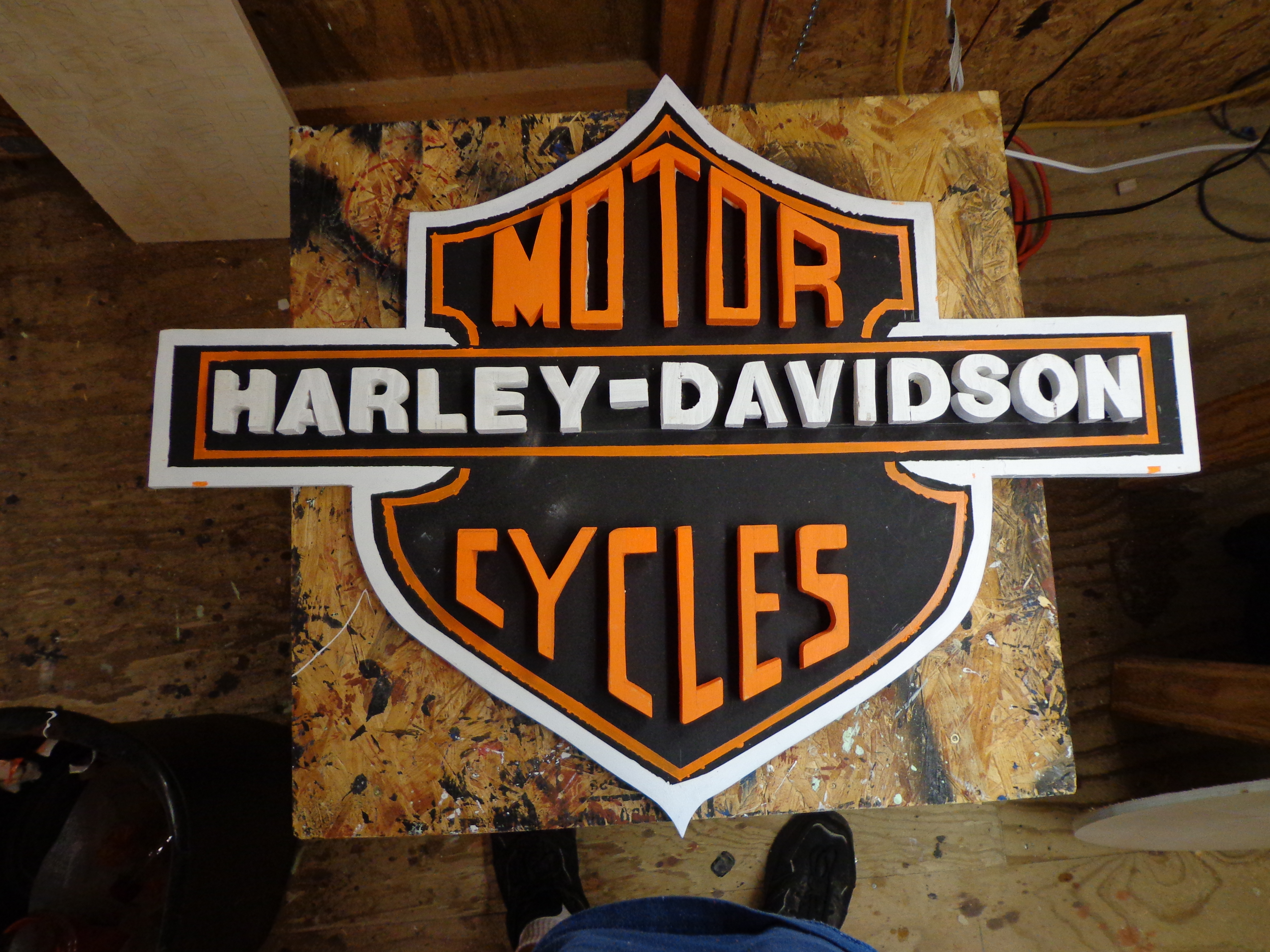

October 15, 201610 yr Author comment_79161 the first is just clear on the WV,left the white like it is,came out fine,Harley sign is w/out any clear,black is flat to show off the white an Orange Report
