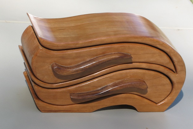

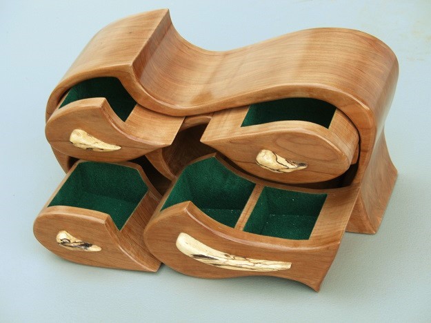

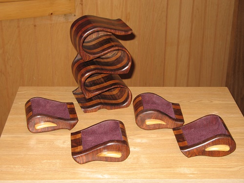

October 8, 201610 yr Popular Post comment_77963 Band saw boxes are fun to make. Since I've been asked to show some of my work, these are the last 5 that I've made, plus one that I had posted earlier. These are all designs by Lois Keener Ventura.. Woods used are Walnut, cherry, rosewood ,and a bit of spalted maple. Hope you like them Report

October 9, 201610 yr comment_77995 Very nice Al. I really like those and especially like the ninth and tenth pictures with the spalted handles. Report

October 9, 201610 yr comment_78014 I like them all Al, but the first one for it's simple design, the 2nd one for the wood, contrast & finish, and the last one because without the drawers it just reminds me of that old fashion ribbon candy. All very well done! Thanks for sharing. Report
