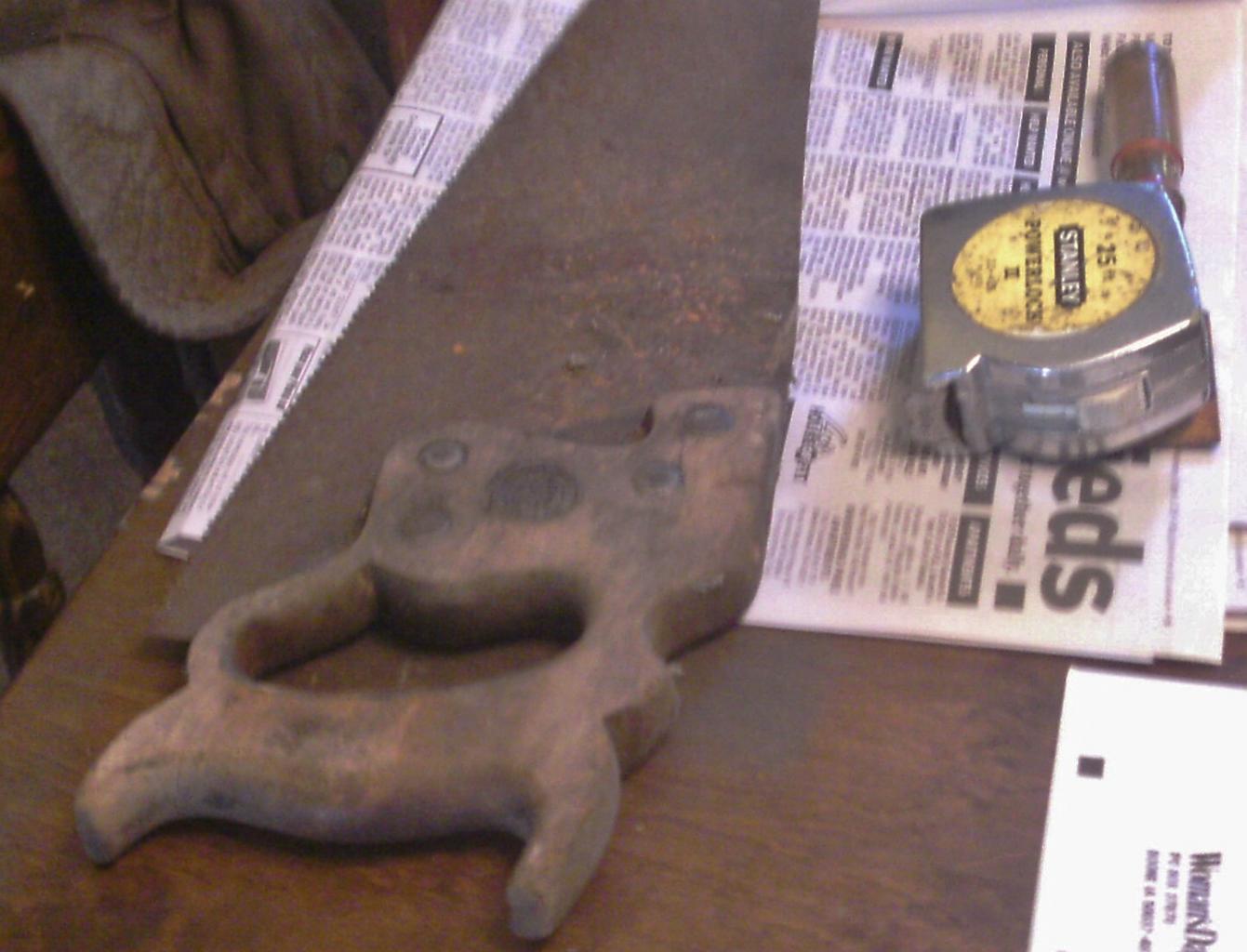

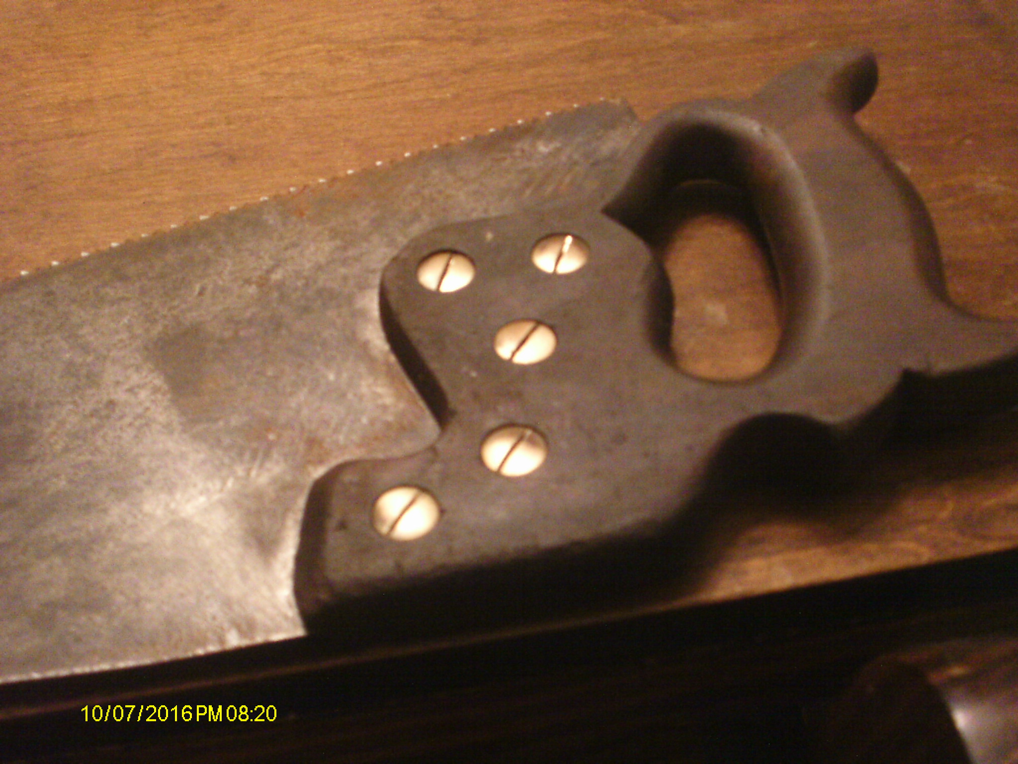

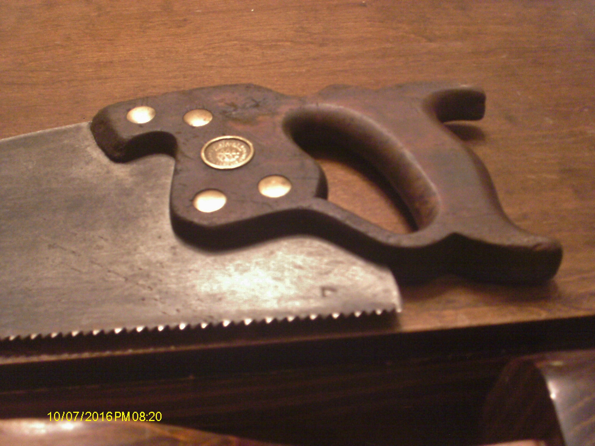

October 8, 201610 yr comment_77870 Finally got out to that estate sale south of town this morning.....feeding frenzy of both buyers and relatives......"Picked" three tools that I could at least carry around.. There was a rusty and krusty 1" chisel( to use with the oil stone post) that Stanley Powerlock 25' tape ( in GREAT shape) and that rusty old saw... Well, I think that MAYBE I could do something with the saw? While I was out on some errands, the saw plate got a Simple Green soaking. Then I took the handle off. Polished the brass fittings, BLO/Varnish mix on the handle. Plate was sanded clean. Tried to find an etch....all I found was a 7 stamped into the plate. handle was dry, All the brass shined up, put things back together.. 7 ppi skew back crosscut plate. I'll need to work on them teeth a bit. Handle? Handle seems almost a walnut flavour now? Bolts have been "clocked". Handle is an older "open top" style. Has a chip in the top horn..meh... There is a divot on this side of the handle. Medallion is a recessed AAA one by Atkins. You can also see the "7" stamp. Spent $5 on the three tools today......twas a good thing I don't have a "Line Shaft" power plant in the shop....I would have need a BIG flatbed truck....the lathe in that building was almost as big as my Town & Country van! Sale is still on tomorrow.....and I'm broke. Report
October 8, 201610 yr comment_77883 Not a bad day for $5...better than mine today...box full of odds/ends for $3...pics tomorrow maybe. The Powerlock looks like one of the very early ones...great find...can u steam the divot out/up in the saw handle? Thick damp cloth layover & steam iron? You can never have enough chisels... Report
