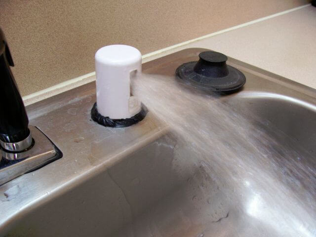

October 1, 201610 yr comment_76891 Somewhat off topic, while our kitchen was being replaced due to flooding a couple years ago, our granite counter top fabricator laid out the holes for the faucet and soap dispenser, and asked him what about the "air gap" for the dish washer, he stated no one used them anymore, I asked the plumber on the job, and he stated the same thing, "air gaps are hardly used anymore, plus they make a mess of things when clogs happen, water spills out everywhere and often time over the counter top and it's a big mess". We went with the recommendation, and have not had any issues in the last 2.5 years by not having an air gap. Plus our beautiful counter top looks less crowded too without it. Just food for thought. Right or wrong, we have not noticed anything bad without the air gap. We have a double sink, disposal, and two year old dishwasher. EDIT: By the way, plumber stated Air Gap installation not needed with newer dishwashers as the waste drains directly into the garbage disposal. Kitchen was inspected upon completion, and inspector had no issue with it. Report

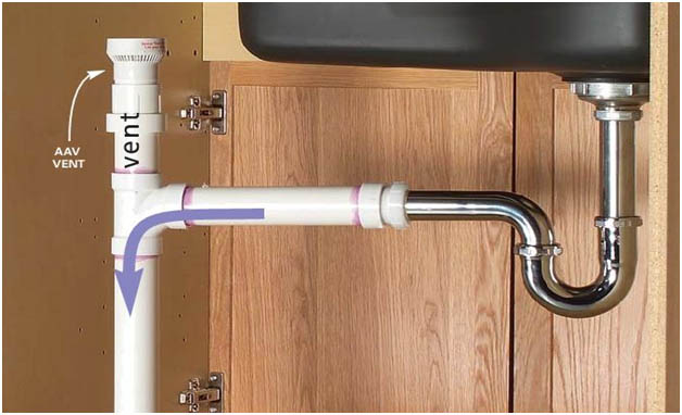

October 2, 201610 yr comment_76967 The vent needs to be plumbed in one of these two ways. It cannot be plumbed of the side of a horizontal pipe as the water may fill the pipe restricting air flow possibly causing the vent not to open properly. Report

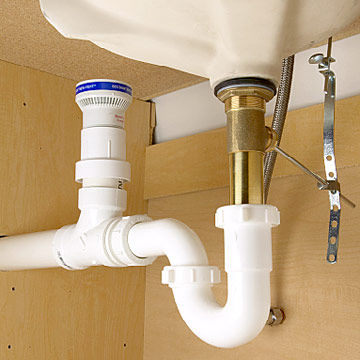

October 2, 201610 yr comment_76978 Dan, what kind of vent is that shown in your pics? John, what is an air-gap? Cal Report
October 2, 201610 yr comment_76979 16 minutes ago, clhyer said: John, what is an air-gap? It's that short stack looking thing for the dishwasher that sticks out of your counter top. And sprays all over when you get a clog in your dishwasher drain line. Report
October 2, 201610 yr comment_77001 2 hours ago, clhyer said: Dan, what kind of vent is that shown in your pics? John, what is an air-gap? Cal The blue one is a Studor but these are images I found to depict the proper installation. Report
