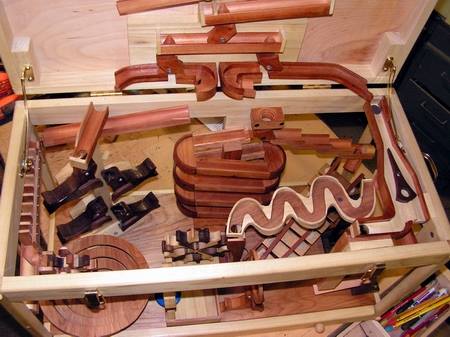

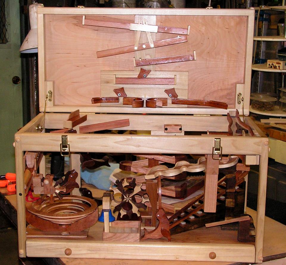

I got the plans off the internet for this one. I revised it several times and added some of my good wood scraps. It is a big hit with my grandkids.
I was asked how much time it takes to make projects. The answer is simple, when you do what you love to do, you lose track of time. However this marble game took LOTS of hours. It has 8 separate trails for marbles to descend.Each makes a noise, plays tunes or hits a bell. After each finishes its trail, it goes thru a hole and enters the lower open shelf where it can be picked up again. It can be loaded with about 10 marbles and after you trigger it, each marble will be released automatically.
The big problem with is that kids will put different marbles in it. The different diameters and weight causes an unbalance and sometimes will stall on of the trails.

You load up the marbles in the lid, top left. You trigger it by dropping one marble in a hole. Then it releases one marble at a time. As it goes down it hits a diverter that changes the path of the next marble. Then it continues down and hits another diverter and so on. That makes all of the different paths in use at the same time. I may have a video of that

The one that was the most difficult to get right, was the one with the blue bell in front. If you look below the right lid latch you will see a piece going down.  that is a square chute that the marble drops down, then hits a piece of wood,bounces off and hits the bell. I had to find the angle of the piece it bounces off of and then keep sanding on it until it travels the correct distance. It actually hits the bell most of the time.
