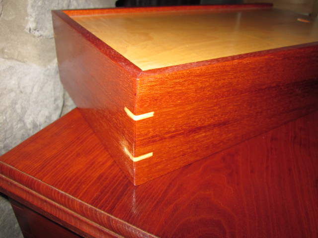

September 14, 201610 yr comment_74067 what you show is a floating tenon. these are what i consider splines: both vertical and horizontal in the corners. adds some strength and some accent to a weak joint. Report

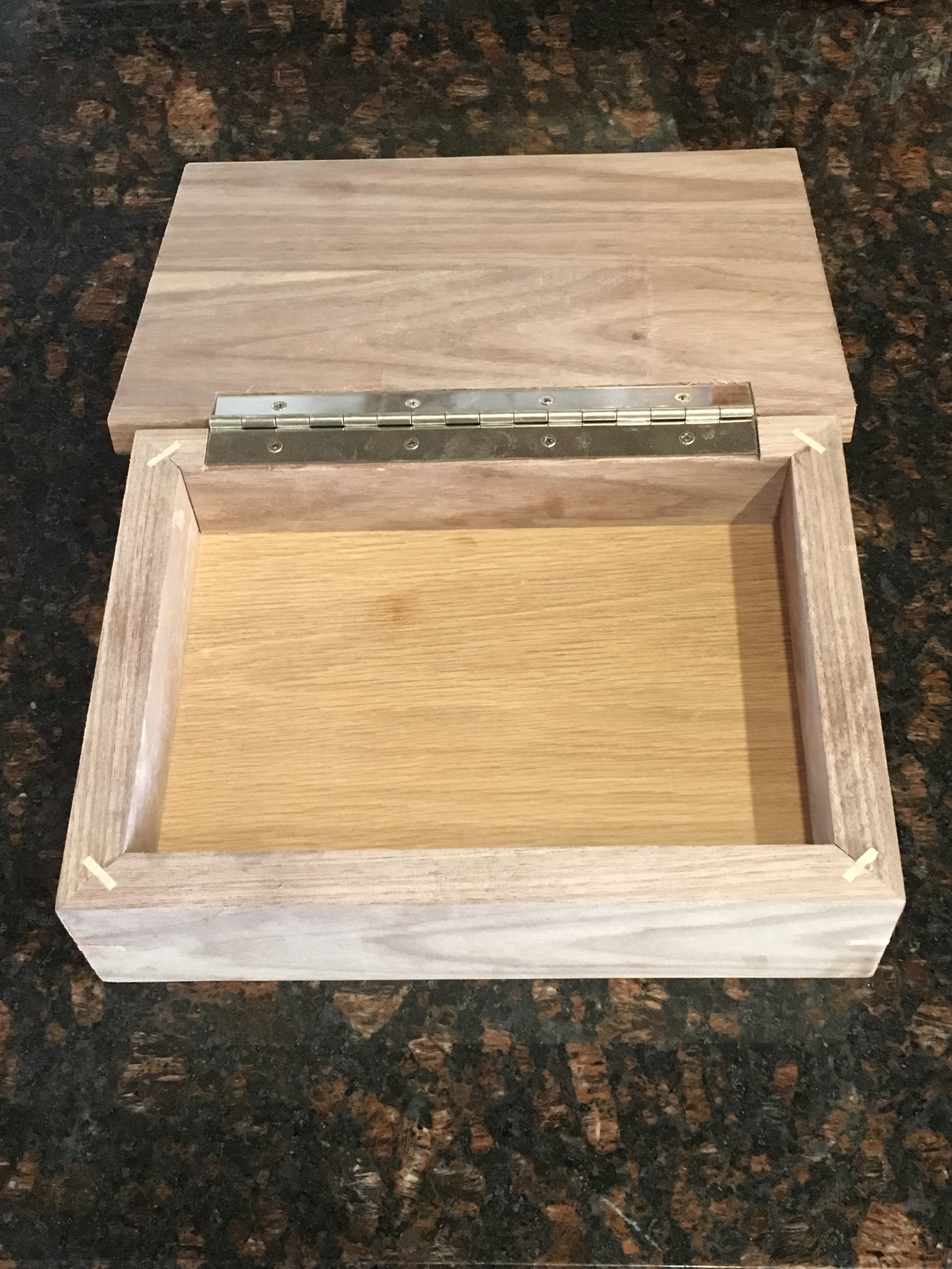

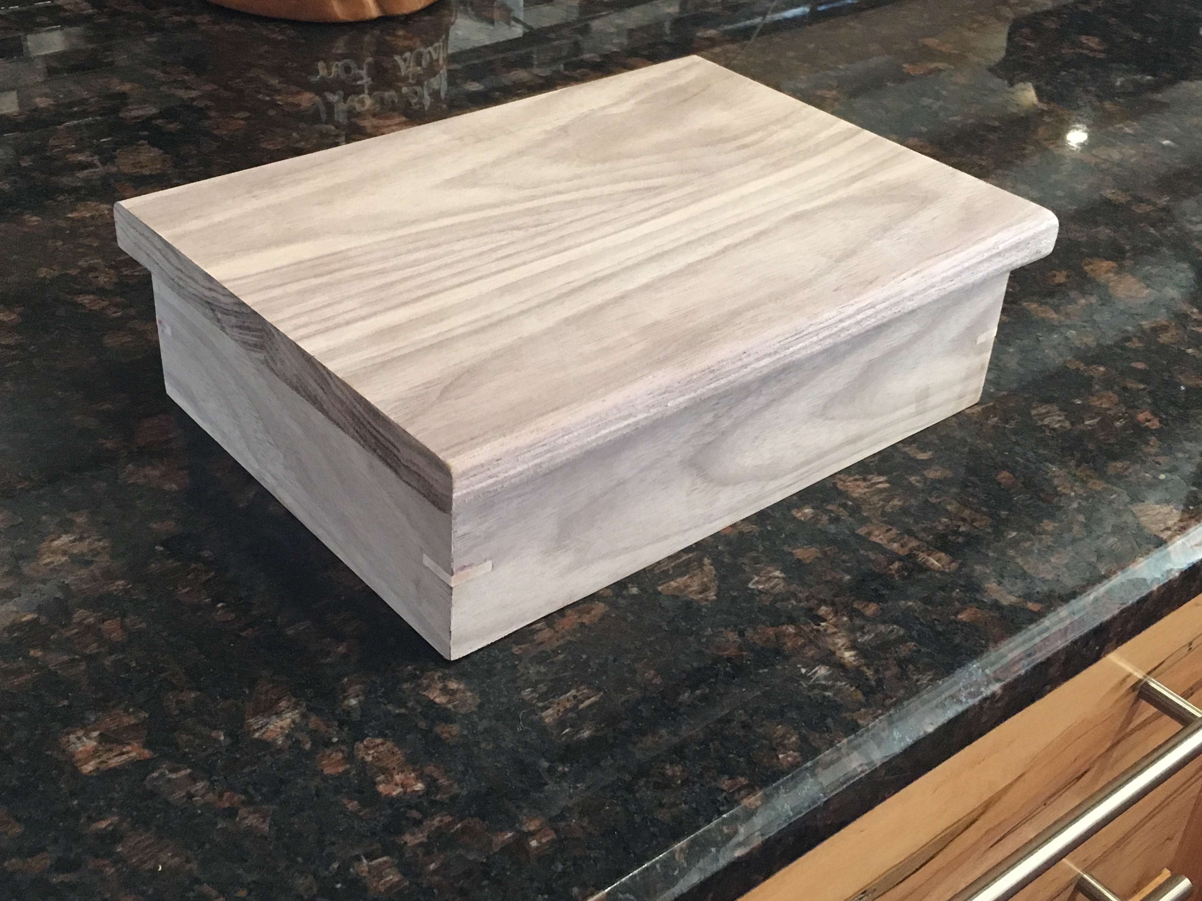

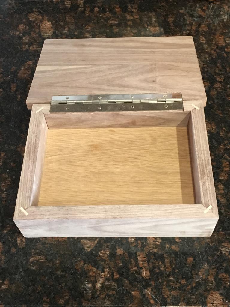

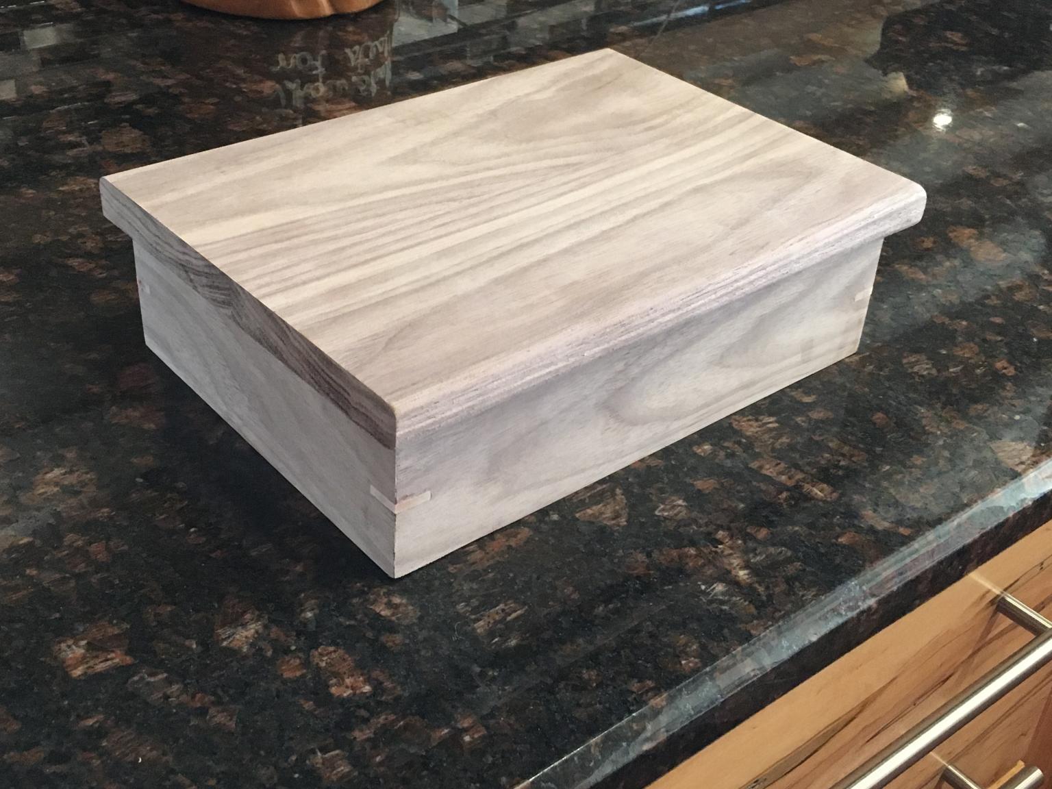

September 14, 201610 yr comment_74069 I don't use them often because a side-grain to side-grain glued joint is stronger than the surrounding wood. If you are going to do any distance like the drawing shown by Stick, you would be wise to segment the spline as you have cross-grain construction. In a way, biscuits are splines (or maybe you can consider them floating tenons), but I only use them in butt and miter joints. I do often add contrasting keyed splines in the corners of mitered boxes. Report

September 15, 201610 yr comment_74118 Well, one could even shape the spline to look like a dovetail's pin and show it out both sides of a corner... Report
September 15, 201610 yr comment_74145 I have used splines in picture frame corners. I glue the frames up in corner frames, put them on a gig I made for the table saw and cut each corner. Place splines in and glue. I especially like to use them when I make frames out of distressed or weathered boards. It makes them as strong as the can be Report
