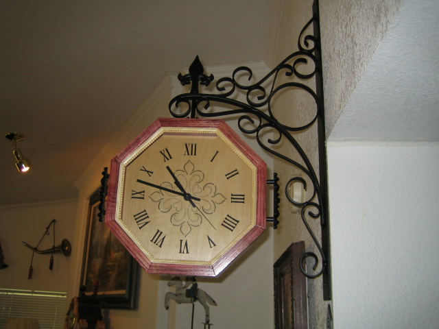

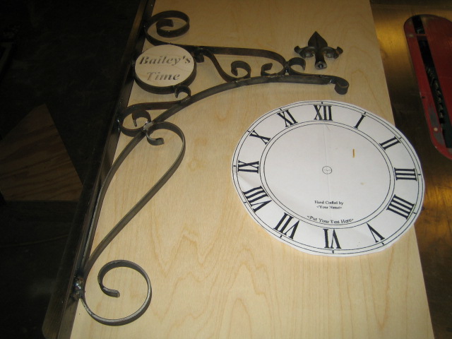

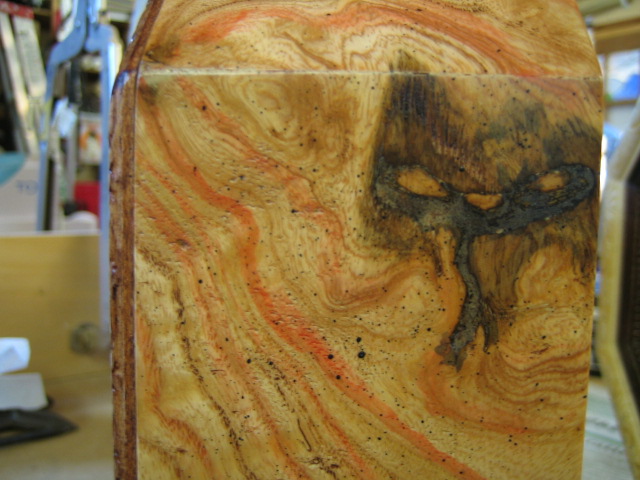

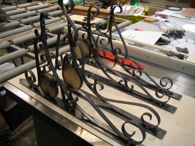

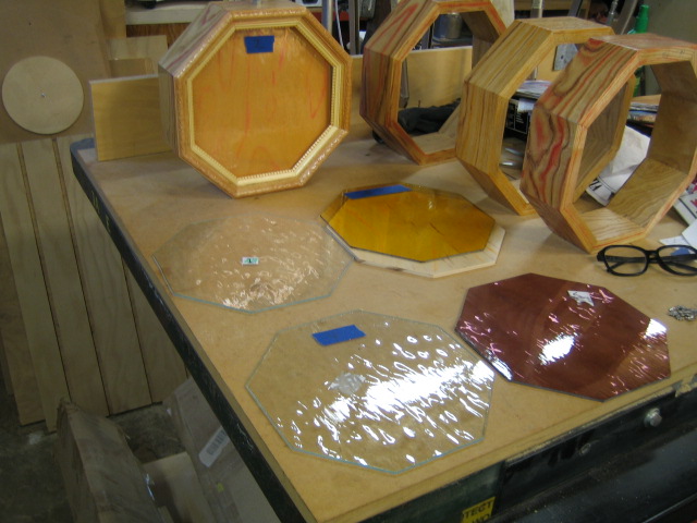

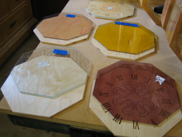

September 8, 201610 yr Popular Post comment_72802 It might not be the correct way to build these but. These clocks are the rest of the story from a couple of days ago when I was showing the outside of those oddly colored ash wood clock bodies. These clock bodies I was showing in another post do hang on the wall. One of the guys on that X, X means long gone, wood site had suggested why didn't I make the boxes round? So being very slow I am still running that through my computer head so why didn't I make them round. Only explain I can come up with is I didn't see any round wood laying around at the time in my little life. So now I am happy to report we have just this month bought some trees at the nursery that grows round wood so I will be making some round clock bodies after the trees gets a little larger. This is what the clock bodies hang on. You can see I try to never make no two things alike. This good ole female wife I got, Its good now a days to signify which kind of wife might live in the same house as you, was good enough to make me some pieces of glass for the clock faces. You can see I requested, and got, clear and colored wavy types of glass. With her contribution I think we finally got the price of these clocks all the way up to 10 or 12 bucks each, thats including a battery for the movements. Nothing is too good for my customers............. Did you catch that line, requested from my wife????? Sometimes a request and an order might sound the same to her and you might know what she might do if I order her to do anything........ Such a sweet wife I do have. Using this wavy glass, will hide lot of flaws in your building ability right quick. This is how I size things up or you might say my computer drawings. If it don't fit, it don't fit, so change computers. You see I can get intimate with some of the recipantants. Bailey's my grand daughter. Notice, I used, not included in this picture, a 1/4" diameter all thread, to be cut from a 36 inch piece, for the hanger rod and the topper was once a wrought iron fence topper. Cut the square female bottom off the topper, tap 1/4 x 20 threads up into the remainder of what's left of the topper and wa-la you got something pretty to hold the clock to the wrought iron hanger. Spray it black after cleaning up the weld and you are in business. For the movements I used the atomic type so called movement cause they set themselves so every time the battery runs out, the only thing a person has to do is replace the battery and the time will set auto- matic- lee. I like to leave all the wood flaws in plain sight. It gives the owners of them more to talk about when discussing their new 10 dollar clock.. I have more fun trying to come up with plans of my own than having to use someone else's plans. My pet peeve is reading about this guy who bought a set of plans and what he built was a square table that had 4 legs. Then he complained because the plans was not clearly marked and he made a mistake and had to go and buy more wood......... To me this sounds like a guy who might have the qualities to run for president or some important office. Also if you are careful when laying out the wood for the clock frame you can make the wood grain go all the way around the frame with each piece matching. Report

September 8, 201610 yr comment_72845 I can see all except where is the wavy glass going. Is that the glass outside the clock? Thanks for the PIP. I have tried to get away from clocks after retirement and then went and put up 3 clocks in the shop so I would not miss supper. Report

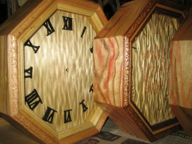

September 8, 201610 yr Author comment_72856 Gene this is what you would see if you were the clock hands looking out through the glass. Edited September 8, 201610 yr by Smallpatch Report
September 8, 201610 yr Author comment_72858 Gerald these pieces are the lens of the clocks. The wavy glass in my weird mind will make people stop and think did I just see something different or did that drink I just had have more than the prune juice and a raw egg which is my normal drink. The wavy glass makes things change in strange ways and they might see something they like in that clock. Sometimes it takes something different and odd to make people buy something they didn't even need or want when they came in to look around. Report
September 8, 201610 yr Author comment_72859 Each glass has a different texture and a different color to it and no two will be the same when looking at the hands or the numbers of each clock. I got to be different. Report
