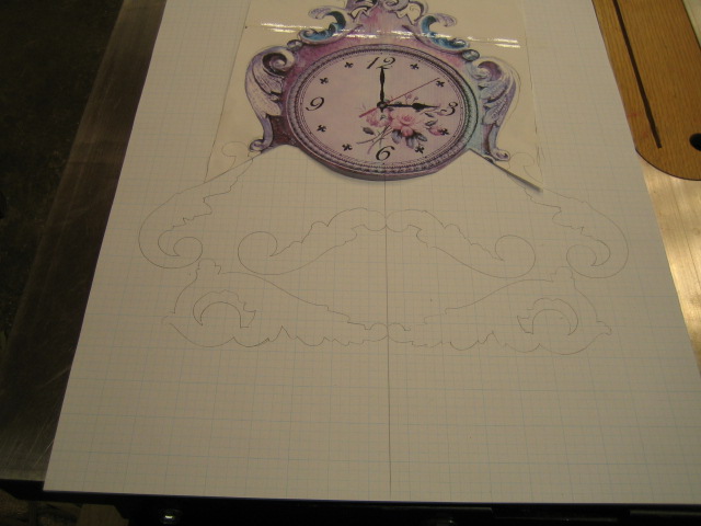

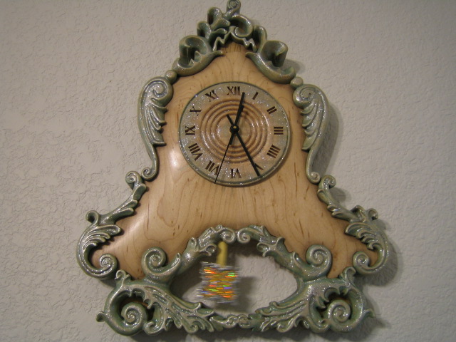

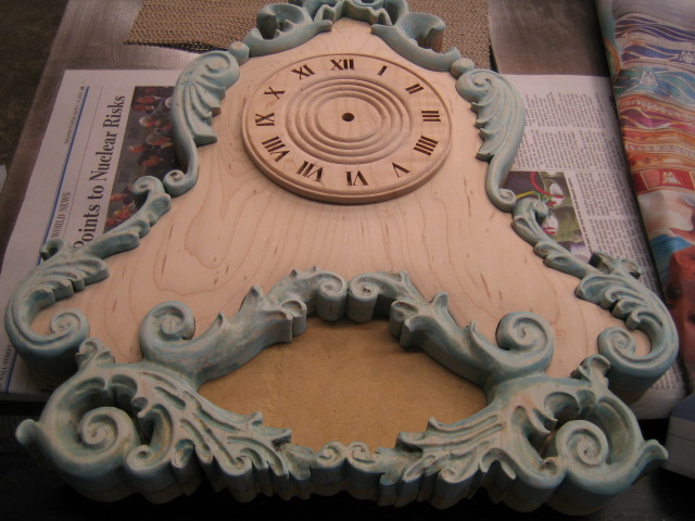

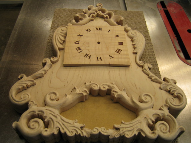

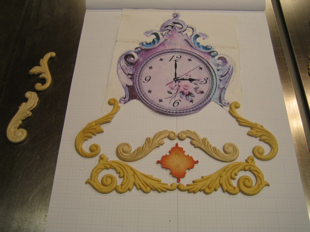

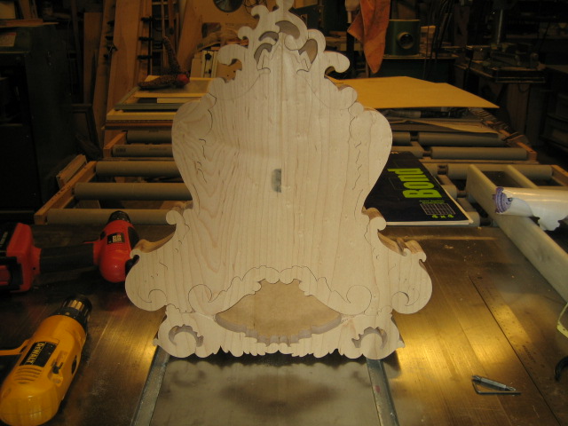

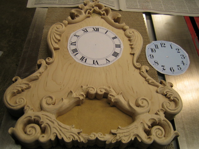

September 4, 201610 yr Popular Post comment_72027 I liked the top of the last three clocks I made so I started with that picture then add my own style to the bottom half. Before I started making the carvings I would buy them and trace around them so this time I would do some of the same. Faster this way. As I was starting to carve the wood a little thought said look online for a dial I can scroll saw out so I won't have to use the expensive brass with glass which makes it look too modern anyway. It might even look better since this is supposed to look like a cave man built it. I wanted to start with a baby blue stain. Well wood has a mind of its own and will change as you add more things on top of that light blue look. This is the first time I put the pendulum inside a hole that has carving around it and the space was almost too thin. The clock is 18 x 15". And its all hard maple. Great wood for carving but maybe hard on the grinding wheels. I used an ole back plate for a drawer pull for the shape of the pendulum bob. All the carving was done with a dremel with a flexible shaft. I do have a Foredom but I never use it, to bulky. I never know when I start something what the end colors will be. Just keep on till I am happy then stop. That's the joy of making things for yourself. Let me know if I take too much room with the pictures and I will delete them!! Report

September 5, 201610 yr comment_72125 They just keep getting better. The pendulum is a blur what does it have on it looks phosphorescent? Report

September 5, 201610 yr Author comment_72196 Thanks for the kind words you all. Gerald, the pendulum bob, as it is called?, was a metal backing plate for a drawer pull. I laid it in the printer then enlarged a picture of it then scroll sawed it out. I used Hobby Lobby glitter held in there with a layer of elmer's glue. After the glue and glitter sits in there for a few minutes then taking an 1/8" dowel or something and jab it around mixing both together then top off that with a little more glitter. Then before it goes in the house, blow off the loose glitter. The jabing will make a hilly area and will make the glitter more glittery, if that's a word. I posted the sequence of steps because nothing is past plain ole wood working . A scroll saw and a Dremel with a flexible shaft was all it took. I don't use any Dremel bits for they are junk and won't last one small job. The bits came from Wood Carvers Supply and I will get the numbers or the bits if interested. This in the very best kind of a project for someone to learn carving, which is really grinding for I used no knives just electricity. And I can explain more, with pictures,on that subject if interested..... I want to see more guys do this also. I just started carving less than a year now and only a little skin is missing, plus some fingernails some what shorter but it is more fun than any other wood mangling I have ever done... Dave this site is a good one except I never know where my pictures are headed once I push the button. Report
