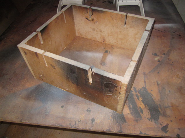

Also took my pneumatic finish nailer and shot a bunch of nails thru a scrap of 1/2" plywood. Set it nail points up. Rest the finished piece on the nail points.
This is a jig I made to stain and finish table legs (which I remove from the table via the bolts and corner blocks)
That's a great tip Stick! I have a ton of jacks, the kids don't play with em anymore, very nice!
