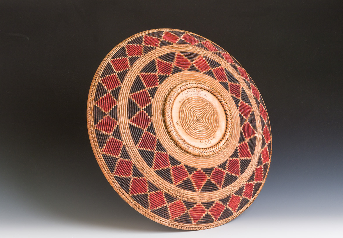

September 2, 201610 yr Popular Post comment_71359 I just signed up; today. My main interest is woodturning. A lot of members at Wood Online decided to migrate over here after Wood announced that they were shutting down the discussion forums. I also participate in a number of other woodturning forums and am an administrator on the AAW forum. I have been woodworking for about 35 years and woodturning for about 12 years. Here is one of my pieces that I did late last year. It is a Native American style basket illusion piece that I turned from maple. I it to about ¼" thick and then beaded it, then burned it, and then colored with Copic markers. It is 14½" diameter and about 3" deep.It is thin enough that light shines through it between the beads. Next time I won't make it so thin because it is too easy to make a big funnel. Report

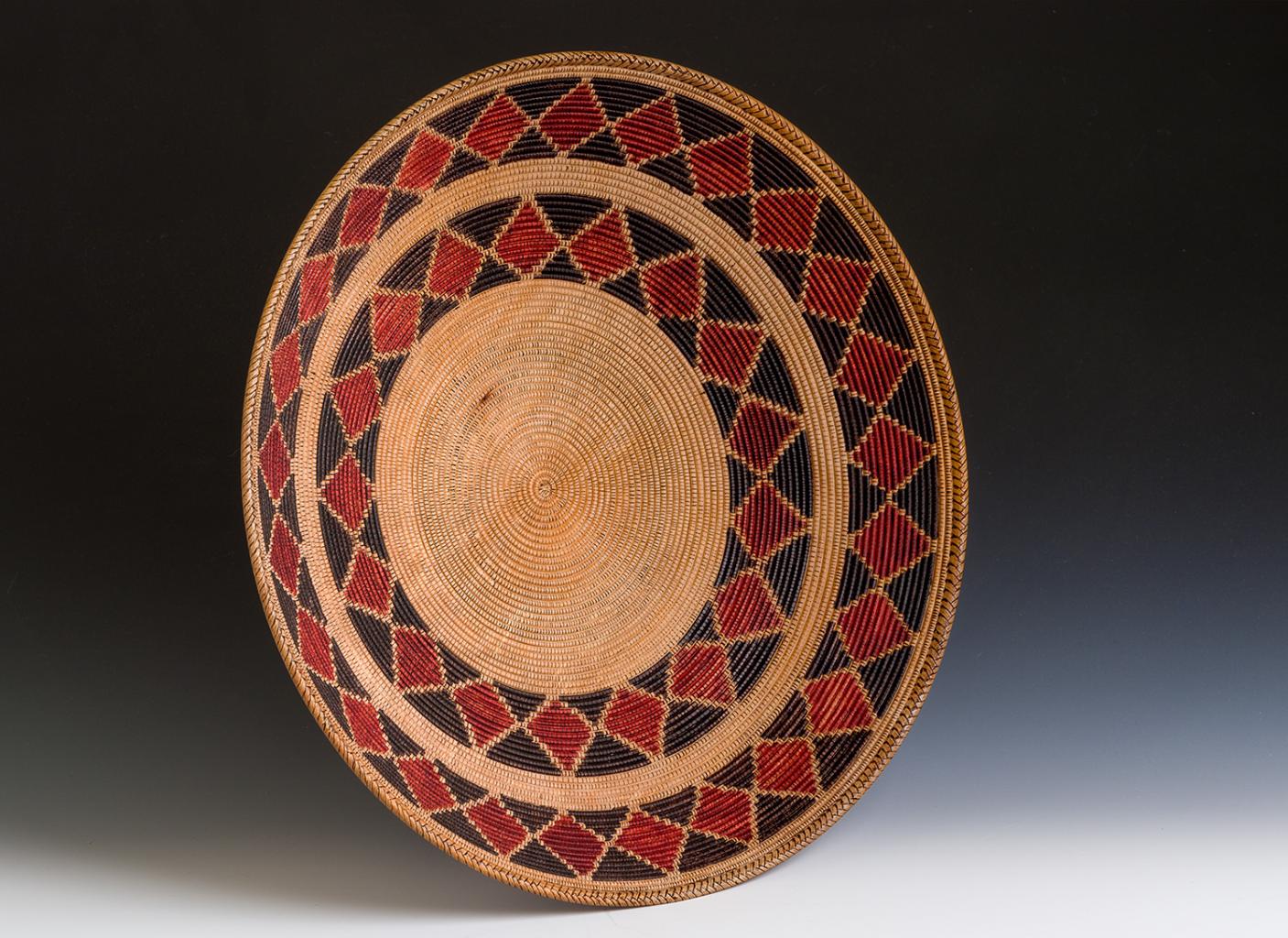

September 2, 201610 yr Author Popular Post comment_71361 Some people like to see the bottom side so here it is. Report

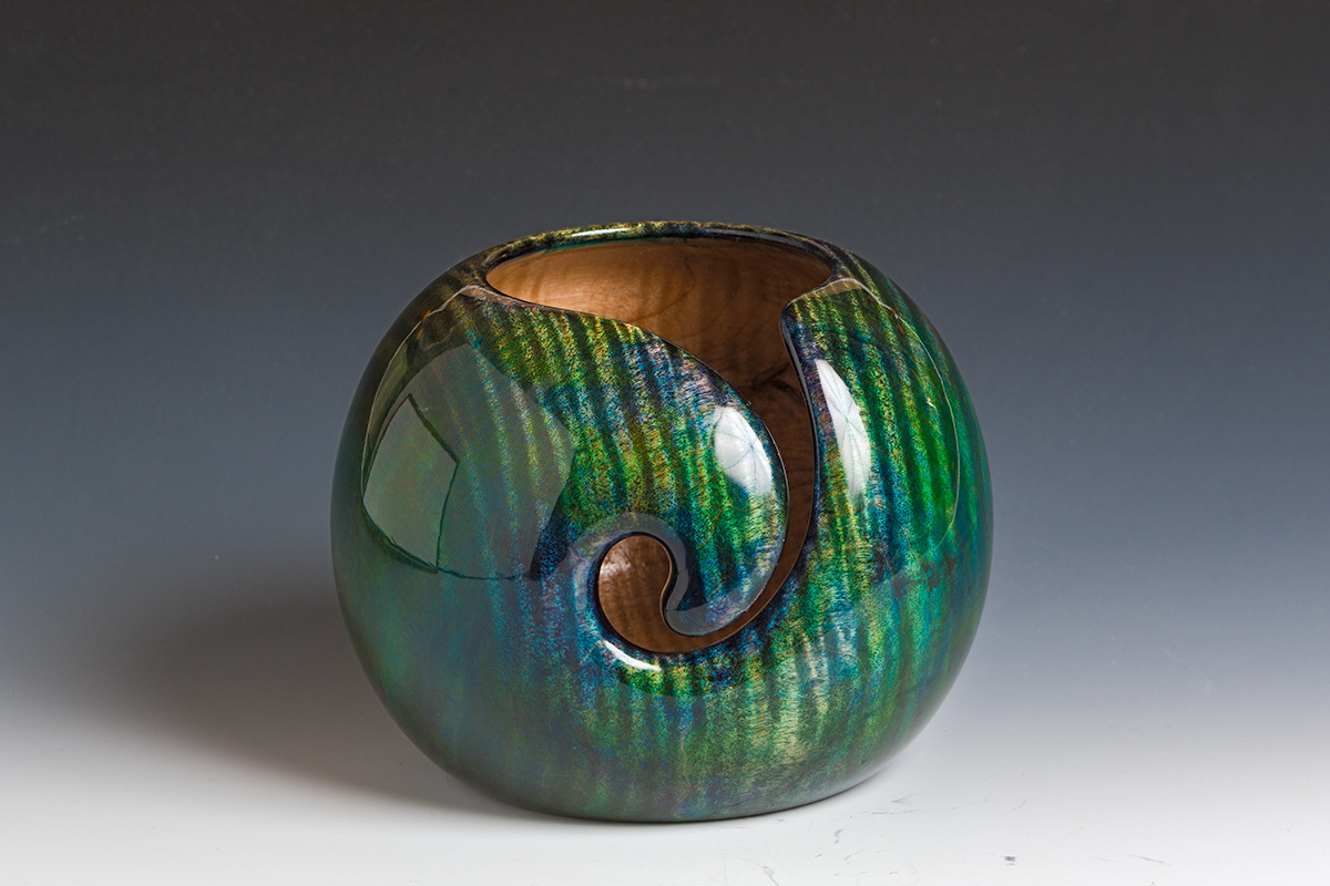

September 2, 201610 yr Author Popular Post comment_71375 Thanks, guys. Here is one of my more recent pieces, a yarn bowl. I am out of the turning business for the next several months because of rotator cuff surgery. Wearing a sling is the pits, but I'll have it on for several more weeks. Report
September 2, 201610 yr comment_71376 My goodness Billy, you are an artist. So, since I am new to turning, what is the process for the yarn bowl. Turn to form a bowl, jig saw the yarn opening hole, sand and shape, dye stain, then finish? And, how do you get the sheen so glossy and mirrored? Thanks Billy Report

September 4, 201610 yr Author comment_71973 On September 1, 2016 at 10:23 PM, John Morris said: My goodness Billy, you are an artist. So, since I am new to turning, what is the process for the yarn bowl. Turn to form a bowl, jig saw the yarn opening hole, sand and shape, dye stain, then finish? And, how do you get the sheen so glossy and mirrored? Thanks Billy Thanks for the compliment. I turned it as a monthly challenge that our club does. I first turned a six inch diameter sphere and then created a base and turned the interior. A yarn bowl needs to be heavy so I left the walls about 5/8" thick. I drew the "J" slot and then drilled a series of holes. I then used a Foredom tool to rough shape the slot. From there there was a lot of hand foling and sanding starting with 60 grit. The curl part of the J is flush with the spherical overall shape while the right side of the J recedes back about 3/8". That means that there was much more hand sanding to gradually and smoothly blend it into the overall spherical form. The wood is fiddleback maple and was dyed with blue, yellow and purple Chestnut dyes. I applied about six coats of Deft gloss lacquer and after letting it dry for about a week, I used Micromesh to level the lacquer finish and polish it up to 12,000 grit. Report
