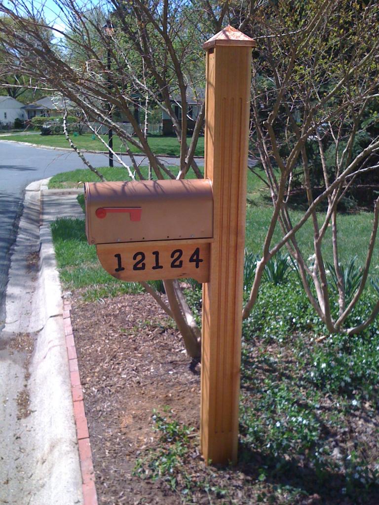

August 28, 201610 yr comment_70312 made this many years ago. cedar with exterior spar urethane. copper cap that i made too. it's hollow, so it fits over a sunk 4x4, few screws at bottom keep the kids from stealing it at night. black paint for the routed numbers. Report
August 28, 201610 yr comment_70347 Nice Mailbox. You really get your bills in style. Is there a place for the newspaper? Report
August 28, 201610 yr Author comment_70350 5 minutes ago, HandyDan said: Nice Mailbox. You really get your bills in style. Is there a place for the newspaper? the newspaper guy would just toss it on the ground, even when we had a newspaper box, so we just got rid of that and cleaned up the design. now....i just read the internet in the morning, no more newspaper. Report
August 28, 201610 yr comment_70364 Best mail box post I've seen in a while and I also like the top. Report
August 28, 201610 yr comment_70382 47 minutes ago, Ralph Allen Jones said: Best mail box post I've seen in a while and I also like the top. Agreed and let's go ''borrow'' it Ralph... Report

August 29, 201610 yr comment_70596 How did you build this what are the dimensions can you please share the plan? Report

August 29, 201610 yr Author comment_70607 48 minutes ago, Michael Thuman said: How did you build this what are the dimensions can you please share the plan? no plans, just invented from my imagination. if i recall, the PO specs call for the box to be 42" above the street level, and i think i designed the post to be the length of the mailbox above the top of the mailbox. post fits over a 4x4 (it's hollow), so with those constraints, you can work out the exact dimensions. it's cedar with spar urethane finish. the pieces are fit together with biscuits and titebond 3 glue. Edited August 29, 201610 yr by DAB Report
