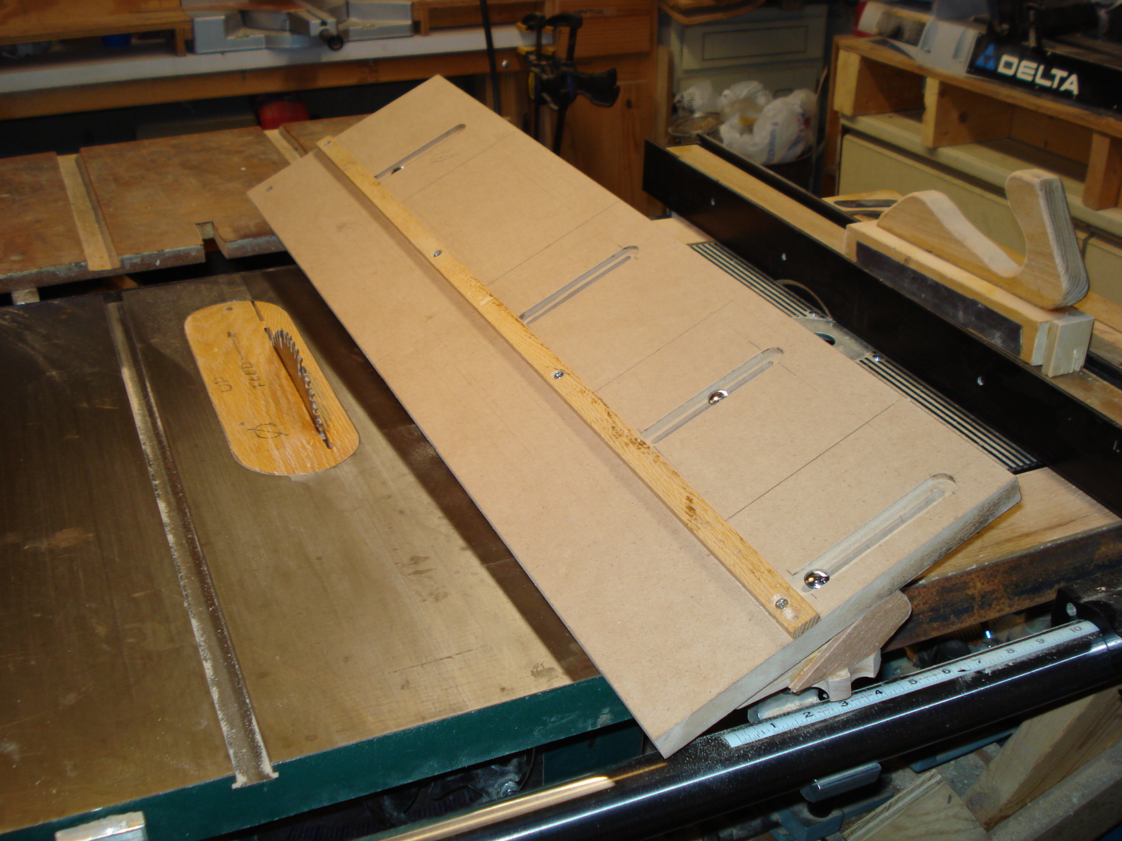

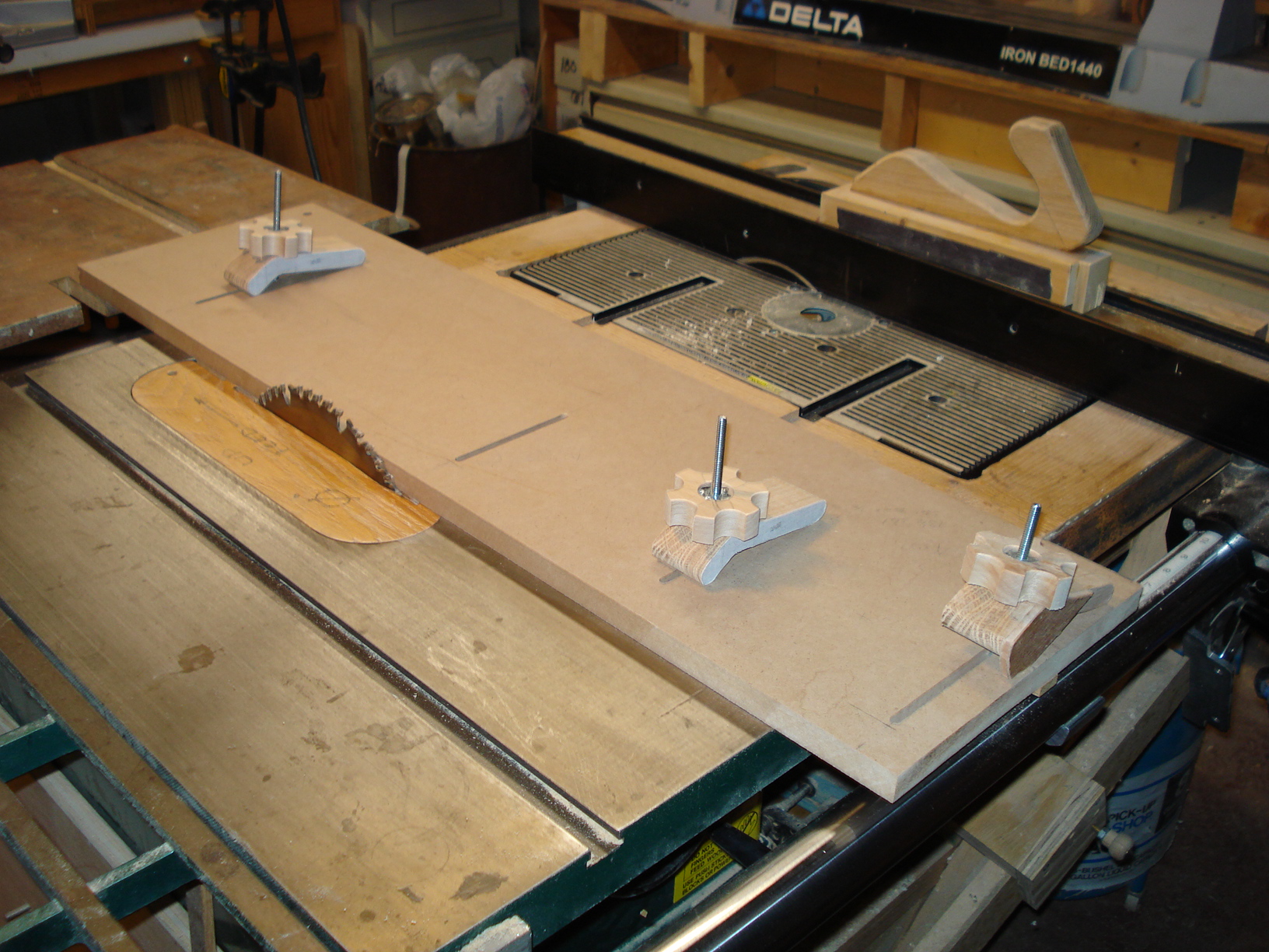

August 27, 201610 yr comment_69893 I made some flower pots that when turned upside down would resemble a short lighthouse. I did it using a tapering jig. Lay the board on the jig, make one 12° cut lengthwise flip the board end for end and make the cut on the other long edge. Report

August 28, 201610 yr comment_70320 I was thinking about my tapering jig when I answered your question, so it may not work with your jig. I would layout the taper on both edges of the board-wide at one end and the narrow at the other. Then mount the board on the jig with the taper aligned with the straight edge of the jig (blade tilted) and make the cut. Then rotate the board- same side up- and align the other taper layout along the jig straight edge and make the second cut. Hope this gives you some ideas. Report
