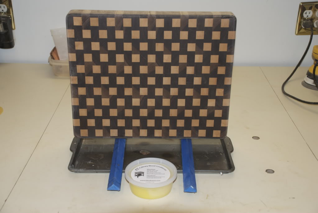

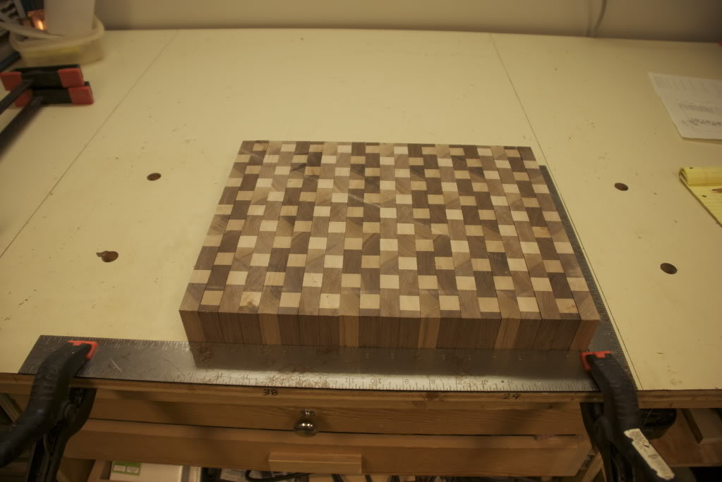

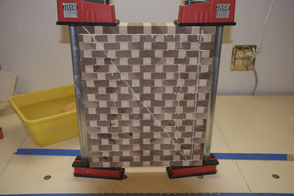

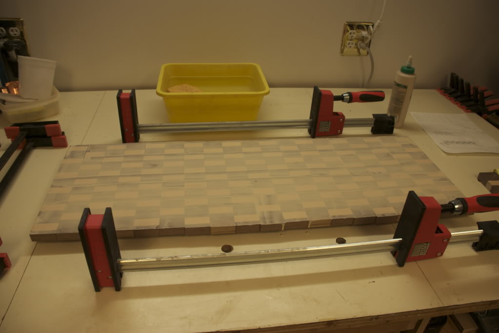

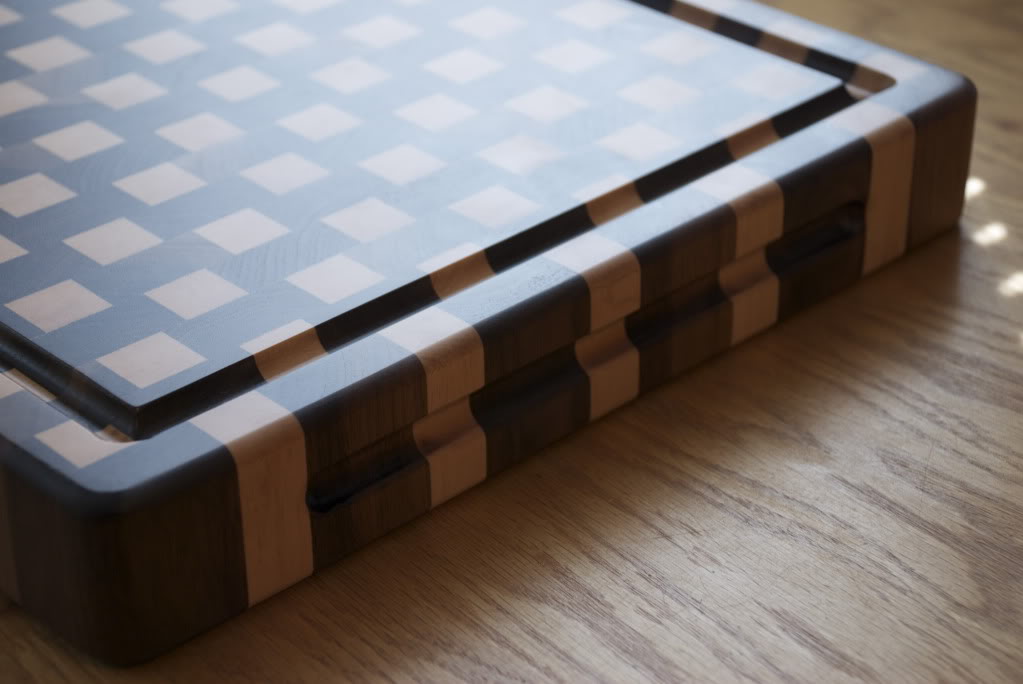

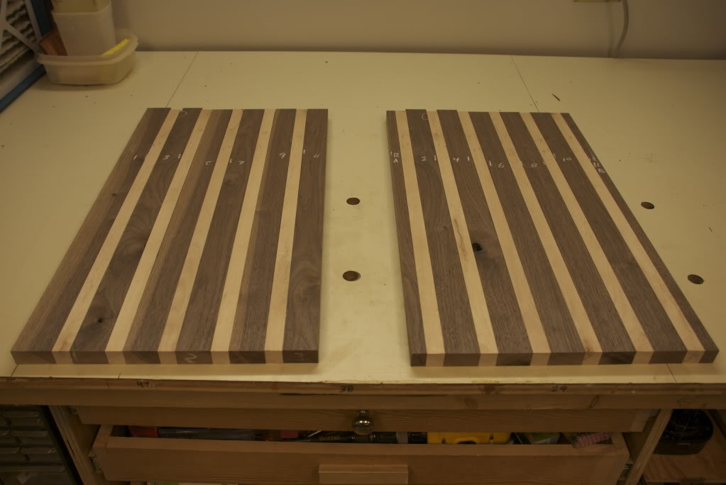

How to make a cutting board.  Finished size will be 13"x15"x1-15/16".
1. Start with rough lumber, 1”x8”x6 foot walnut, 1”x4”x6 foot maple
2. Cut to 24” long pieces
3. Plane to consistent thickness, about 7/8” in this case
4. Rip to desired widths, 1-1/2” for walnut, 3/4" for maple, plus two walnut pieces at 3/8”
5. Arrange pieces in desired pattern
6. Glue up and wait a day
7. Plane flat, to about 3/4” thick
8. Cross cut to desired board thickness, in this case 1-15/16” (to minimize waste)
9. Arrange in pleasing pattern
10. Glue up and wait a day
11. Wipe excess glue off with warm water and sponge
12. Sand, sand, sand, from 50 grit up to 120 grit
13. Rout out side grooves for picking and holding
14. Sand off corners
15. Rout drainage groove on one side
16. More sanding
17. Rout edges with roundover bit
18. Apply brand
19. More sanding up to 220 grit
20. Apply finish, 2 coats of Butcher Block oil, let each coat dry for a day, sand 220 grit before applying next coat.
21. Sand 220 grit one more time, apply beeswax/mineral oil finish
22. Done, ready to use after curing for 3 days
Use and enjoy, reapply mineral oil or beeswax/mineral oil finish as needed (when water does not bead, time to reapply finish).

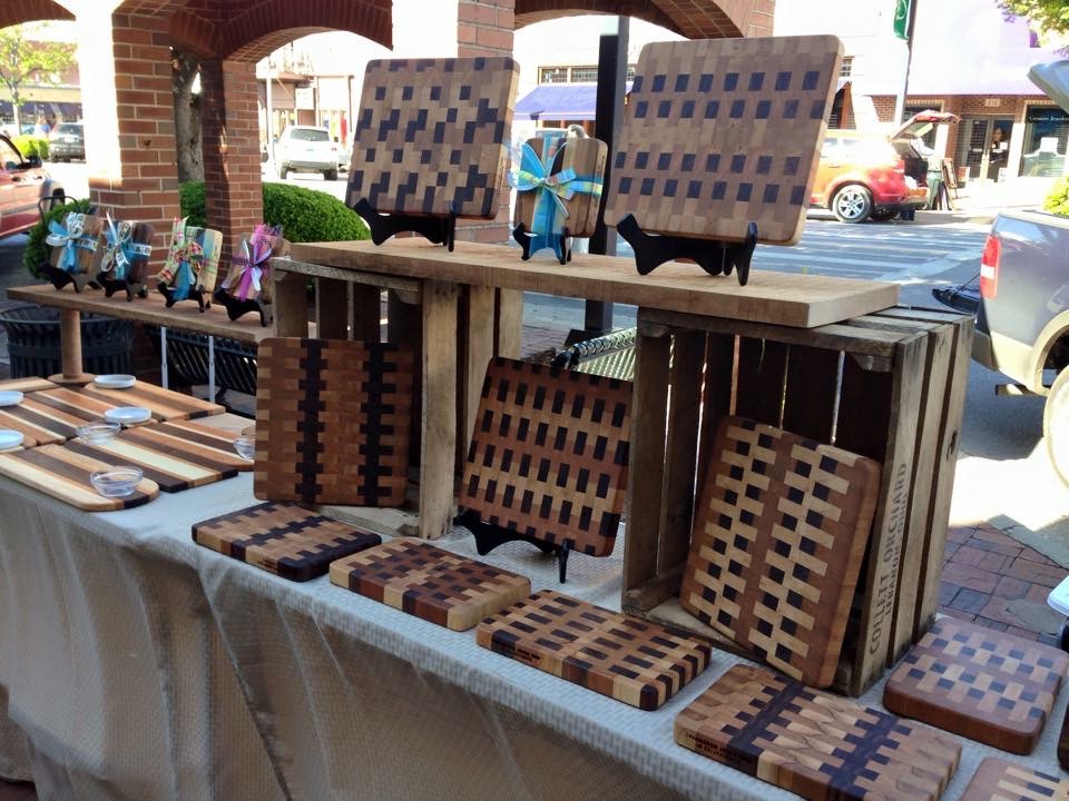

Here are some Breadboards and Cheese boards I make.
And a few of the cutting boards.

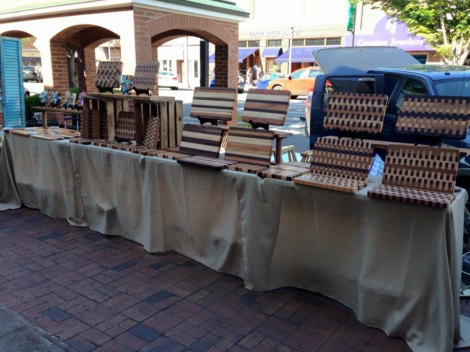

This is our display at First Friday we do here in Florence, Al. I will have one to do this coming Friday.
I make them in several sizes.
