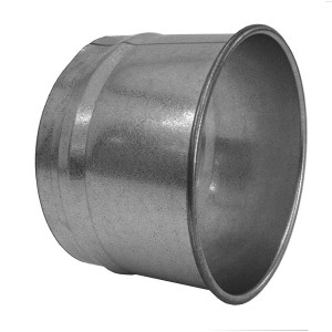

I got nordfab flanges meant for flex hose. I got the hose.
The don't want to work and play well together
Any ideas for mounting tough flex hose on the flanges?
Which nordfab part do you have?
