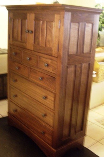

August 20, 201610 yr comment_68473 Go for it! Your cabinet will be an heirloom. I used walnut skinned ply on the top of this highboy. You are correct, it is not inexpensive. Apologies for the poor picture quality. Report
