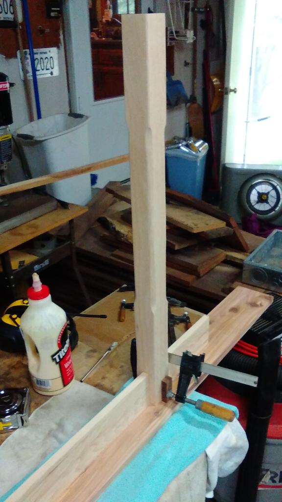

Using reclaimed lumber, I took a cedar plank and milled it down for the top.  Cut a dado into the bottom and inserted a 1/2" thick piece of oak for the apron. Then started on legs.

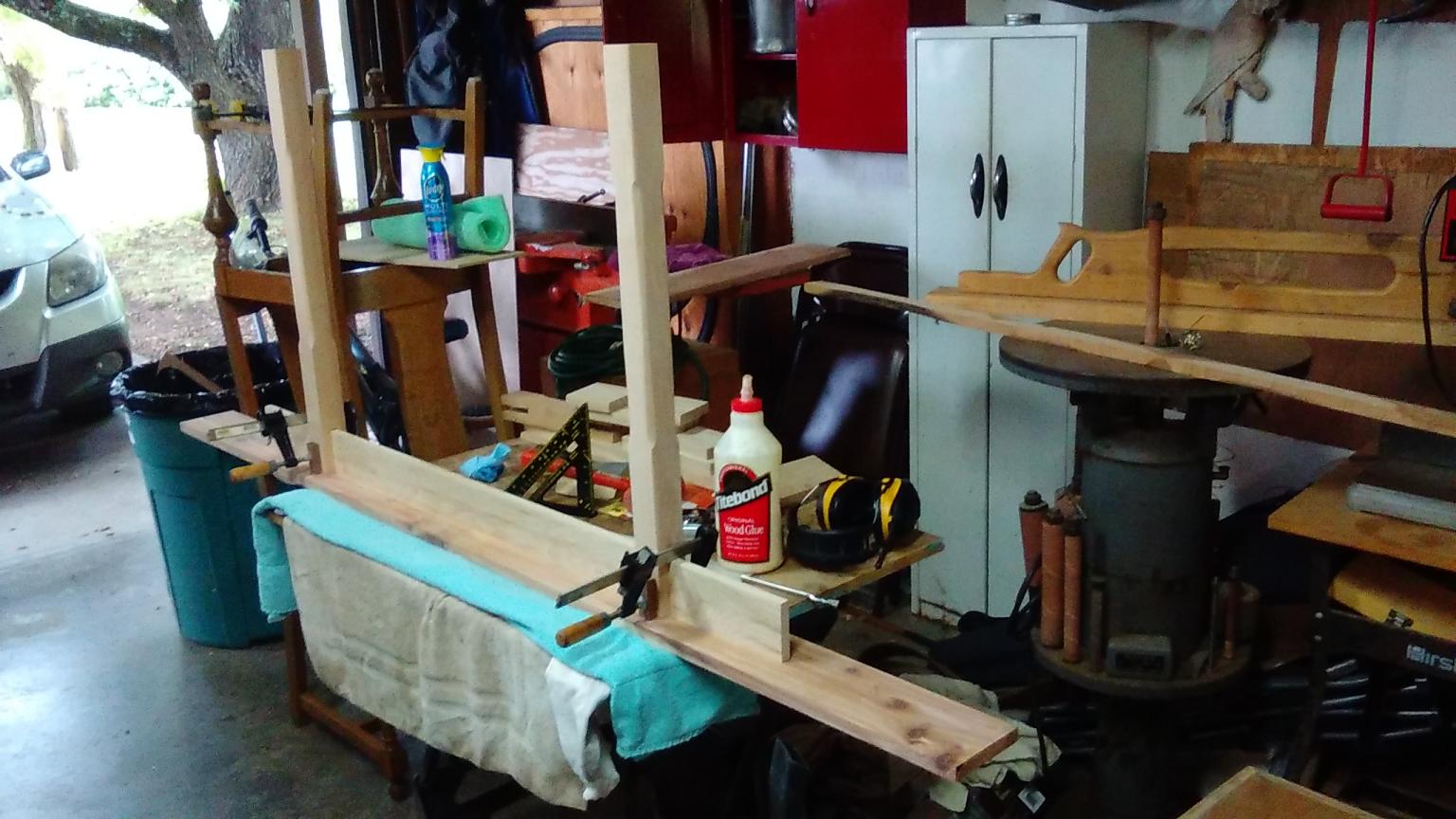

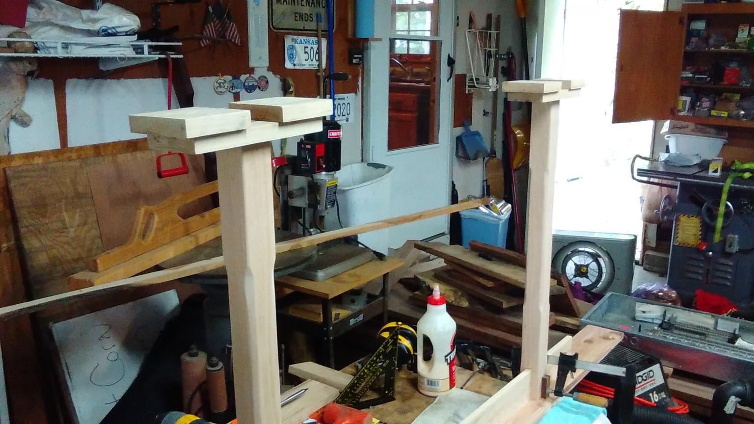

Using 2x2 stair risers that I got a smoking deal on (10 bundles of 12), I milled the edges on the shaper and cut a mortise for the apron to slide into.  Glued up and squared up the assembly in preparation for feet.

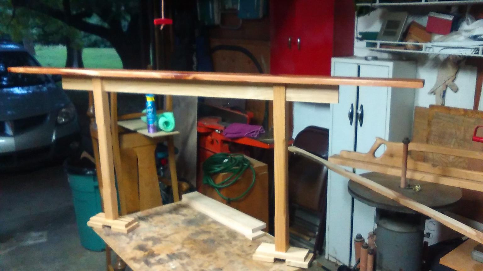

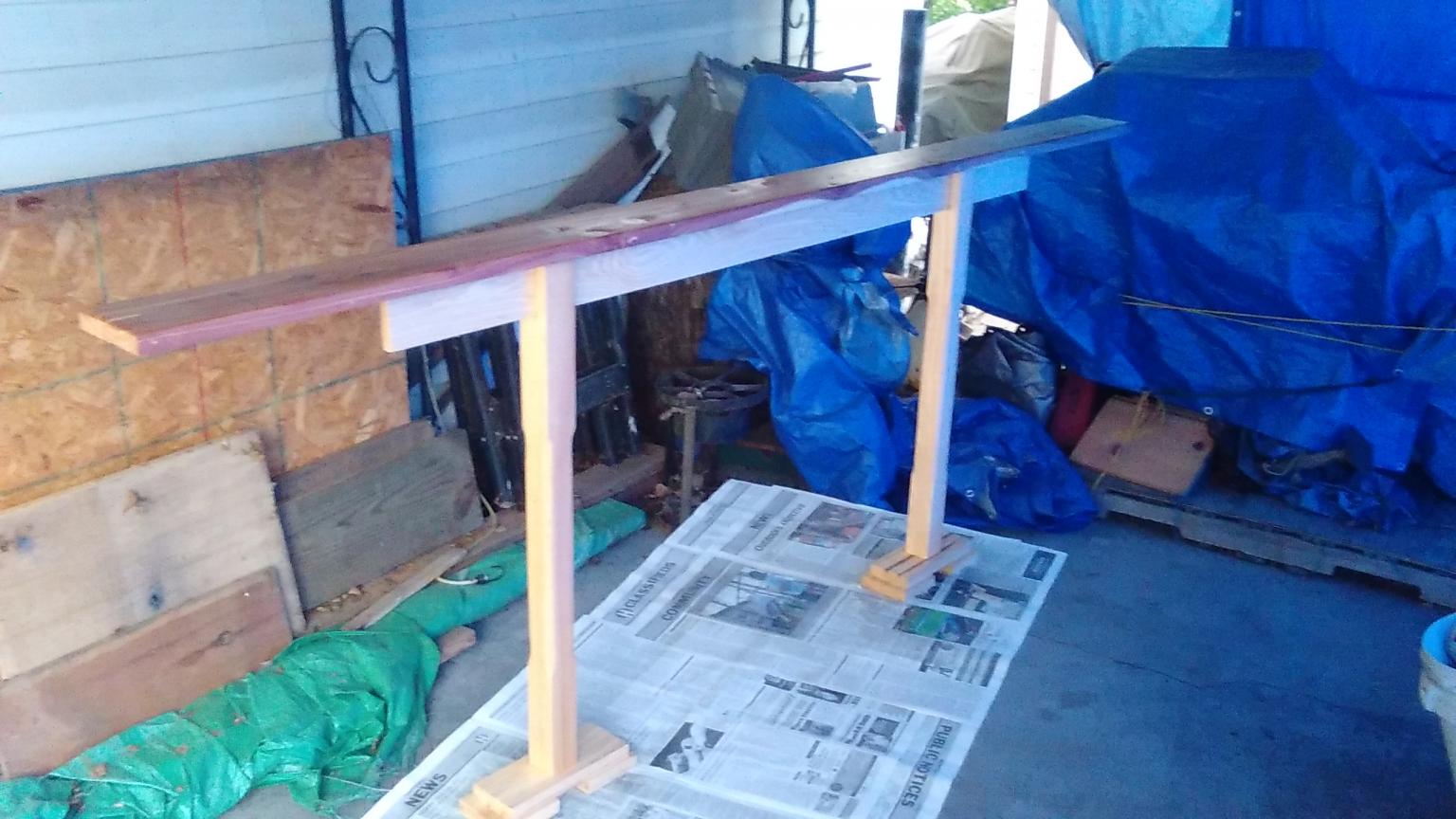

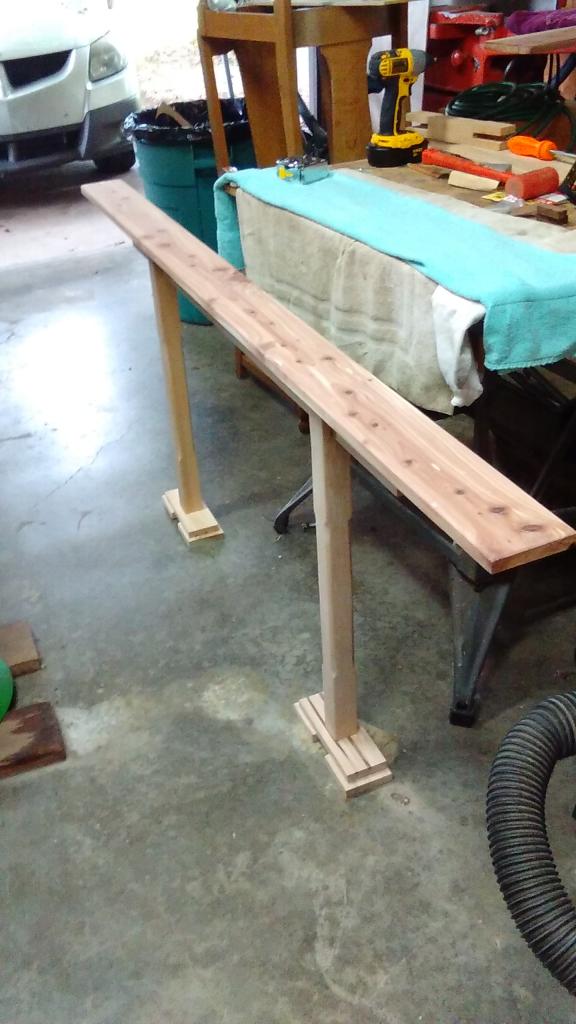

My original plan for the feet didn't meet the test for minimum clearance (too wide) so I rotated the orientation and added the two pads to each base for stability.  Honestly it was the iffyest portion of the plan, but...
the stability was excellent.  No wobble, and all the joinery locked up solidly.  A minimalist approach that matched my mental expectations.

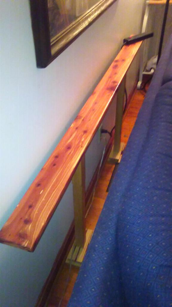

Three coats of spray laquer, with a light sanding between each to bring out the grain and color.

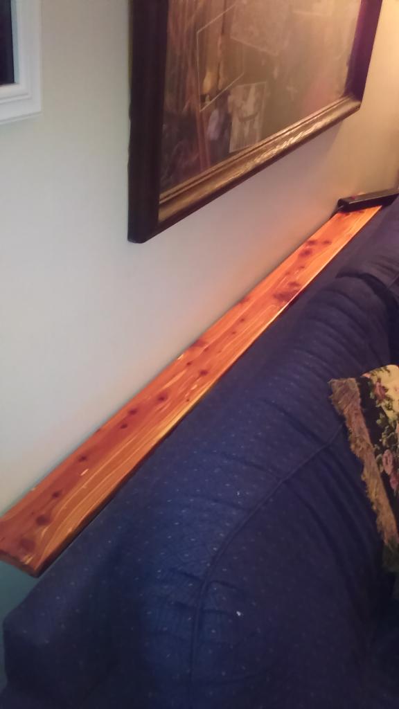

And installed.  29 inches from floor to top, 72 inches long, 4.5 inches wide.  The wife is happy, I got to make some sawdust and a design from my mind turned into a finished piece using material at hand.  I really like the mixed media of the cedar contrasting with the white oak.
